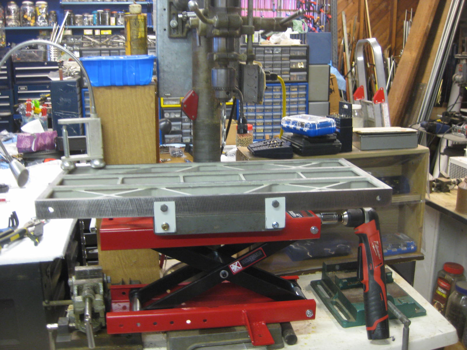

Basically I'm a lazy man. My drill press is a manual lift. looked at a number of options but I'm at a stage in my life that I don't build anything that I can buy for around $100. This motorcycle lift fit the bill and I only added a battery drill motor and a socket to power it.
Attachment 50332
