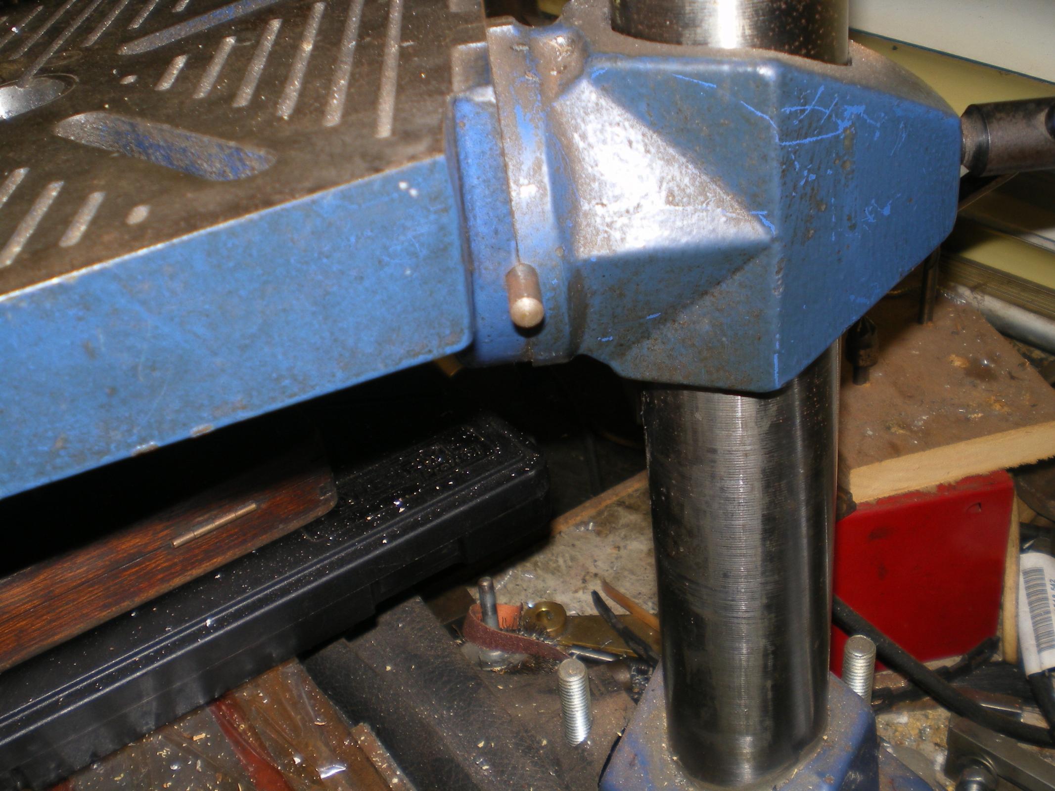

Easy way to square a drillpress table with high precision with just 1 simple DIY tool. In fact the method goes beyond the precision of this particular drillpress, but it does ensure that it's as precise as it can be.
https://www.youtube.com/watch?v=PVUrb1VzfBg
MATERIALS / TOOLS
- Stiff metal rod bent to "Z" or "L" shape
- Feeler gauges (or for less precision, anything that will tell you the both sides of the table are equal distance from the rod)

You demonstrate how to check it, but you do not provide any information on what to do if it is not level and perpendicular to the center of the chuck. How do you adjust it precisely and make it stay in alignment without slowly misaligning??
