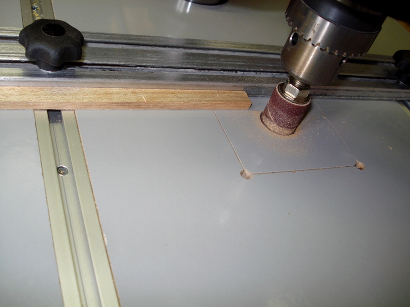

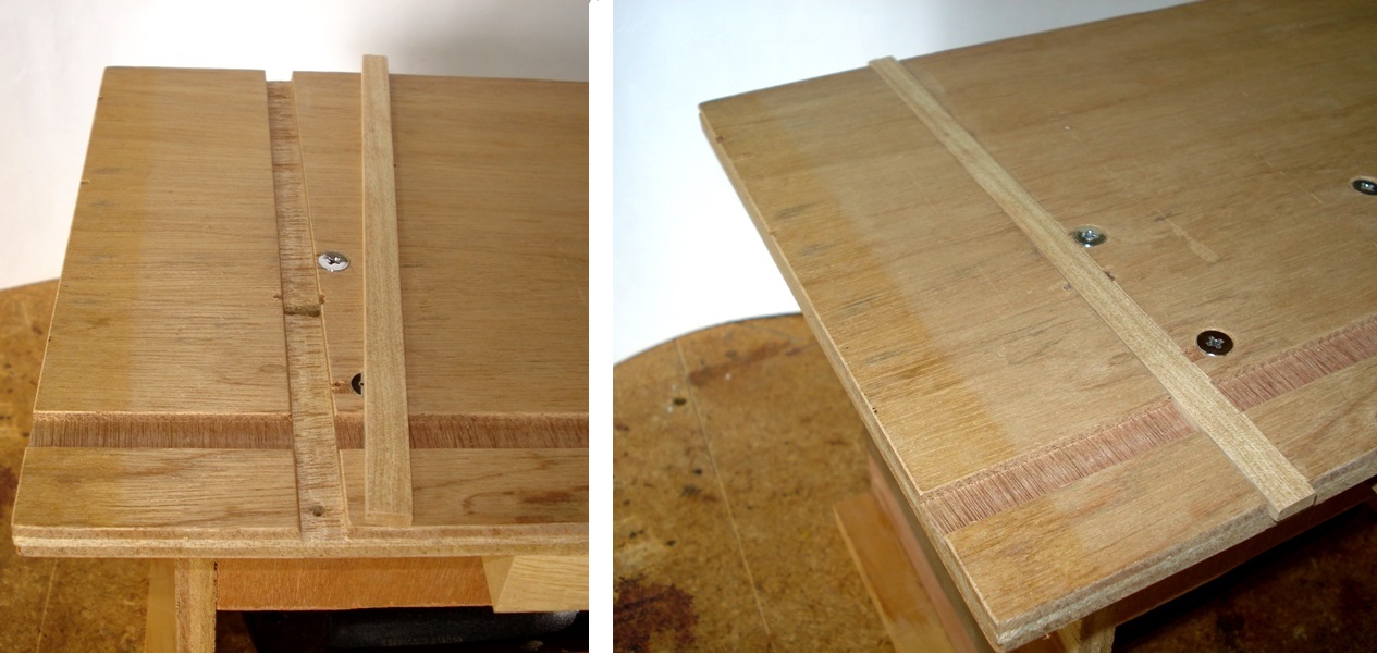

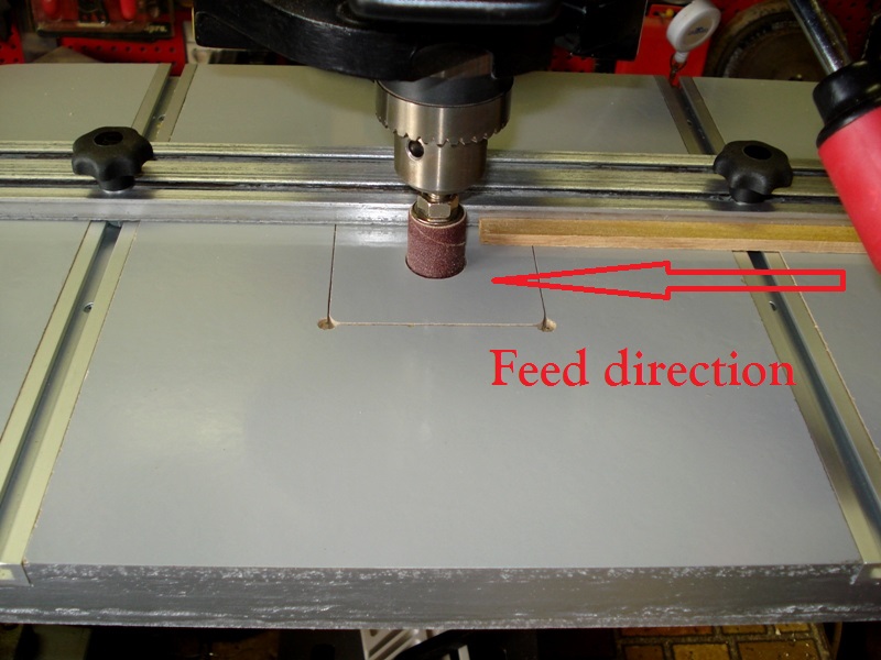

Sometimes you need to make small pieces with a uniform width or thickness. With a drum sander and a fence you can make a thickness sander at the drill press.
Note the feeding direction of the workpiece.
Attachment 14250
Attachment 14251
Attachment 14252
