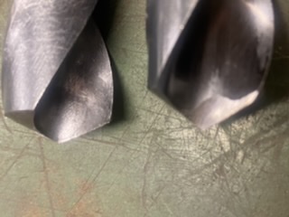

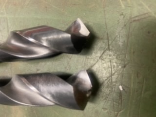

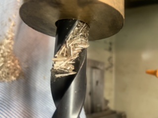

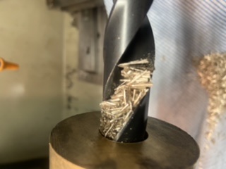

    When drilling brass there are several things to be aware of when using a standard 118 degree twist drill. Cutting speed 90-210 m/min, Coolant, drilling to required diameter in one pass (not stepping drill sizes) But most important is drill point preparation.
    A standard drill tends to snatch at the brass and drag itself into the workpiece.

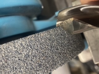

    To prevent this the cutting edge can easily be modified with either a oil stone or my preferred way is a offhand grinder.
    The photos below show the drill point for brass.

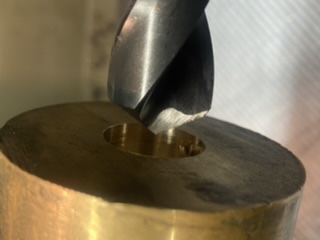

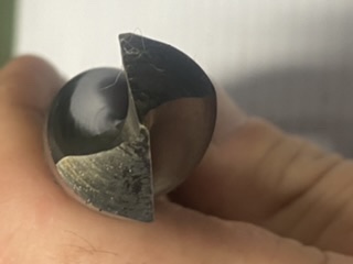

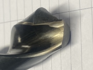

    Both drills are 20mm diameter. The lower drill is a standard drill and the one above has been modified for brass.
    Right drill has negative rake for brass.
    Centre drilled and drilled at 20mm so the drill has less chance of snatching. If the hole was to be 30mm diameter a 30mm drill would have been used after centre drilling.

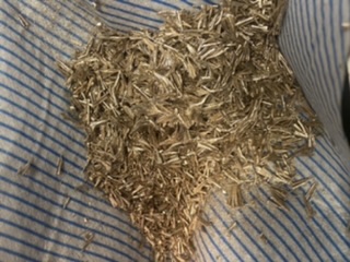

    Drill chips are removed like small needles.
    Brass swarf collected on a rag to aid clean up.

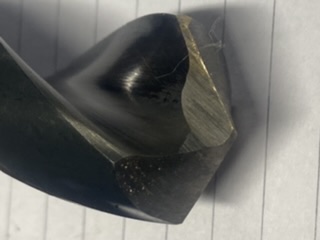

    I'd like to see some closeups of the modified bit.

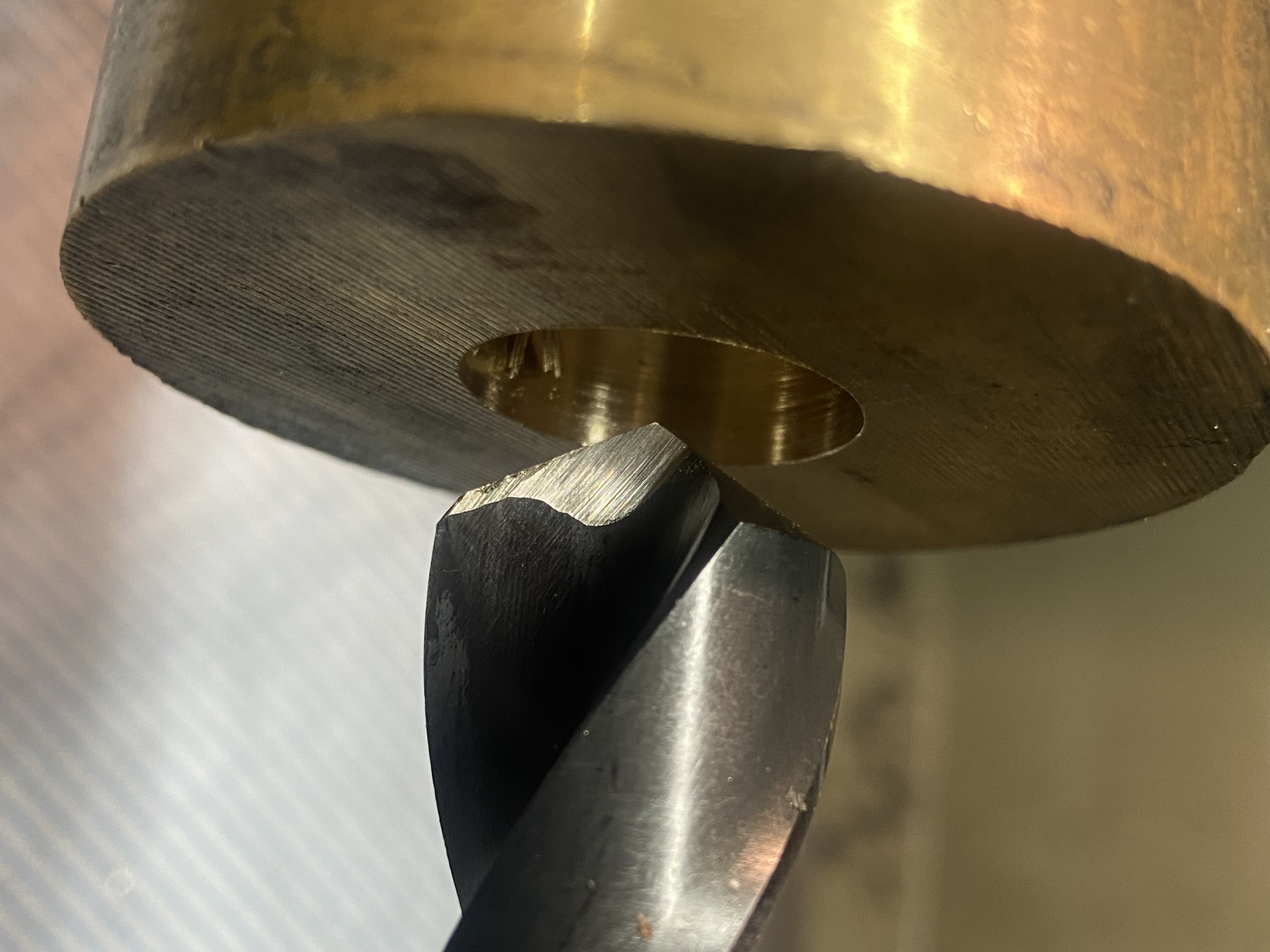

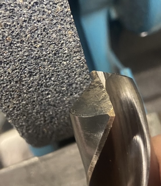

    Hi Ralph
    please find photos of modified drill bit for brass.
    Drilling Brass for beginners.-febeee5c-ab3d-4f7e-b382-870ecde5557d.jpegDrilling Brass for beginners.-2d03a771-023c-4420-a155-f8fe1bbb5d86.jpegDrilling Brass for beginners.-4ad5aaac-f396-4c05-a8d8-502511239da5.jpeg
    This is how I grind them against the side of the wheel. Very light grind in one pass on both cutting edges

    The first time I drilled brass I was in for a BIG surprise. Brass shot out like a machine gun. Then I read to try a slightly dull drill. I ran a sharpening stone across the cutting edge 2 strokes and no more problems. Works great.

    It's not exactly dulling the drill, but removing very edge of the rake, the helix that extracts chips, essentially parallel to the drill axis. It keeps the bit from 'accelerating' into those type materials. Brass and bronze top that list, certain grades of copper.
    It's a lot like the reaction hand drilling sheet metal with a twist bit, as it advances faster than cutting, more or less screwing into the material. The newer remedy is the Unibit, step drill, 'peeler bit' that moves material instead from the side.
    An effective method is a whetstone, drawn away from the cutting edge, not as a file going in, which can round off the cutting edge. As mdhatter3 mentions, a couple strokes is all it takes.
