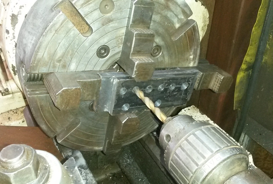

With my mill down I needed to drill the last hole in a fixture I am making Since the hole was already 2/3rds completed I decided to just chuck the parts up in my lathe using the 4 jaw

I have a 3/4" floor standing drill press 1 1/2 Hp with an 18x18" table 4" column. Perfectly fine for drilling most things but I never trust those baby drill presses for making fixtures. If I had either the Cleereman layout drill or the Lealand Gifford 6 head drill under power I would use 1 of them, but these small floor standing drills of mine just don't have the rigidity I feel that I need Even using a lathe for this type of work is hardly ideal
I bought a little vise for the cross slide on my lathe. You put your part in the vise then put your spinny tool in the chuck of the lathe. I haven't used it yet. I don't know why I bought it. Honestly, why would I ever need this?
If your vice has vertical jaws and will securely and squarely hold the part then there are dozens of reasons why you may want it in the future they just haven't made themselves known to you yet.
I have used tool holders on my tool post as a vice many times this also affords me a limited amount of vertical adjustment as well or clamped a larger part to the tool post itself with a good "C clamp
they are great for finishing out an 80% lower if you don't have a mill or other suitable ridged machine to spin the spinny tool as you called it
It's got up and down. The cross slide on my lathe does the side to side. The compound could do angles or something I don't know. It's actually kinda nice, it has a self centering vise. I thought that was a neat little feature.
