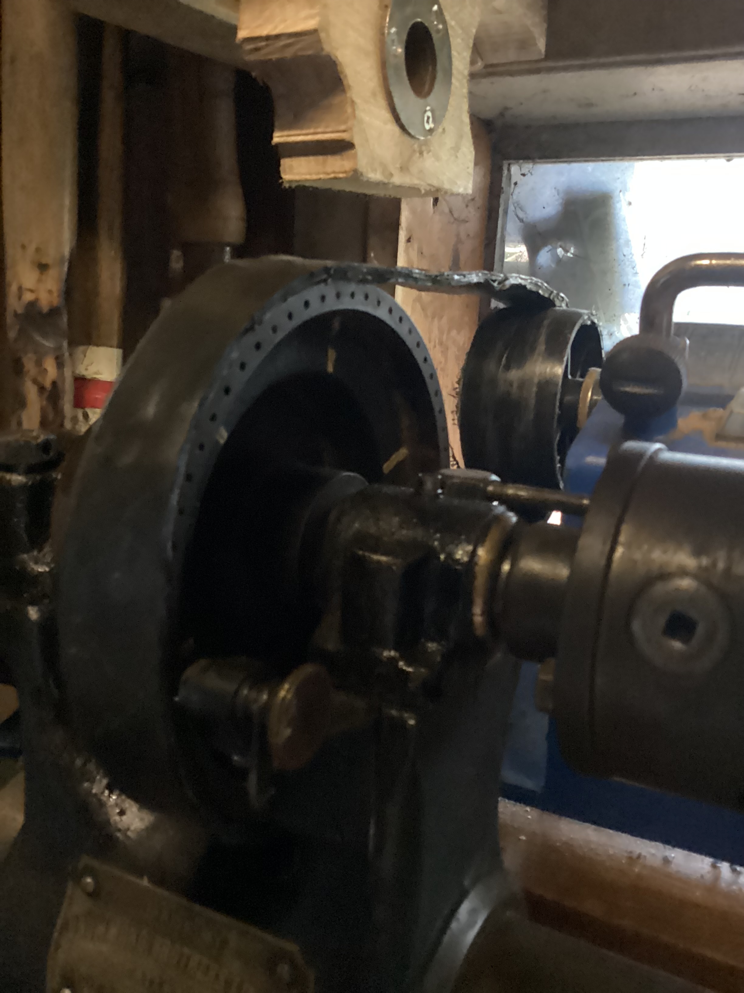

Drive belt for vintage lathe
Attachment 48522
Hope you can make this out, it’s very dark even with ordinary lighting.
The lathe is a Drummond 3&1/2” round bed lathe, acquired reasonably cheaply and I just want to check how it runs, without machining anything, before going further with accessories.
The belt is made up of strips of inner tube, 4 layers, glued with impact adhesive and then trimmed. The first, inside layer is one piece, the others are staggered. At present, the drive is from a Tormek sharpening machine, which runs nice and slowly, although probably without enough torque to cut anything.
In the top left you can see a bracket for a line shaft.
