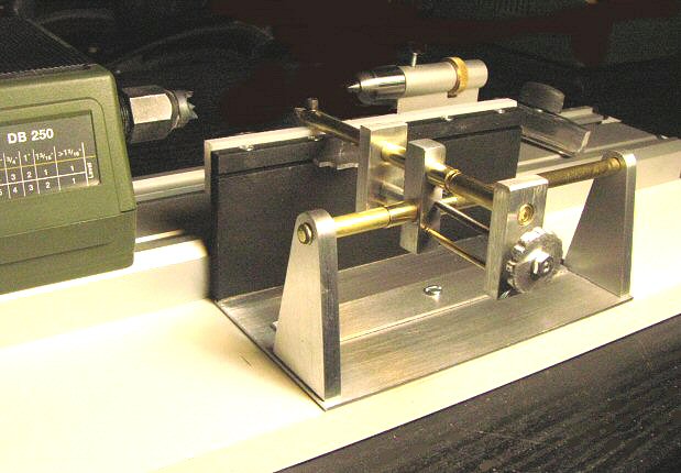

    I built this duplicator accessory for the Proxxon DB250 wood lathe. It is essentially a half-scale version.

    Looks good, hope it serves you well. May i ask what you used for a cutter? Thanks ia advance.
    Eric
    Sep 2017
    5
    Thanked 8 Times in 3 Posts
    Guy Gadois's Tools
    Thank you, Eric
    When I sold my Jet mini-lathe it had the Penn State Universal Duplicator. I had forgotten I had an extra cutter for that duplicator and it fit my tool quite well. The cutter is available from Penn State.

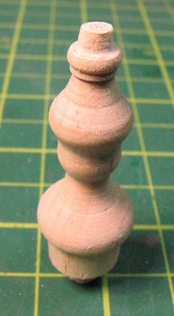

    Thanks, how smooth is the finish from the cutter? Thanks

    Because the cutter has to be sharp to follow fine detail, the finish will occasionally require a little sanding. If the template does not have fine detail, the cutter could be shaped with a small radius on the end.
    Attached is a typical piece showing a very light sanding. It would require more finishing to be usable.Duplicator for Wood Lathe-dup-piece.jpg
