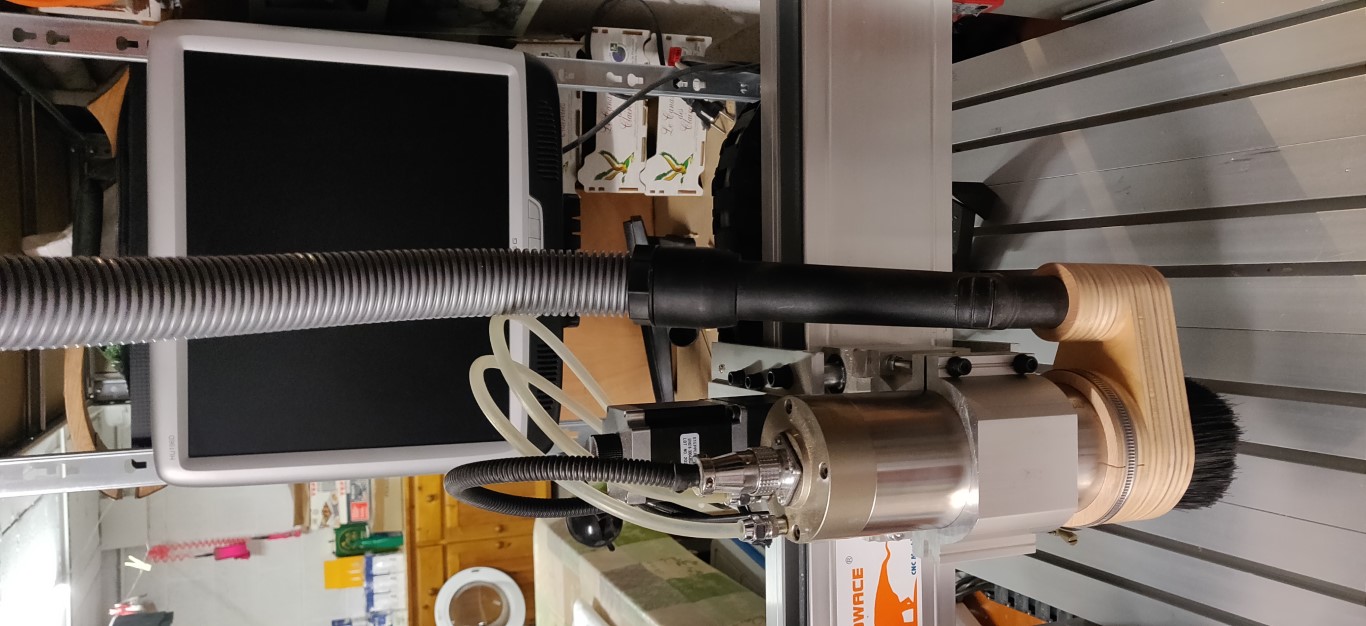

    But for some applications, like vacuuming the debris from a high speed CNC spindle, of for lifting the metal chips to clean up a conventional mill, this is not really relevant and you need more suction power and so more depression.
    For that application I generally use a small shop vacuum, but it always gets on my way and so I decided to install a vacuuming network at the ceiling of my basement shop, and control the shop vacuum with a remote command.

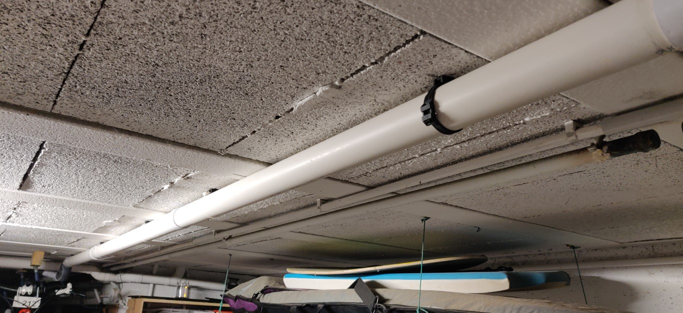

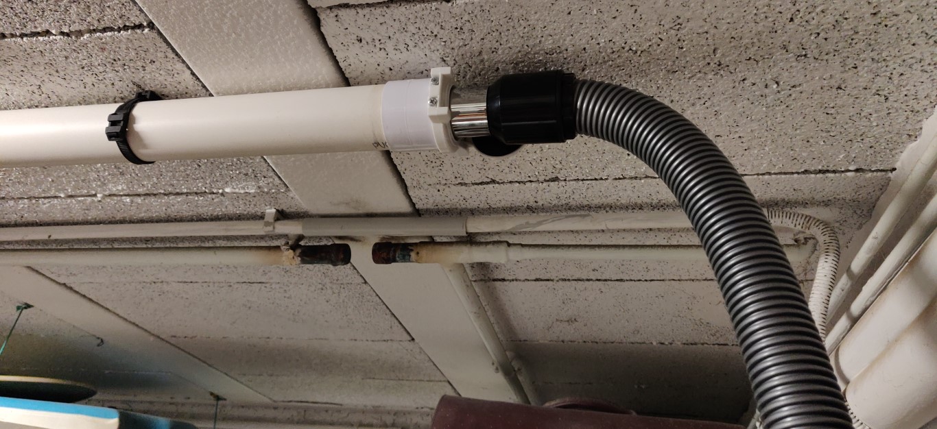

    Here are some photos of my setup :
    End connection to the CNC dust shoe (see my other post about this one)
    Connection of the CNC hose to the port just above mounted on the ceiling :

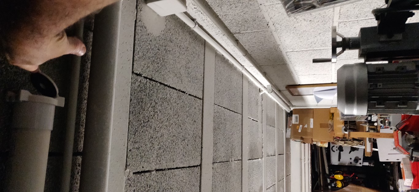

    View of the PVC hose network, heading towards the shop door, where the remotely activated shop vac is installed.

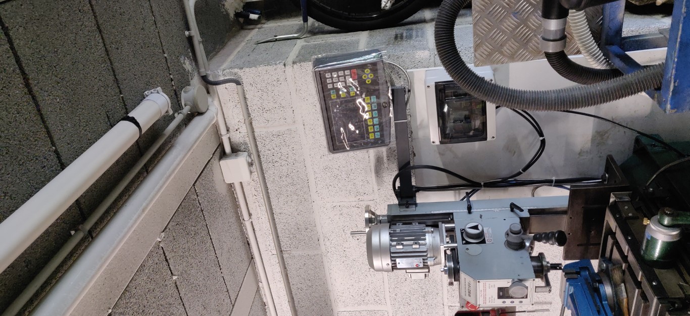

    Here is the port above the conventional mill, closed when not used.
    I use it on the mill mainly to cleanup metal chips, but as I don't want metal chips in my network, or in my central vac, I have a small cyclone next to the mill to collect these metal debris.

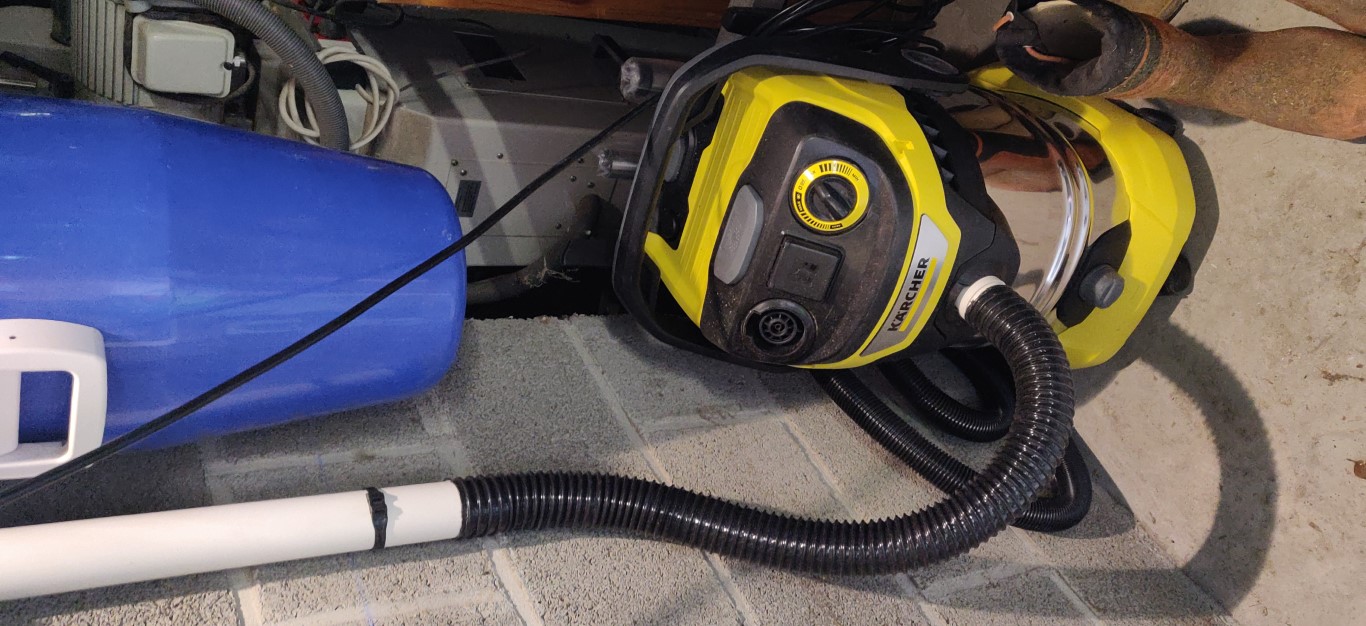

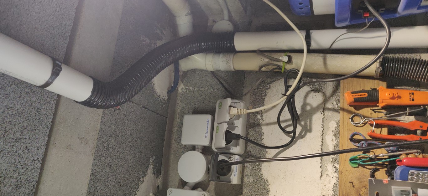

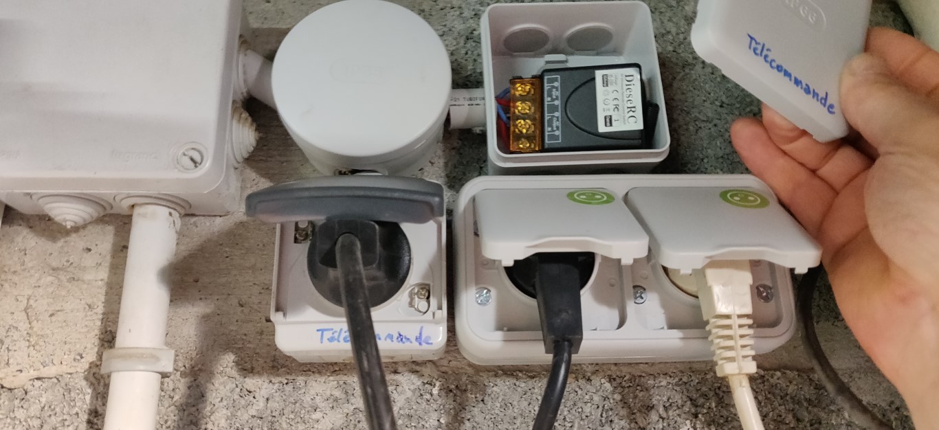

    And here is where the shop vac is installed.
    You can see on the wall this connection box, and sockets marked "TÚlÚcommande", meaning "remote control".
    The box is were is installed the remote controlled relay that is used as a switch to power the socket where the shop vac is plugged in.

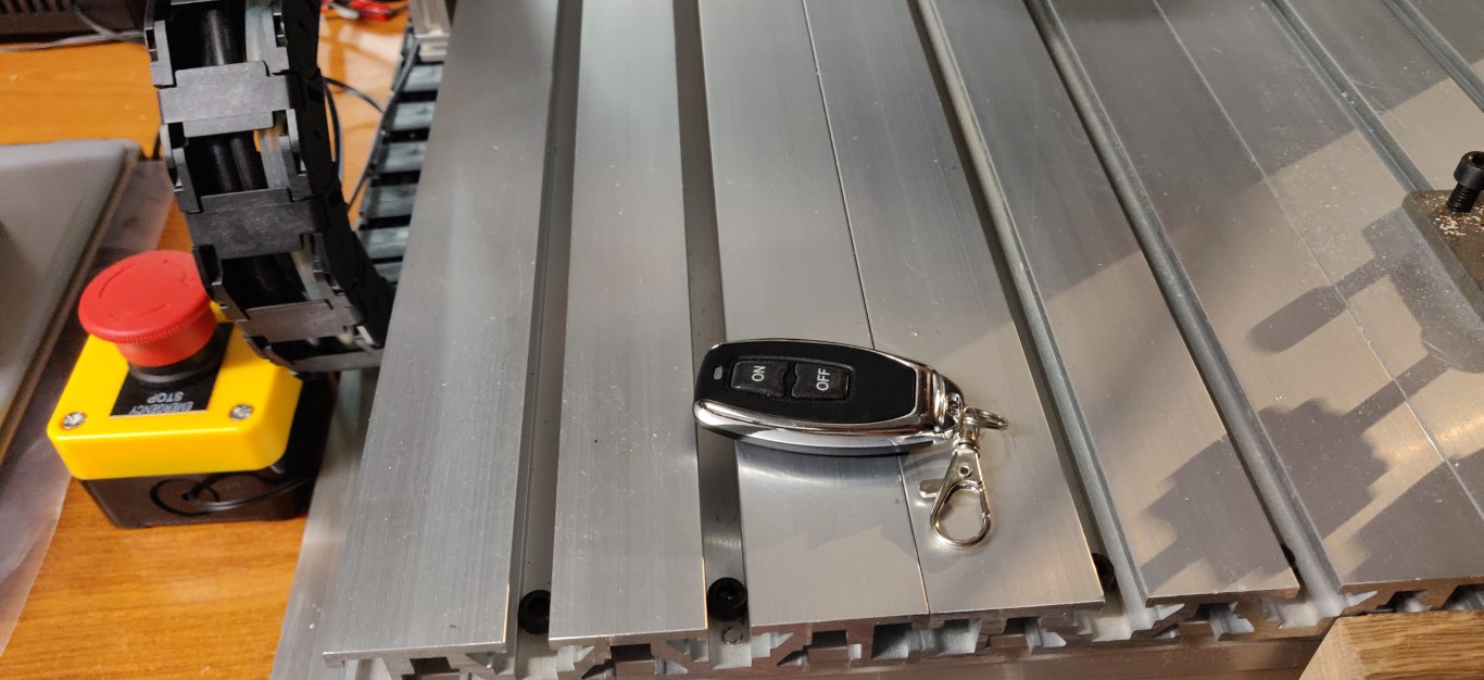

    Here is the remote control box open.
    And here is the remote control itself, it's radio activated and can reach up to 100 meters away from the relay, it works like a charm.
