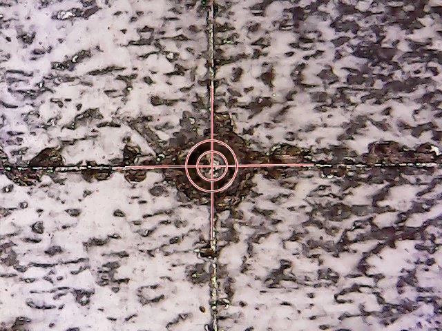

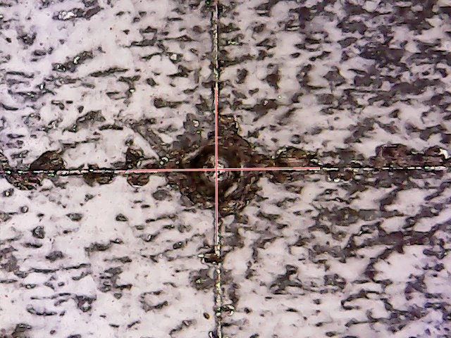

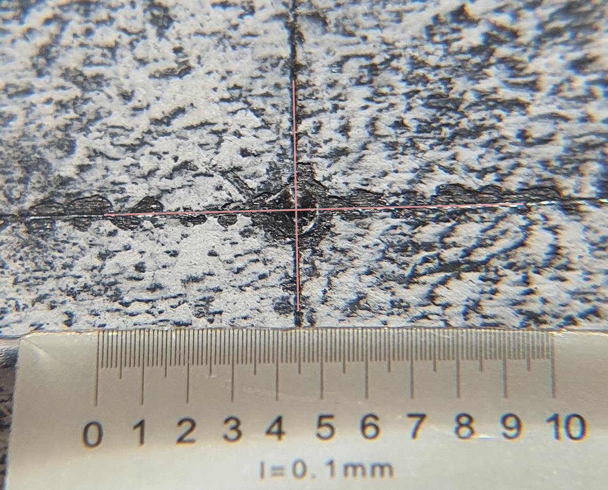

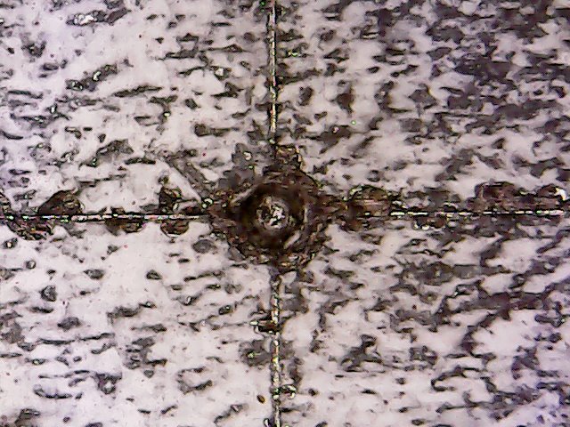

The punch marl looks slightly to the right not centered.
Ralph
Ralph
It looks like it is off center and also lower, due to the tilt of the camera (perspective illusion), but it is perfectly centered (is the best my old hands can do). Thanks Ralphxyz!

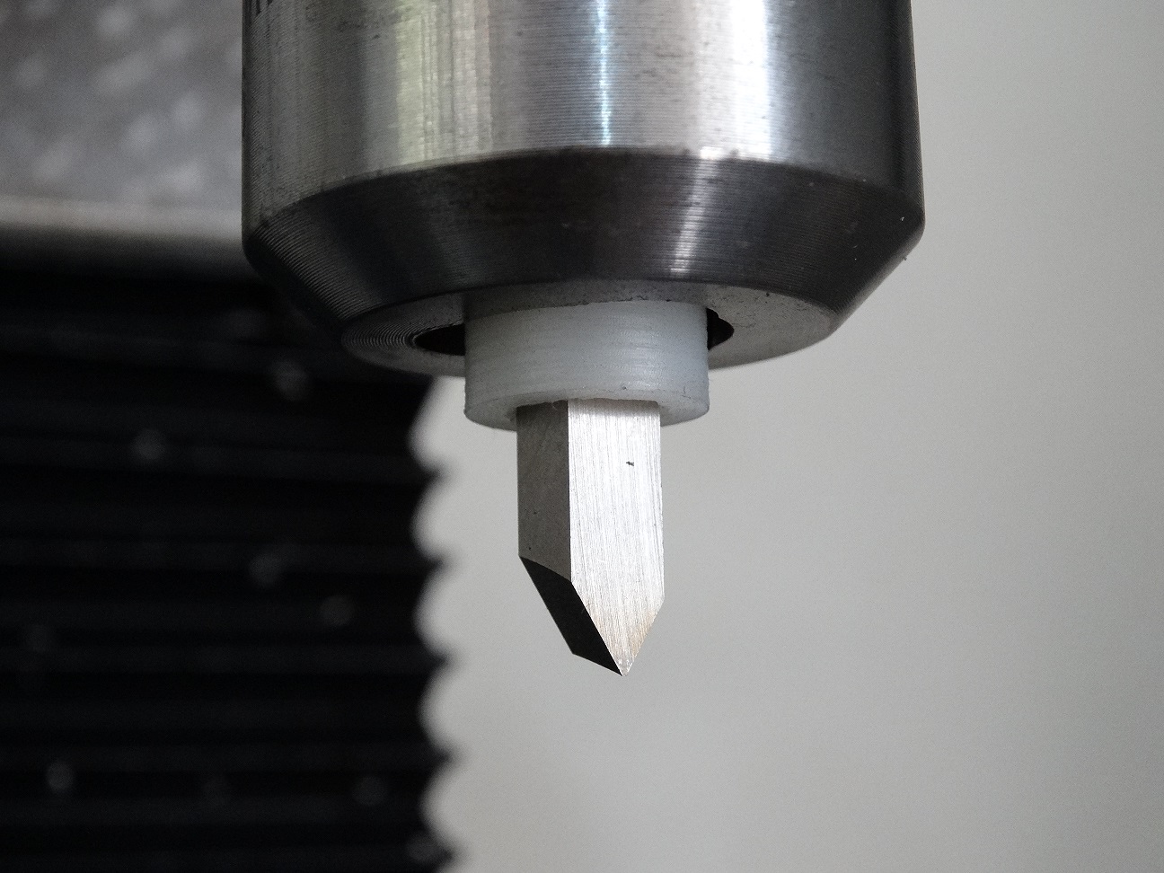

Attachment 37394
It was the orientation lines on the center punch that I wondered how you made.
Of course I want to know how you inscribed the scale on your Marking Gauge Caliper.
Ralph
I made it on the milling machine, with the help of a dividing head (this head I have shown here too). I attached the tool (photo) to the mandrel and moved the X axis by 6.0mm. After the process, I painted with black automotive paint and sanded (mesh 220) on the lathe. It was very easy and fast! But as I said, you can use other methods if you don't have a splitter or a milling machine...
Attachment 37395
