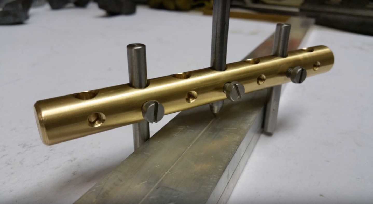

Easy project: Center Finder Tool
I made this little tool a few years ago and still use it a lot in my shop. It's easy to make and (for me) very useful.
Attachment 32694
Here is the making of video:
https://youtu.be/OLxsWcwSLU8
Suggestions for DIY:
If you want to make it easier: Use square stock instead of the round Brass.
If you want to make it more durable: Use a carbide Scriber.
If you want to improve it: Make extra rings on the pins to keep it level
If you want to make a better version: Make a double parallel that it connected
