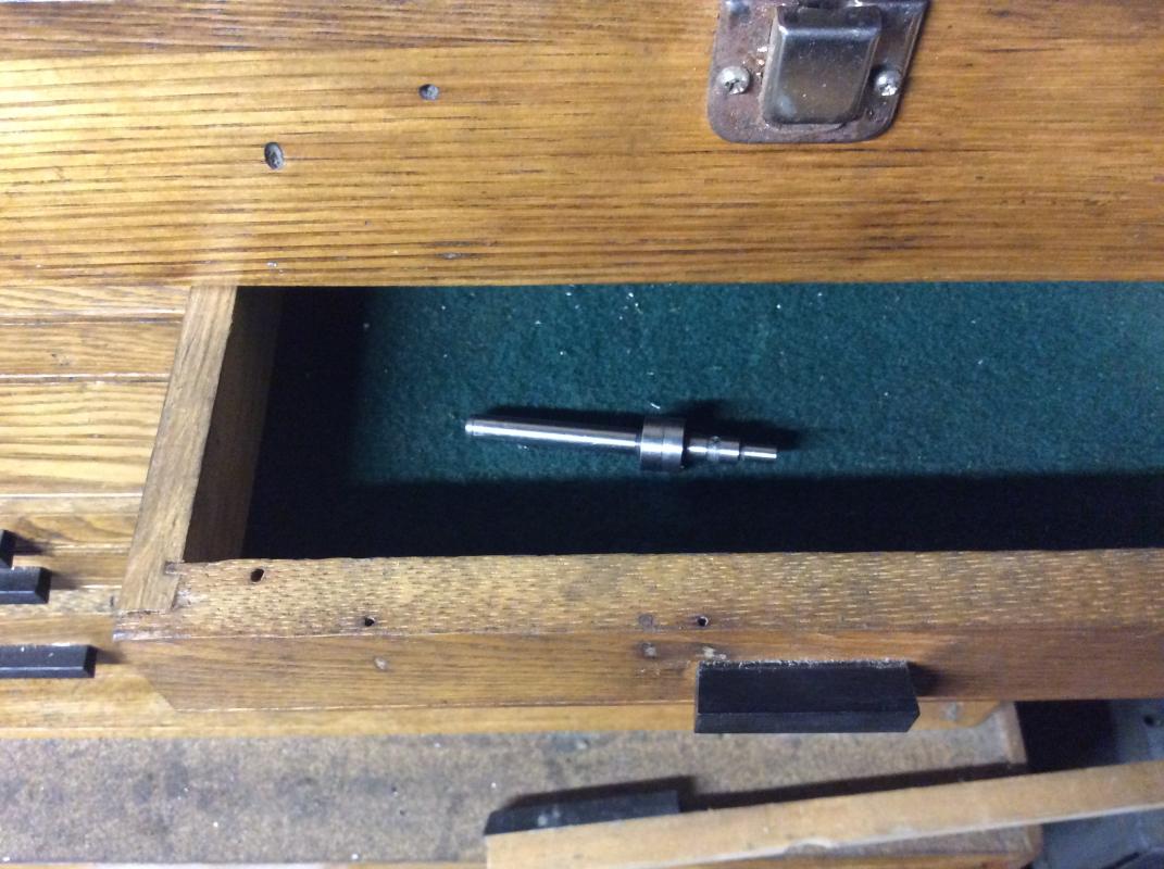

I would have preferred that but I used what I had and it seems to harden enough.
I used one of my little ER-11 spindles to grind it - the big Unimat pulley makes it hard to do anything between centers.
I'm a big fan of 0-1, unbelievably fine material. Sure some are more modern, but never been a substitute for Oil hardening grades. As far as a spring goes, a couple weeks back needing one for my edgefinder [and inappropriate to spin one on shop time] I had one scrounged from a oil seal.

Attachment 25552

Edge Finders have always fascinated me. Ive been a machinist / tool & die maker since the early 70's and even in retirement use one frequently in my home shop on the ol' DoAll mill. But, i never understood how they work. What is it that makes them go off-center so accurately?
And, who was the lucky guy that first encountered the principle?
