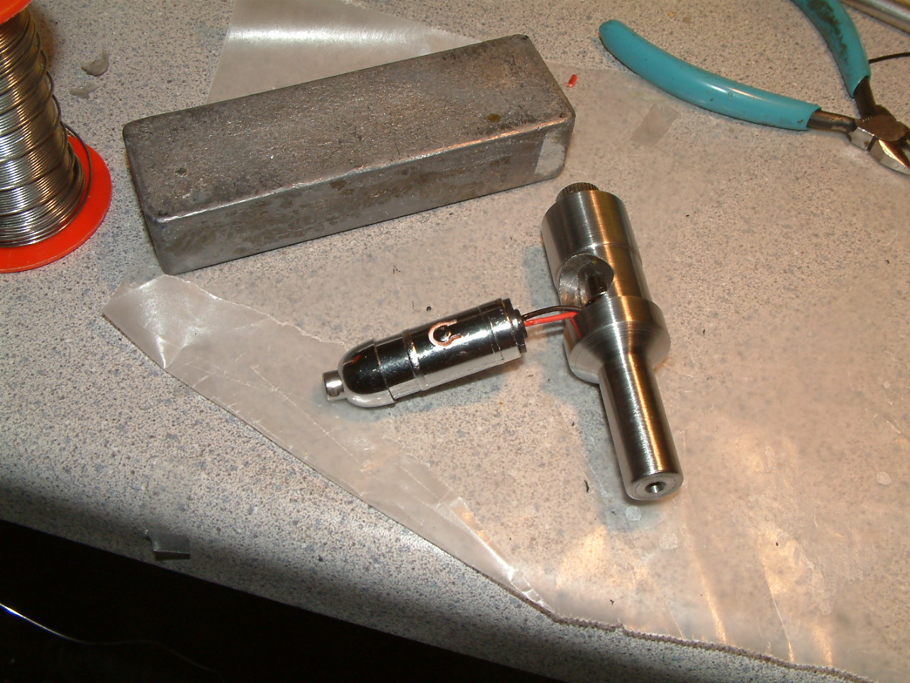

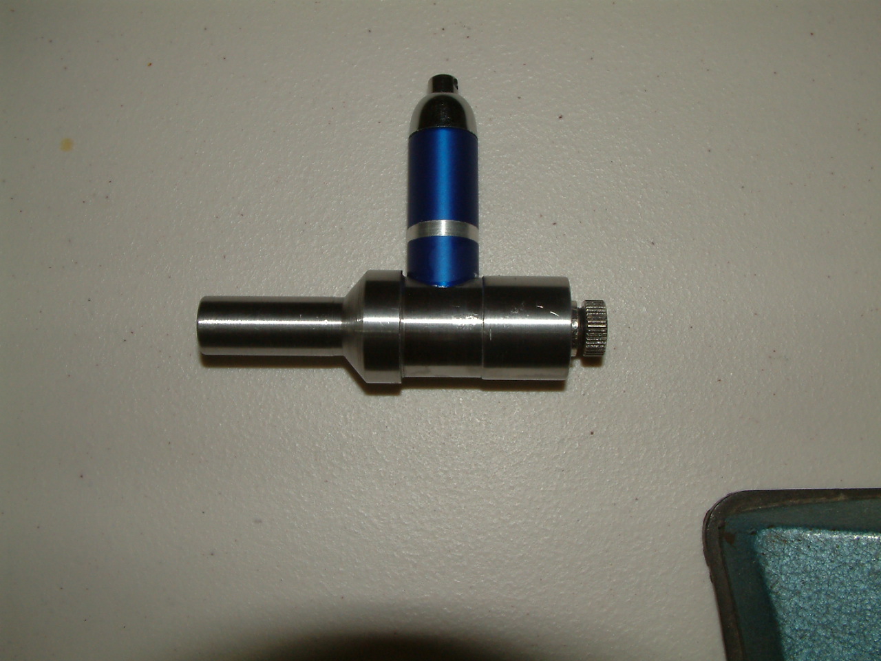

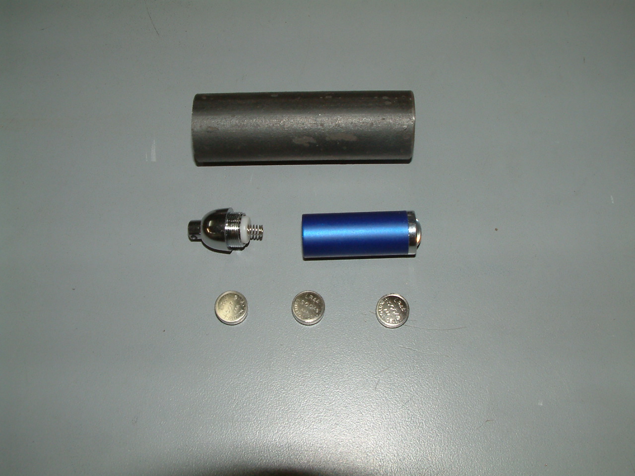

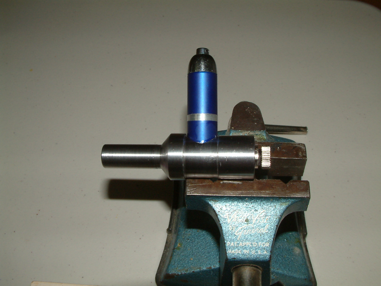

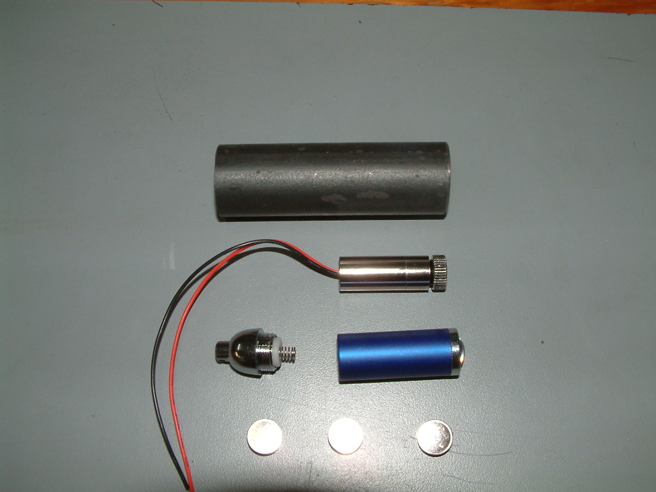

    Here is an inexpensive Laser Edge Finder that is cordless. It could be made using a USB cable for power but I wanted a cord free design. The parts are very inexpensive on eBay. The key chain flashlight is $1 and the Laser Cross Hair is about $3.50. Just turn the arbor concentric and make it a slip fit for the laser assembly.

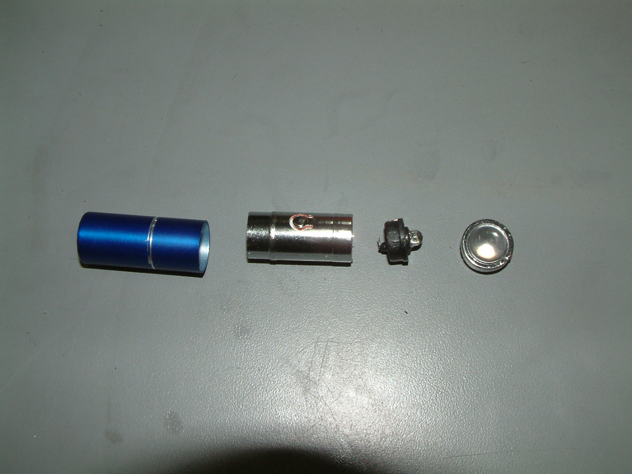

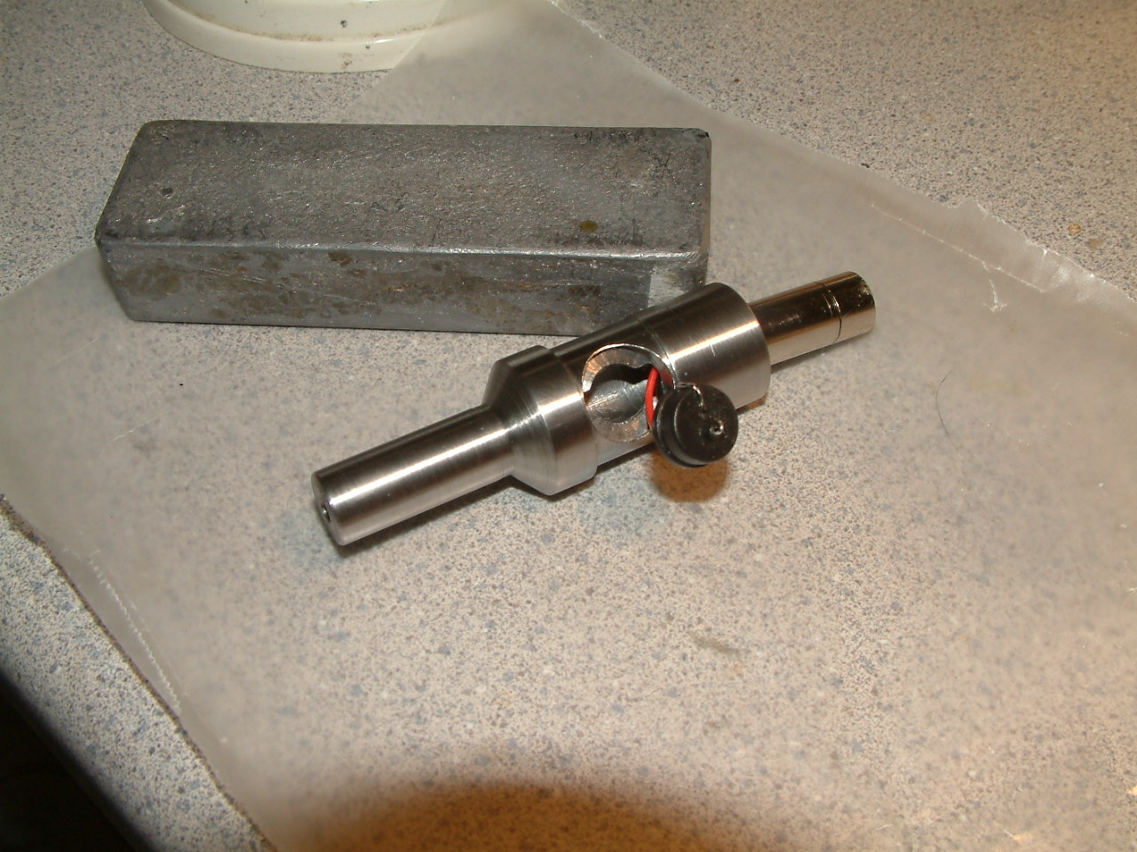

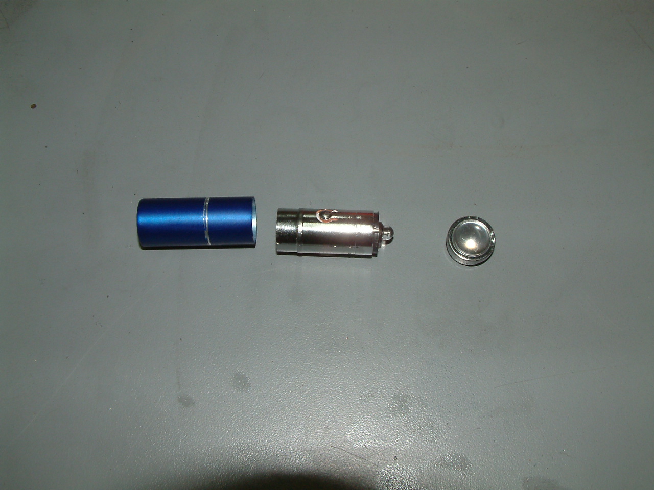

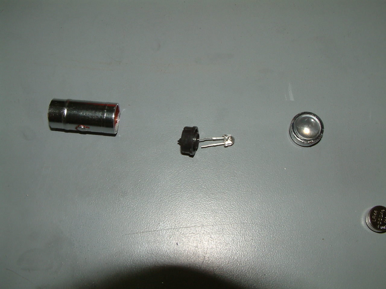

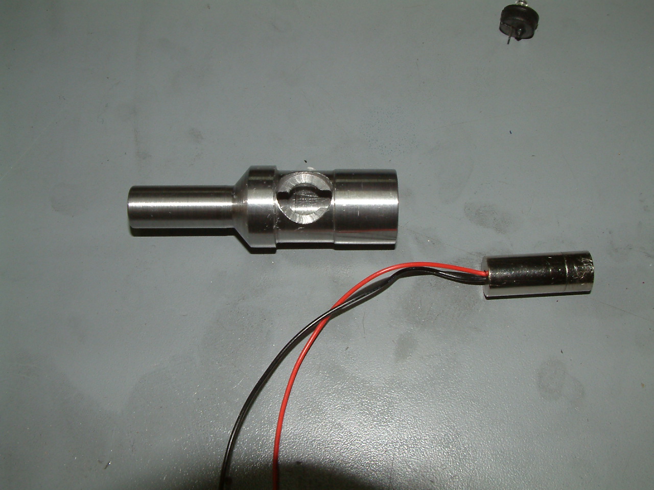

    I used CA glue to fasten the flashlight to the arbor and put a very small drop on the laser itself at the very end of the arbor. The flashlight was disassembled and the led removed but the led mounting plate was used for the connector insulator. I just tinned the laser leads and bent them over using that insulator for the new connector block. Works fine every time. The "lens" on the laser is adjustable and the thread was very loose which made for a very inaccurate unit. To snug it up I used two wraps of teflon tape (plumbers variety) on the threads and now it is much better. If you are looking for .001" accuracy and a very fine pair of cross hairs you should invest in a laser that is of higher quality. This one works fine for a quick setup but I still go to my mechanical edge finder when I need .001" accuracy. One of these days I may find a better laser crosshair.
    The steel used was just HRS. It was 3" long and 1" in diameter. Od was turned to .875" which made it easy to hold in my 5C collet square block for drilling the side access hole. I think that was .500" which gave the flashlight just about .015" clearance and some room for glue. The hole was step drilled and finished with a .5" EM. I was careful to leave a step inside for the end of the flashlight to register on. The hole for the laser finder was drilled as deep as I could go to allow room for the excess wire of the laser cross hair.
    The flashlight is only $1.00 on the bay so I bought several and gave my wife one for her purse. One of the 4 that I bought would not operate due to a bad switch. Not all that bad for $1.00
    Cheers, JR

    How do you use it ? In other words how does it work, do you wait until you see a laser dot on the edge of the workpiece and then do some maths using cutter diameter and he gap between laser and mill axis ?

    That is a cool little tool, the only question I have is how did you collimate the laser beam.....Dennis

    If the beam is collimated there should be no reason for any math as the beam would be on the center axis of the mill. as I see it that's the part of making it accurate......Dennis

    Hi Steamingbill, it is easy to use since the laser projects an X and not just a dot. The center of the projected X is the center of the spindle unlike the mechanical edge finder (which I still use when I need the best accuracy). No calculation required. Just put the cross hairs on the corner of the part and you should be very close. If you then rotate the spindle by hand (no power) you can then set the crosshair so that at least one leg is parallel to the part and on the edge of the part. No math required.
    Thanks for the note Gramps43, You are correct about collimating the Laser. I just made a very close fit with the bored hole in the arbor. It is not as accurate as the mechanical edge finder but it is great for locating stock on my CNC router. The mill still gets the mechanical edge finder in my shop.
    Cheers JR
