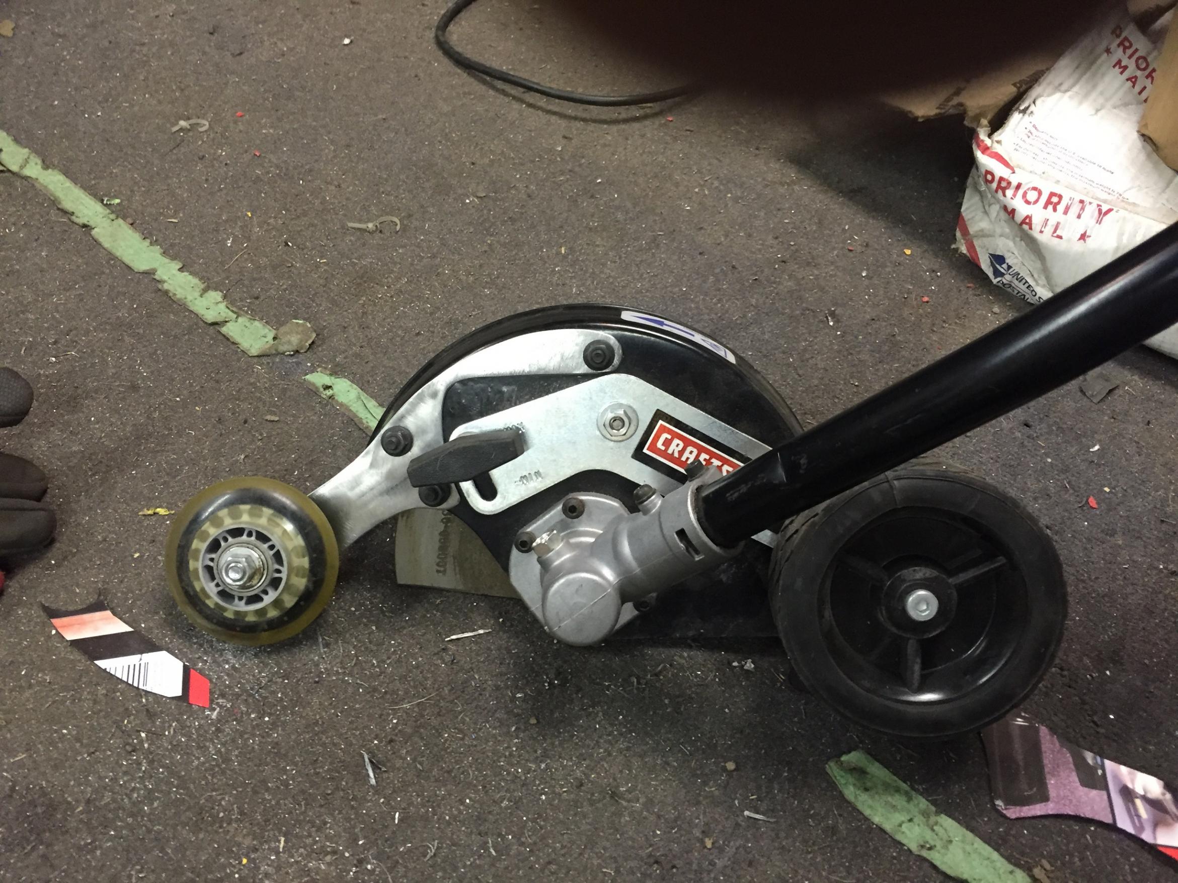

edger attachment second wheel

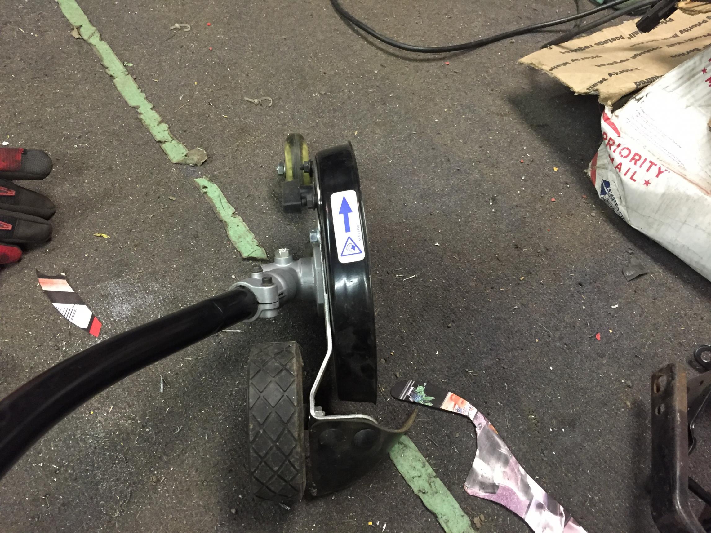

I have no idea why this edger attachment has only one wheel. It makes the depth adjustment pointless.

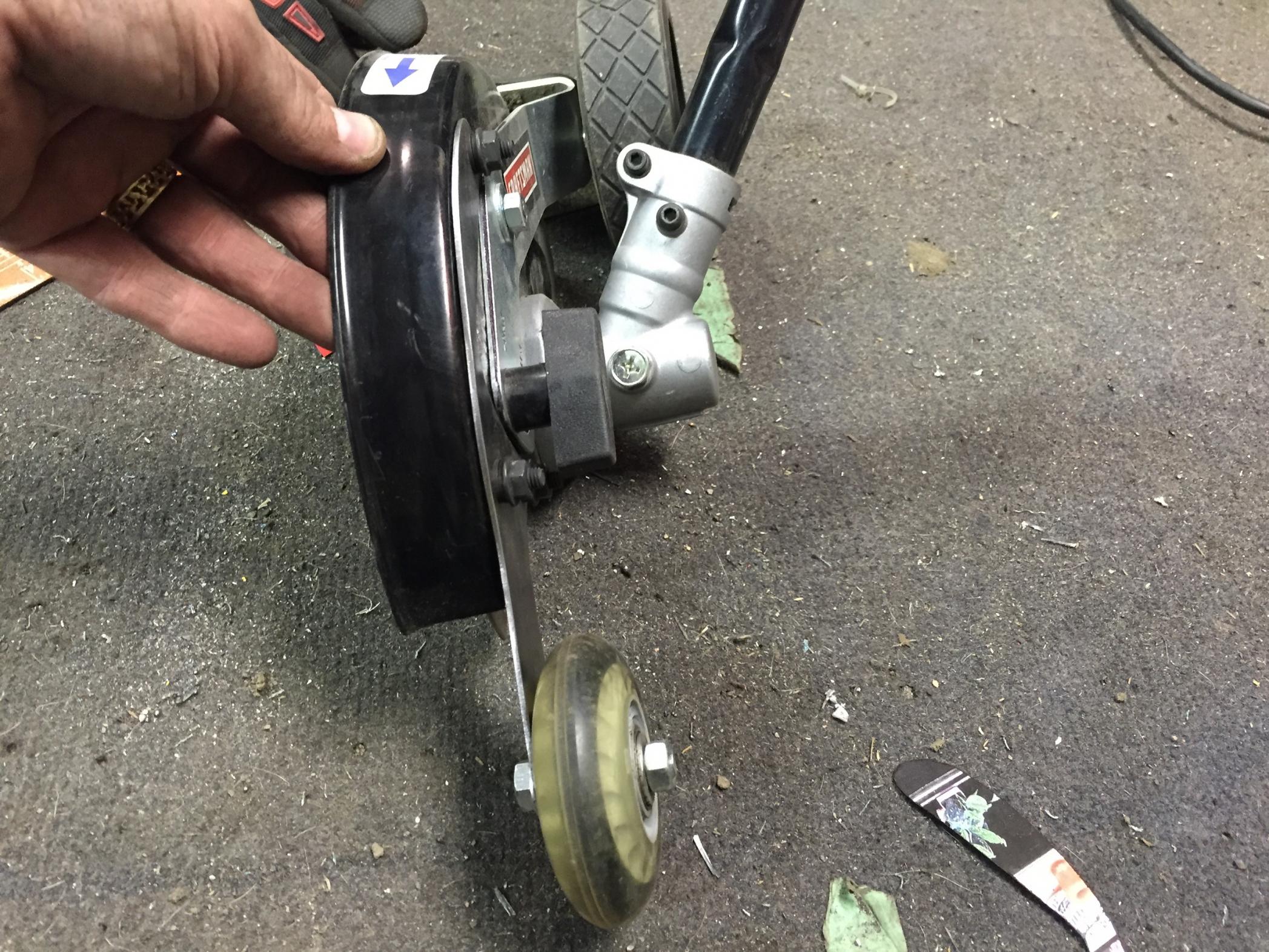

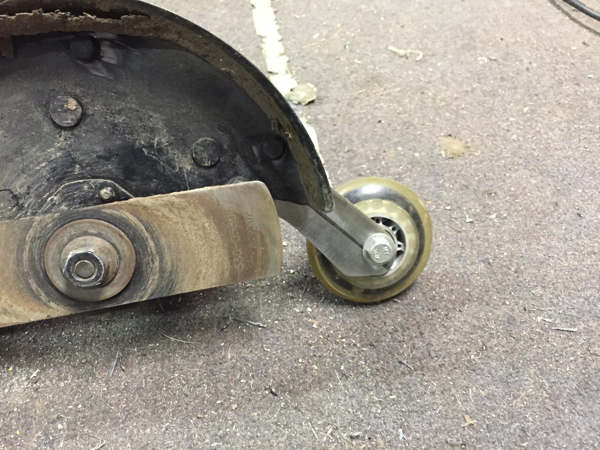

I made the part from leftovers of the treadmill frame I used for my shrinker/stretcher stand. It wouldn't support much weight, but that's fine, as it only has to support the edger, and it'll do that.
First I made a paper template, then used a plasma cutter to cut the rough shape, and an angle grinder with a flap disk for final shaping. I tried to make it look like it came with the tool. It'll get painted at some point. Probably. The roller blade wheel is temporary unless it works well enough.
Attachment 10778 Attachment 10779
Attachment 10780 Attachment 10781

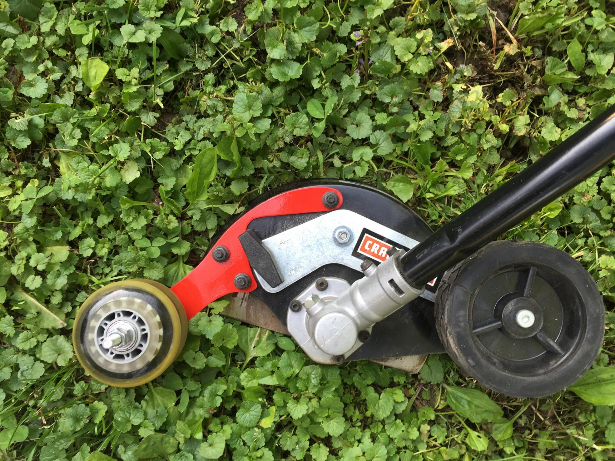

I painted it and added a second wheel. Stands up by itself now. Just need to tidy up the axle bolt.
I didn't have any Craftsman red or gloss black, so I went with battleship gray.

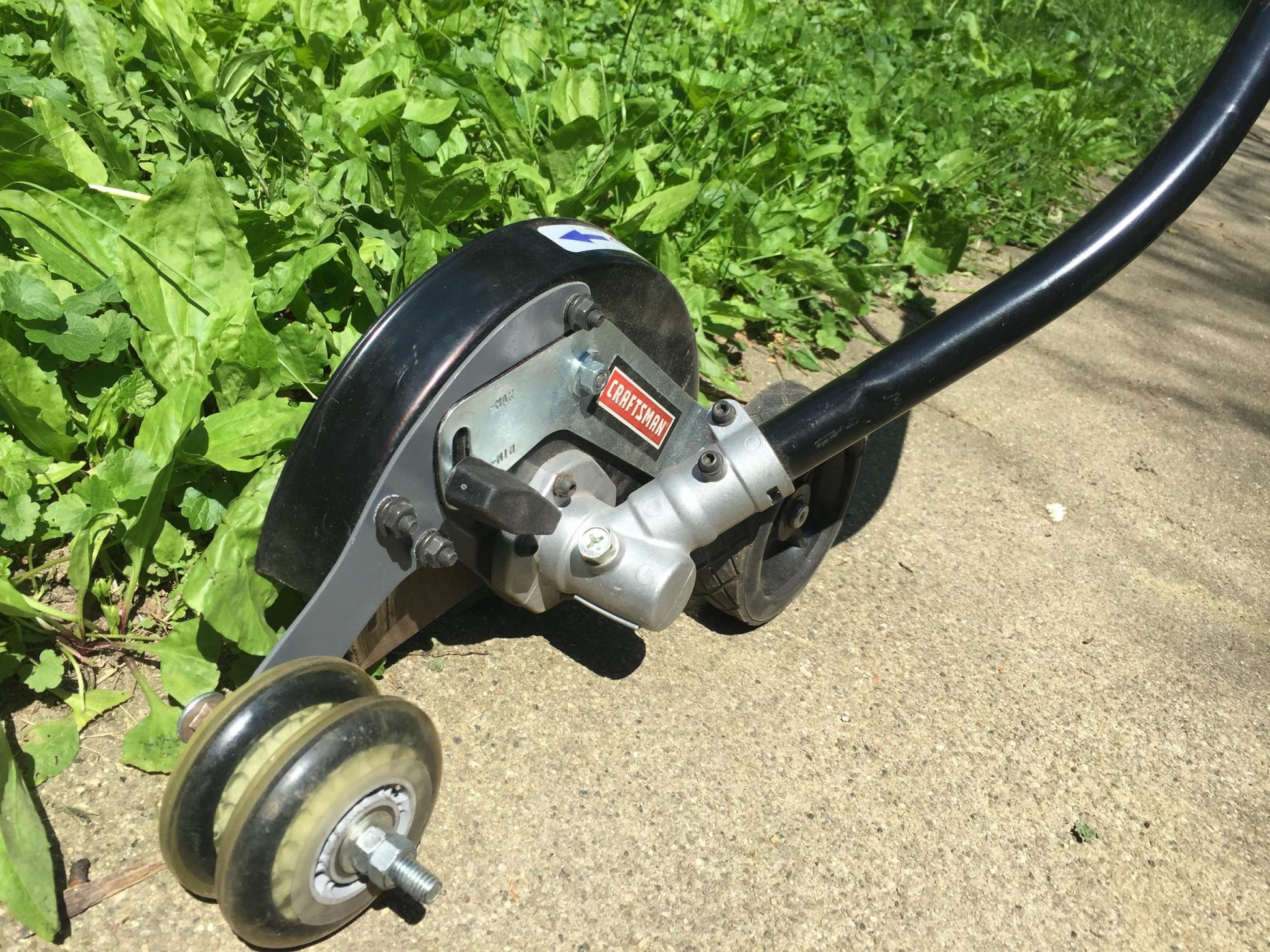

Attachment 10802
I didn't like the gray on this, so bought some red paint yesterday.

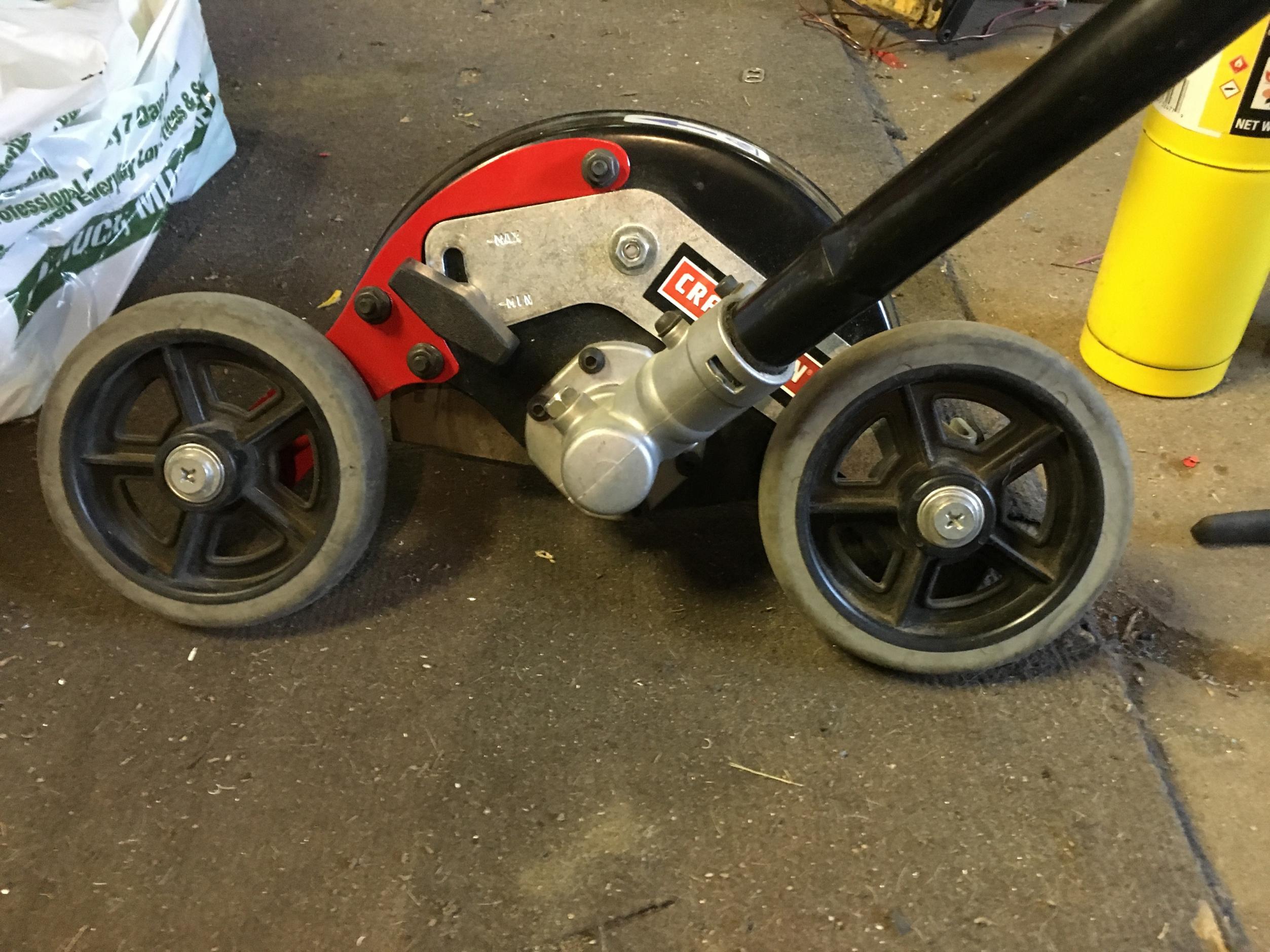

Attachment 10858
Finally found the wheels this needed. They're from a Magna brand folding dolly.
