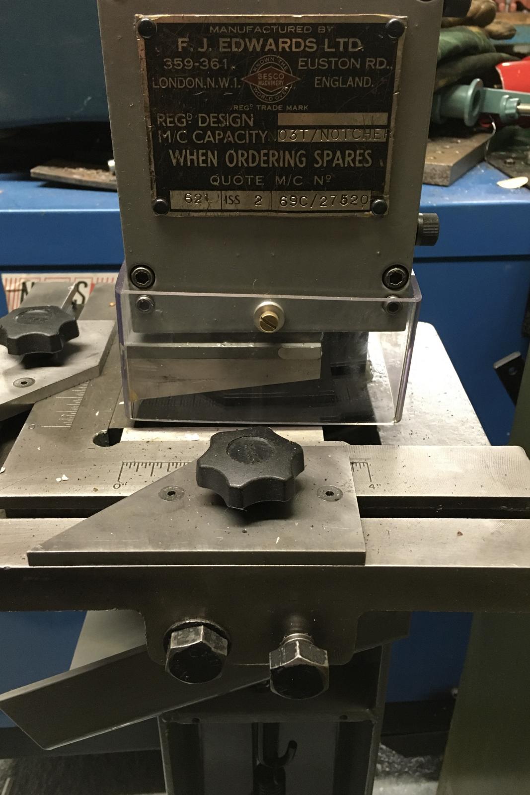

Unfortunately i can't find any original photos before I stripped it down and repaired the notcher. After degreasing and cleaning all parts I had to make a new foot treadle and linkage and sharpen the cutting blades. A total repaint and new safety guard and stops were also made. The photos show the finished notcher ready for use.
Attachment 32241
Finished corner notcher

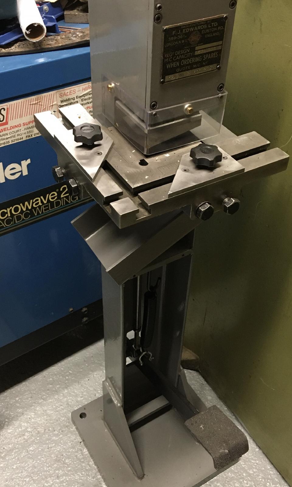

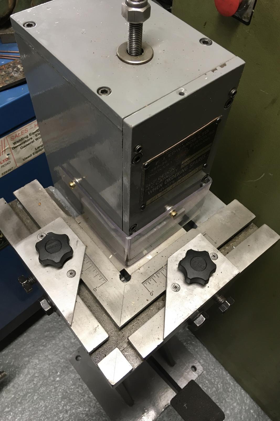

Attachment 32242 Attachment 32243
New stops and safety guard

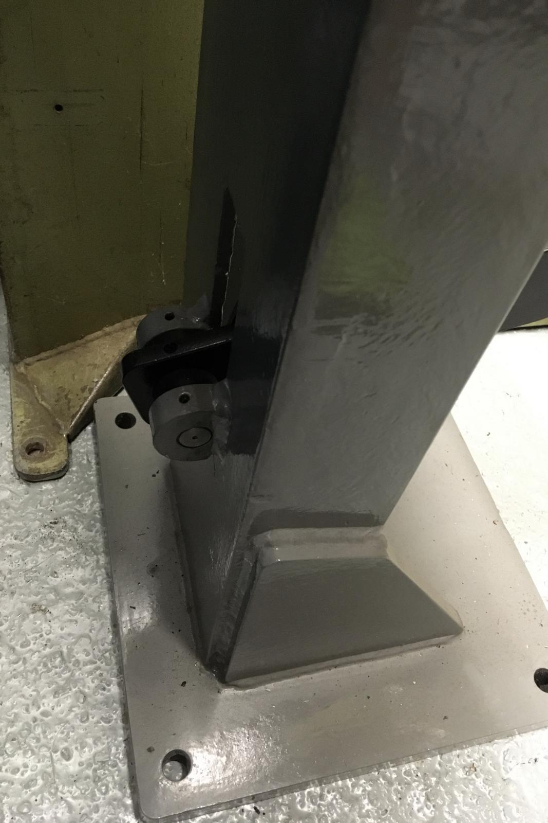

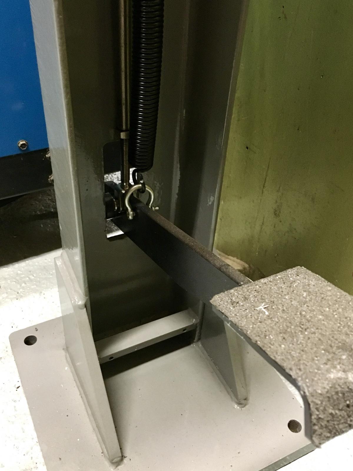

Attachment 32244 Attachment 32245
New foot treadle and pivot shaft plus linkage.
