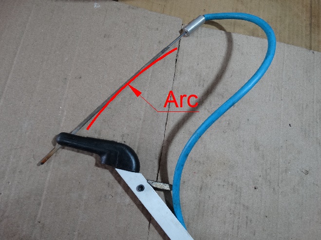

An important detail that I failed to mention. The electrode is fixed through a small arc, formed by the flexing of the blue cable (shown in the photo). Thus, it is possible to adjust the size of the electrode, without the need for any other type of fixation.
Attachment 37729
This electrode holder is a very useful tool, especially for those who still do not have skill and practice in handling the electrode. I hope it will be useful for any of you, as it was for me!
Finally, when the electrode is short, you can use it in the conventional holder. Thus, no material is wasted! :lol:
