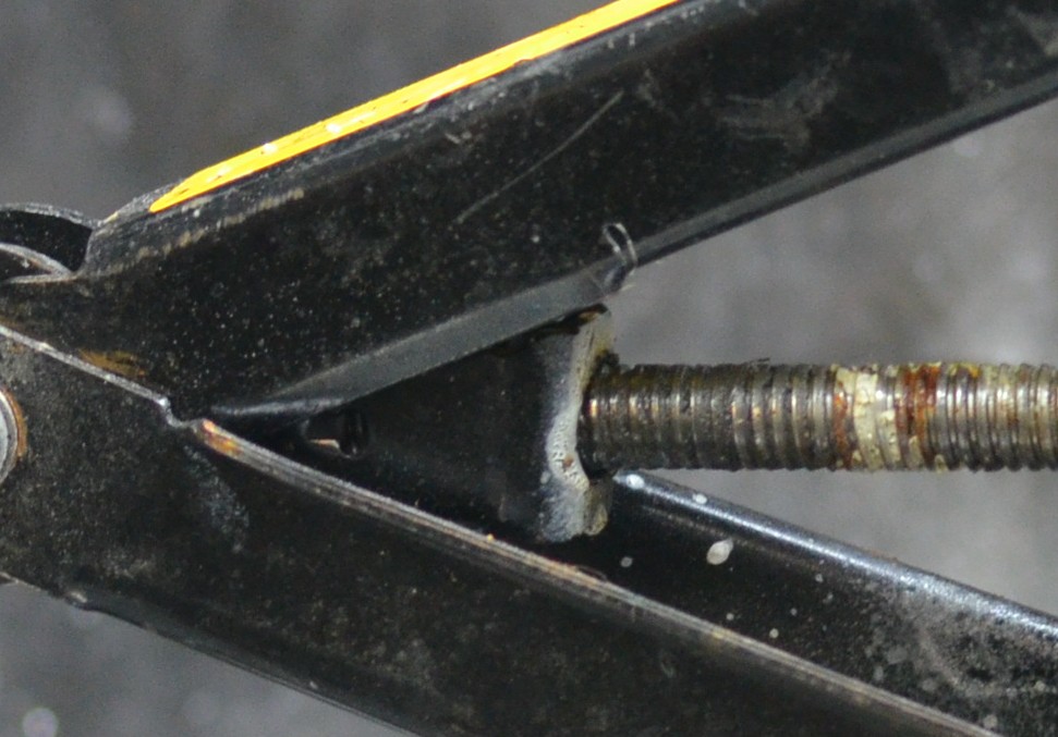

No problem, I had a spare and a screw type jack. The jack was brand new by Ford. As the tyre was completely flat the jack had to be closed to its minimum height to fit under the car. This is the situation which applies the largest load to the screw. Anyway I started jacking away and the car started to lift when with no warning there was an even louder bang than the tyre bursting and the car dropped down. Firstly, I just thought that the jack had slipped (the ground had a steep slope) and I tried again but nothing happened. Examination of the jack showed that the the screw thread had stripped.
Attachment 20626

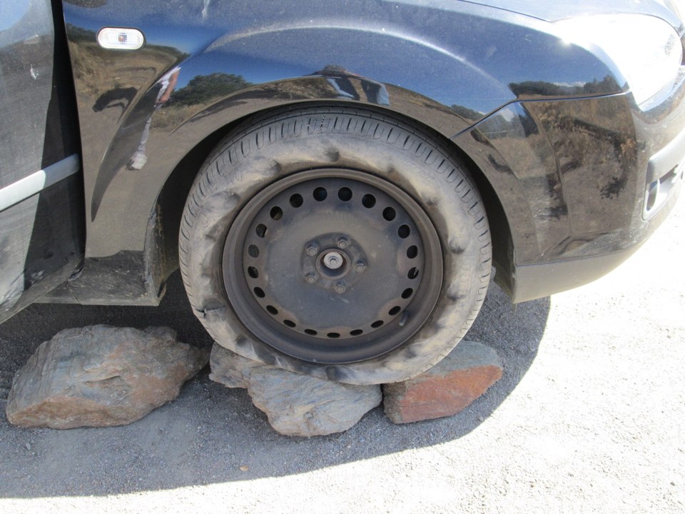

On the way up the trail I had noticed that there was an area where there were a lot of flat stones. I thought that if I could drive up on some stones the underside of the car would be higher off the ground and I was hopeful that it was only the thread on the screw that stripped and not the nut as well. So I drove back down the hill. With a higher starting position it would have been an undamaged part of the screw in the nut. My optimisum was ill founded though. The nut had stripped as well and the jack could not take any significant load.
Attachment 20627
Here is the car on the makeshift ramp. I found one stone with a tapered end, so I positioned that first to ease the transition. Note the tear at the eight o'clock position.

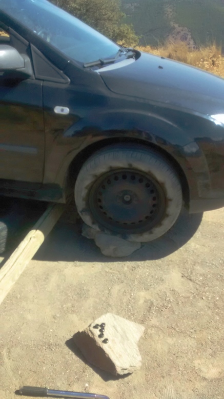

I needed new tools. I started to look for ideas in the surrounding area and unbelievably I found a long wooden pole 100 to 120 mm in diameter. I turned to my wife and said that the ghost of Archimedes was smiling on us. She had no idea what I meant. I got some more stones to act as a fulcrum and with the pole positioned appropriately I was able to lift the car a little. So I managed to work the car upwards in steps. As I lifted, my wife stacked stones under the car to hold it, then I would add another stone to the fulcrum etc.

Under the circumstances taking photos was not a high priority, I took the previous one when resting, my wife took this one with a phone, it is the only record of the Archimedian influence.
