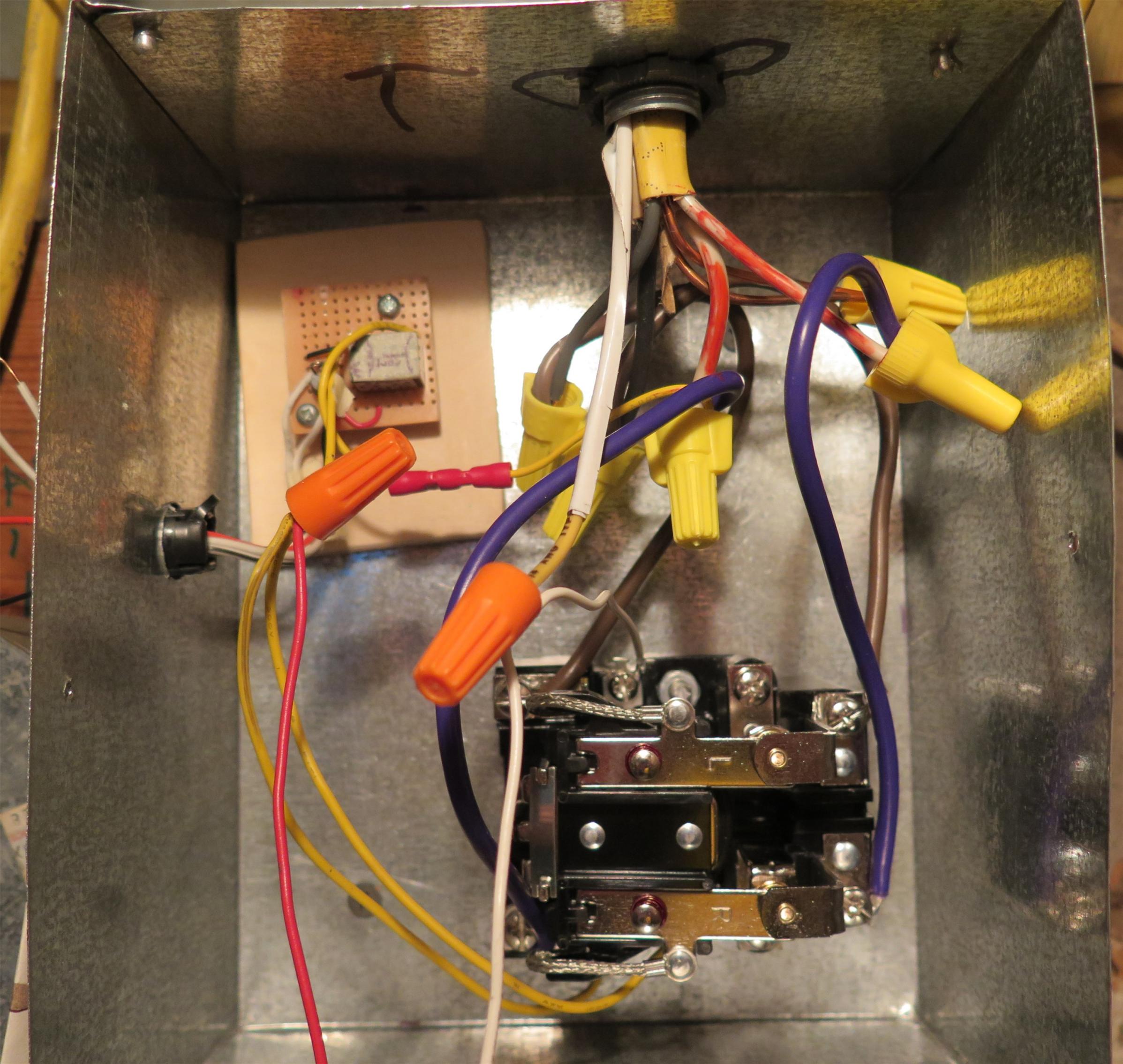

So I recently built a emergency pump shut-off circuit that will limit spilled water to what is in the pressure tank (4 gallons or less).
Attachment 8219

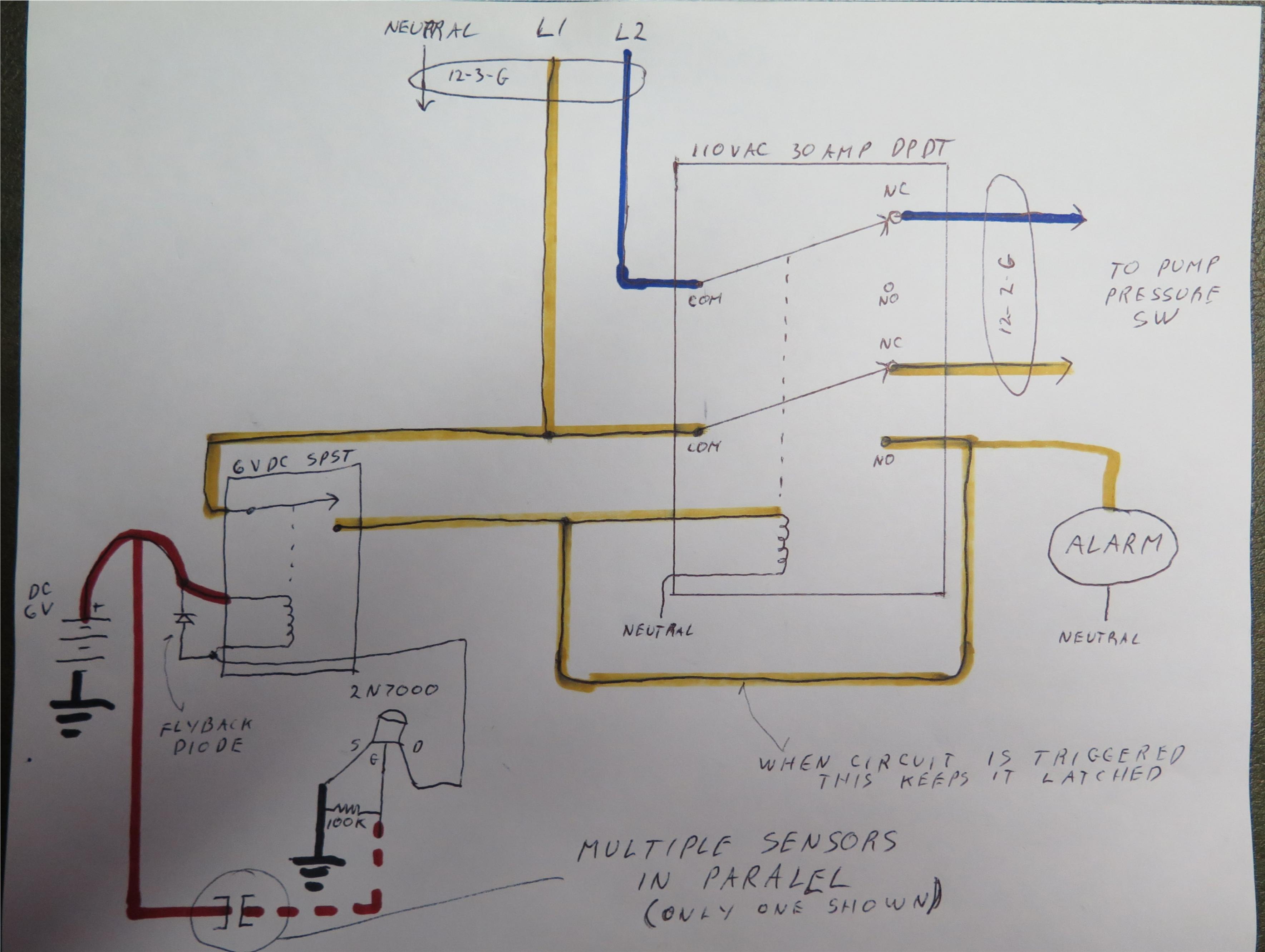

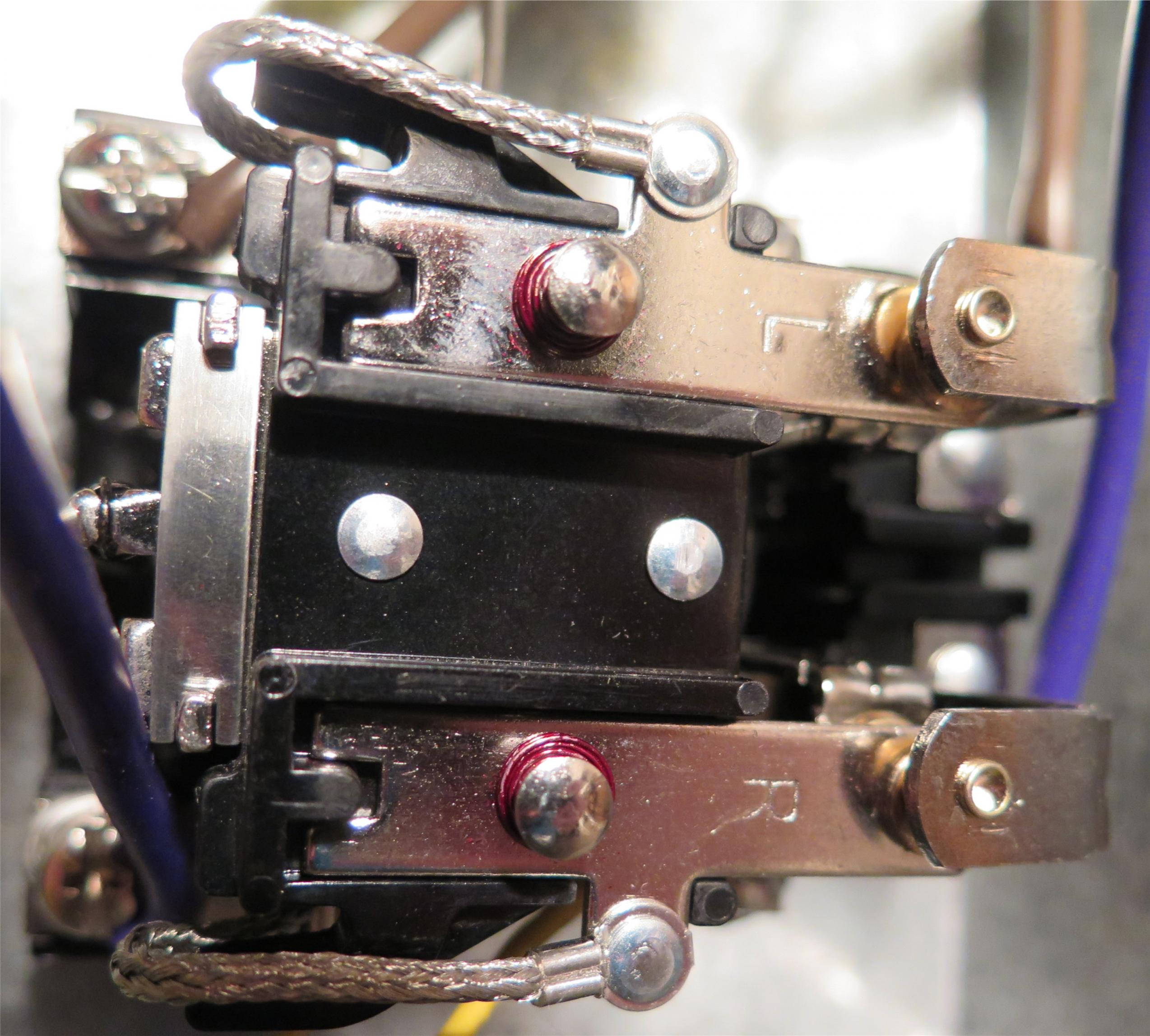

The circuit uses a 30 amp DPDT relay which is normally in the inactivated state, so there is no power drain until a problem occurs.
Attachment 8220
The sensor part of the circuit uses a low voltage relay powered by a MOSFET transistor. This is powered by 4 AA cells to get ~6 volts. I measured imperceptible drain on these batteries (no reading on micro-ammeter) so batteries should last a long time (> 2 years).
Attachment 8221

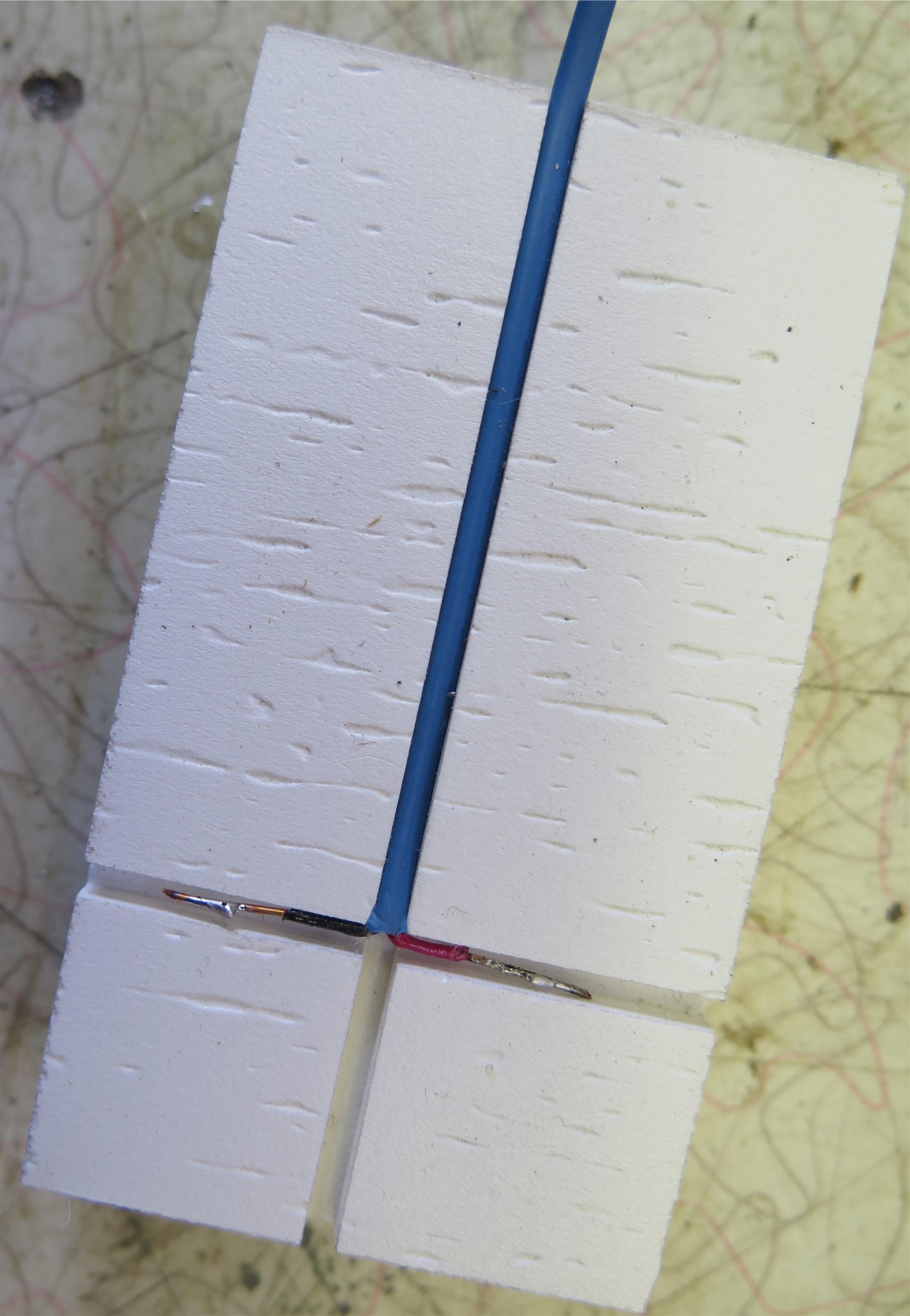

Sensors are simply 2 wires stripped and tinned and set in a plastic block. I have them at every sink and the main utility room in the basement. The MOSFET is a readily available inexpensive one (2N7000) and is required to drive the 6 volt relay. Besides the 2 relays and MOSFET there is a 100K ohm 1/4 watt resistor to bias the FET to keep it in OFF state and a FLYBACK diode to protect the FET from reverse current when the relay turns off. Most any small signal diode would work.
Attachment 8222

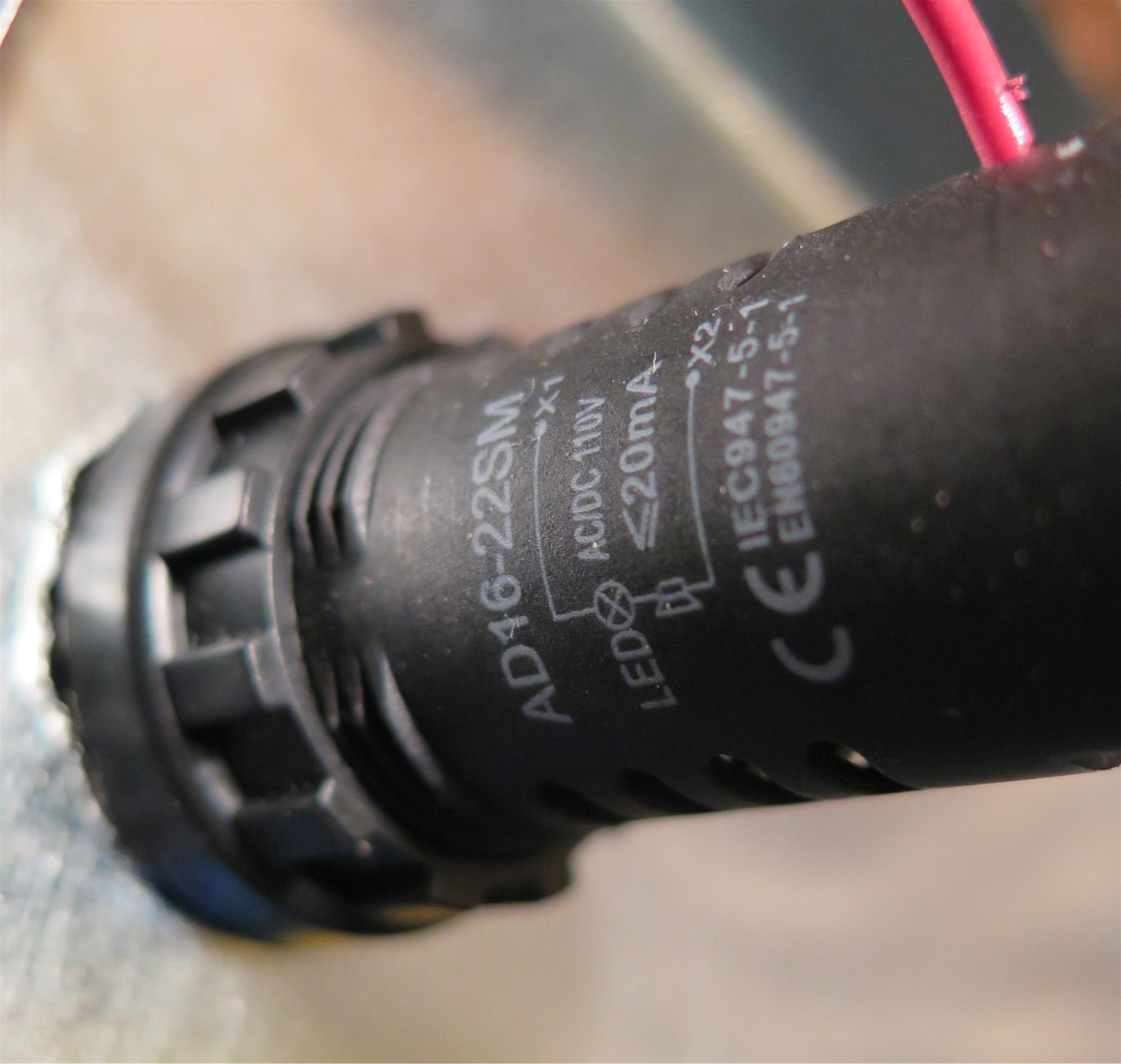

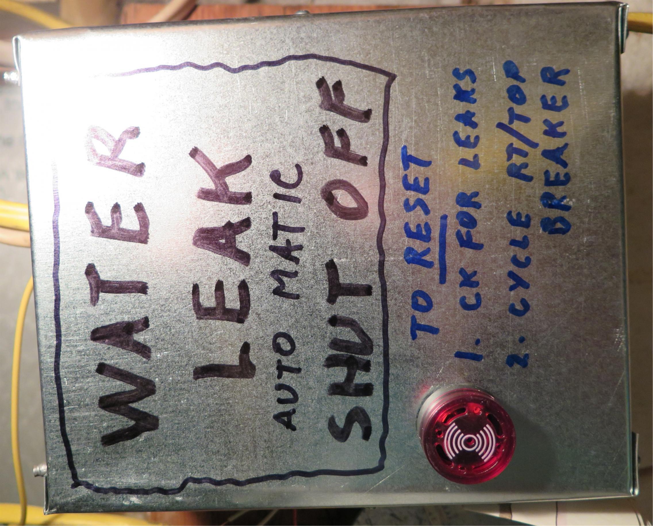

Once the circuit is tripped by a leak, it latches and turns on an alarm signal.
Attachment 8223
To reset the circuit after being tripped, simply turn off then on the breaker for the pump.
Of course this is only good for well water systems in its present configuration but I don't suppose it would be very difficult to make a shut-off valve for a city water system.
