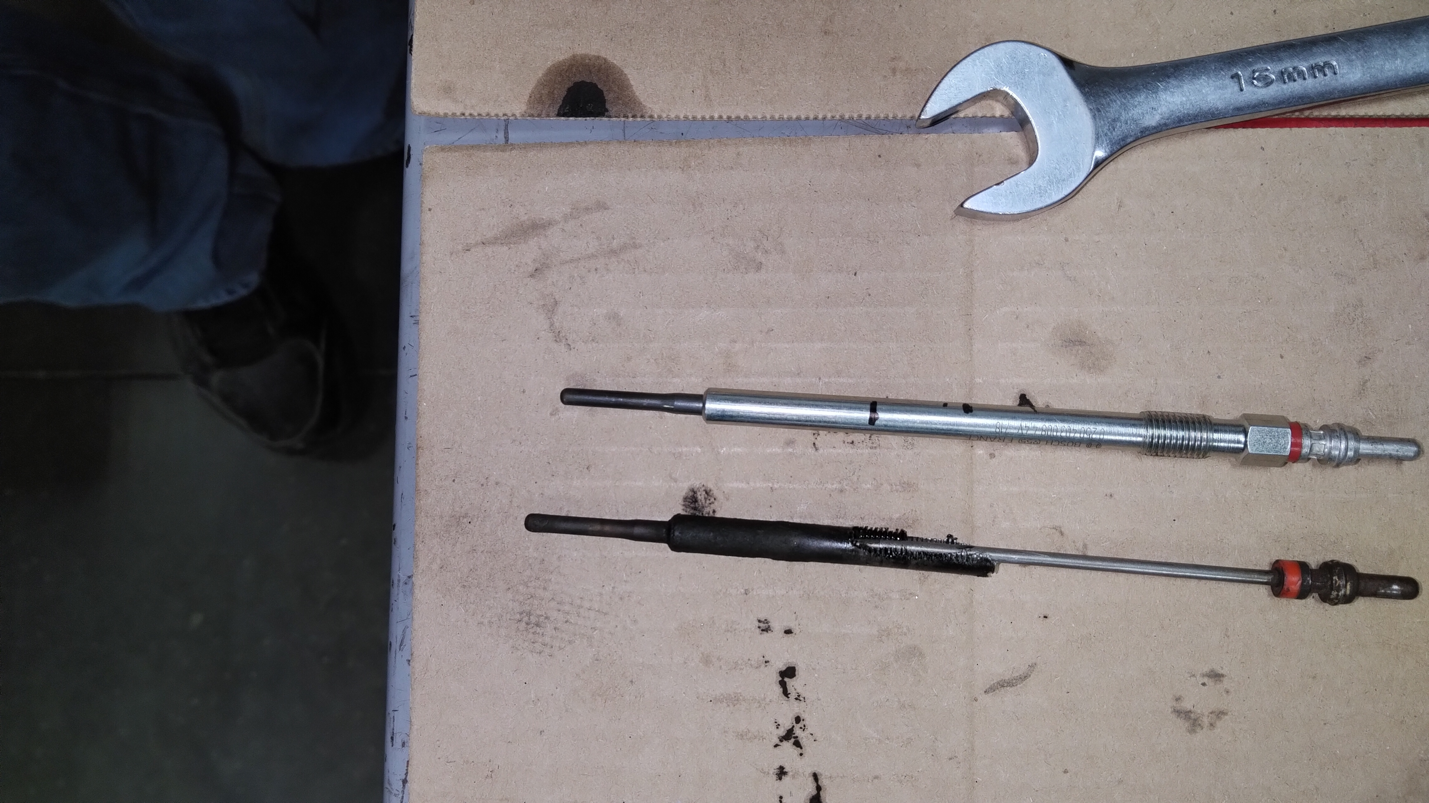

I did something similar this weekend with a 1/4-28 tap. I was helping my neighbor remove a broken glow plug from a V6 diesel engine.
Warning, what ever you do, DO NOT BREAK THEM OFF.
It turned into 3 days of work. I was making different size drill guides that would thread into the M8x1.0 glow plug threads, those were cleared out of the head with a kit he bought from Amazon for this purpose. That kit has a step drill that is 7mm at the large end, that drills out what's left of the 8mm threaded portion. Problem was it was drilled cockeyed. and left a burr on the extension tube below those threads in an aluminum head. The idea is that step drill's smaller diameter puts in the correct hole size for a 1/4x28 tap. So it's tapped, then a puller that threads into that is screwed in, and in this case it's a jack screw type puller. So no feel of what's going on. It stripped out and did not remove the remains of the glow plug. So much more work going deeper into what was left.
This photo has the new glow plug, and the remains of the one pulled out.
Attachment 44532
I never took a picture of the tap extension but did the same thing, and then tig welded it to the tap with 2 spots. I ground them on the surface grinder, as well under cut the tap so it could thread beyond the threads.
As it was, pure luck getting it out, as the side of the threaded hole in that tube is seen. I had to make a pull rod from 1/4" round bar to be long enough as the kit was limited. And I made a simple sliding hammer from some larger scrap round drops.
