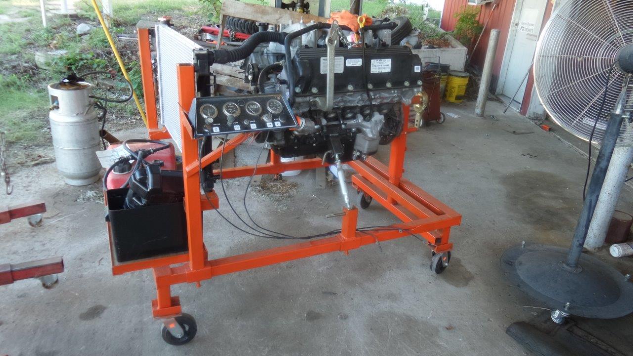

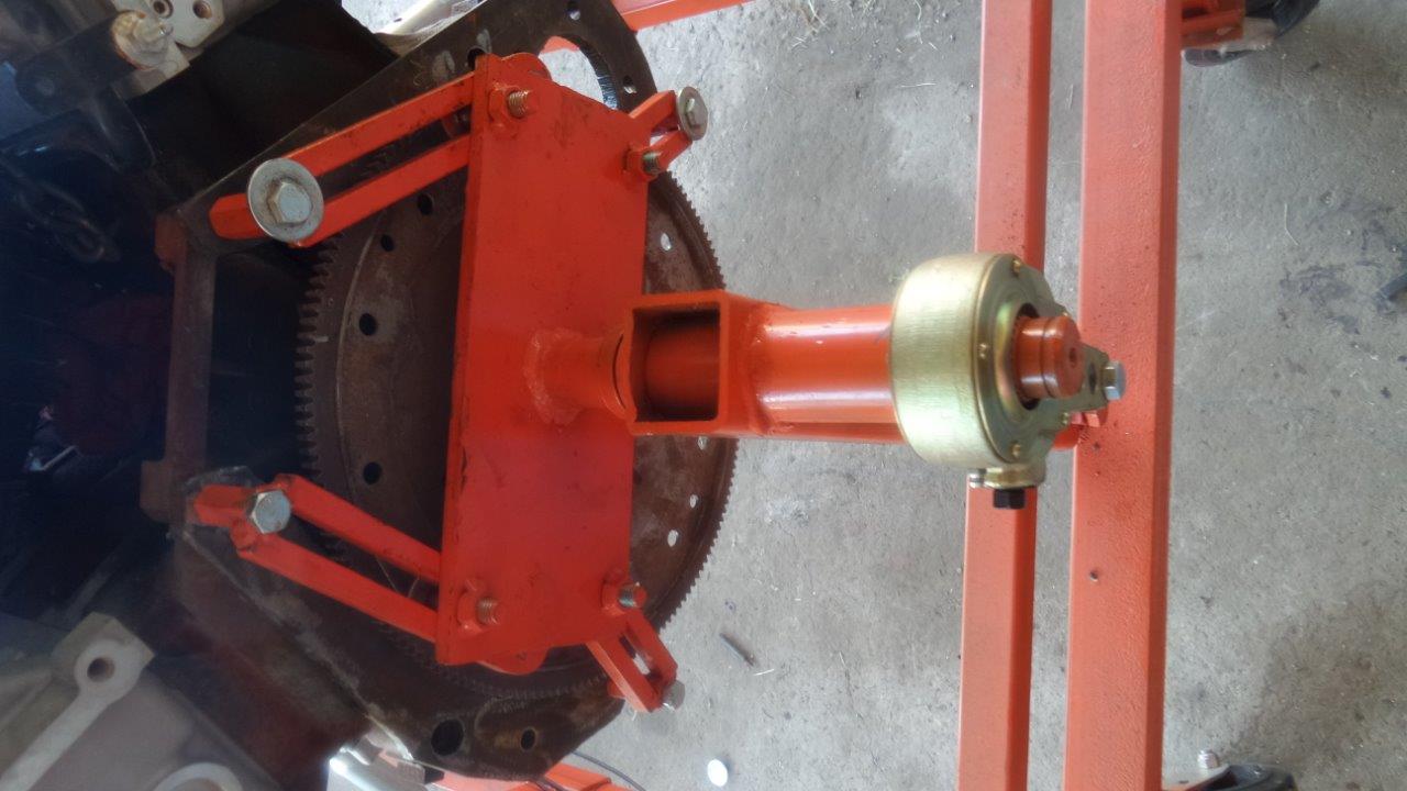

I made a dual purpose and fully adjustable engine run stand.
I wanted something that I can test engines before going through the labor of installing in the vehicle. I am currently working on a V10 for a ford van. It is a major job to install the engine. Don't want to have to do it more than once. I will be able to use this on all my engines. This design, is a dual purpose engine assembly stand and run stand. If you need to rotate the engine to work on it, there is no need to fully remove it from the run stand.
Attachment 24611

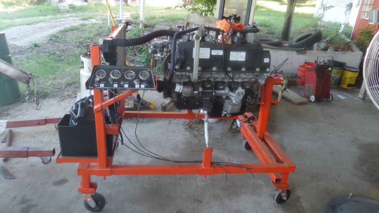

The base is 5'x3' made form 11 ga 2x2 tubing. I have short risers on the feet with 6" heavy duty castors that allows it to easily roll on uneven ground. Prior to welding up the bottom frame, I cut some 2.5"x3/16 tubing that sleeves over the rails to attach engine mounts and radiator mounts. These have a 1/2 nut welded into the bottom to securely clamp them in place.
Attachment 24612
Attachment 24617

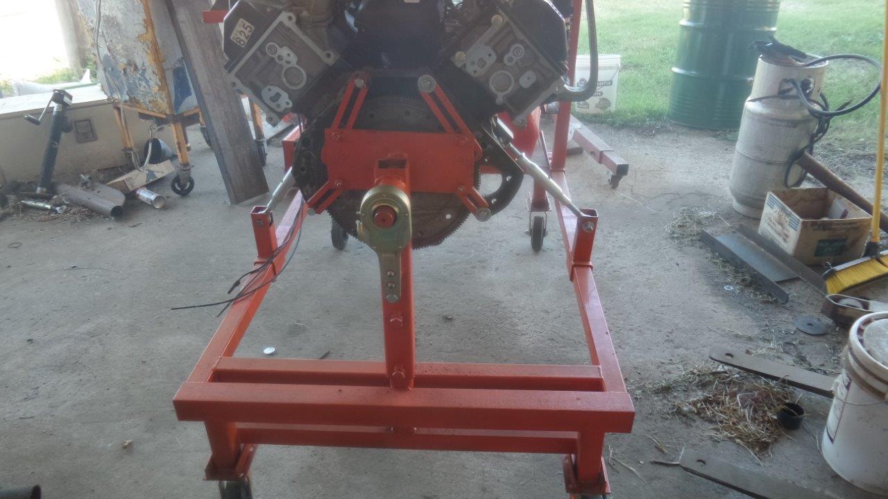

The main tower for the engine stand it 2"x1/4" tubing that is sleeved with 2.5"x3/16 tubing. This allows for up and down adjustment. There are two 3/4" bolts on the outer sleeve to securely fasten the height. In the outer sleeve I welded 2"x1/4" DOM tubing that accepts the semi truck brake camshaft that is welded to the head plate. The head plate was made from 1/2" plate. Drilled and welded in 1/2" nuts. The fingers were made from 1/2 square solid bar. I bent these with 1/2" inner radius to slide over the 1/2" bolts on the head plate. To the end of the fingers I used all thread couplers and drilled out the threads on the inside. To the back side of the camshaft, I have attached a slack adjuster from semi truck brakes.
Attachment 24613

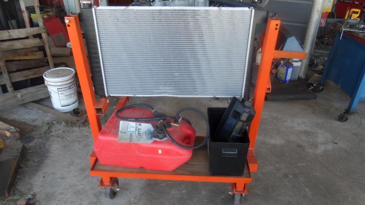

I am using a radiator that I bought that will also be a backup radiator for one of my trucks. I used one from a dodge ram with 360. Below the radiator, I attached a platform for battery box and 6 gallon outboard gas can (its just what I already had).
Attachment 24614

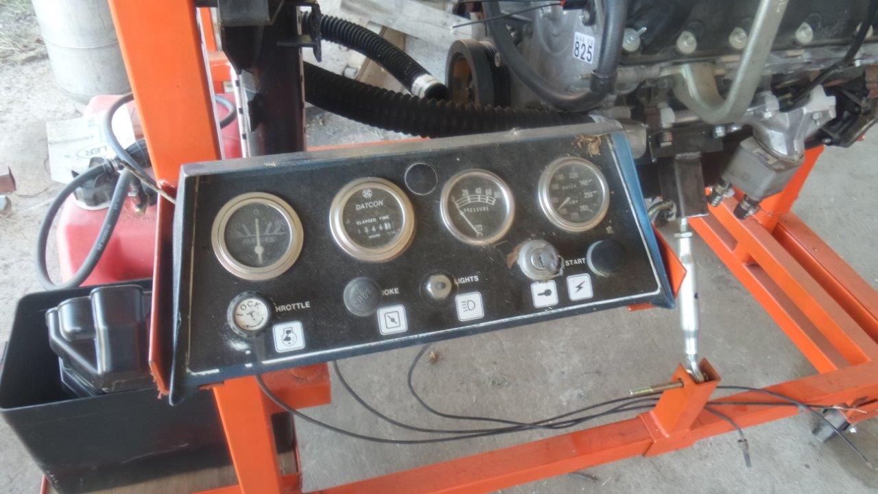

I attached a control board that I scavenged from some scrap equipment that I purchased for the engines. It still needs to be required but has all the gauges and controls that I will need.
Attachment 24615

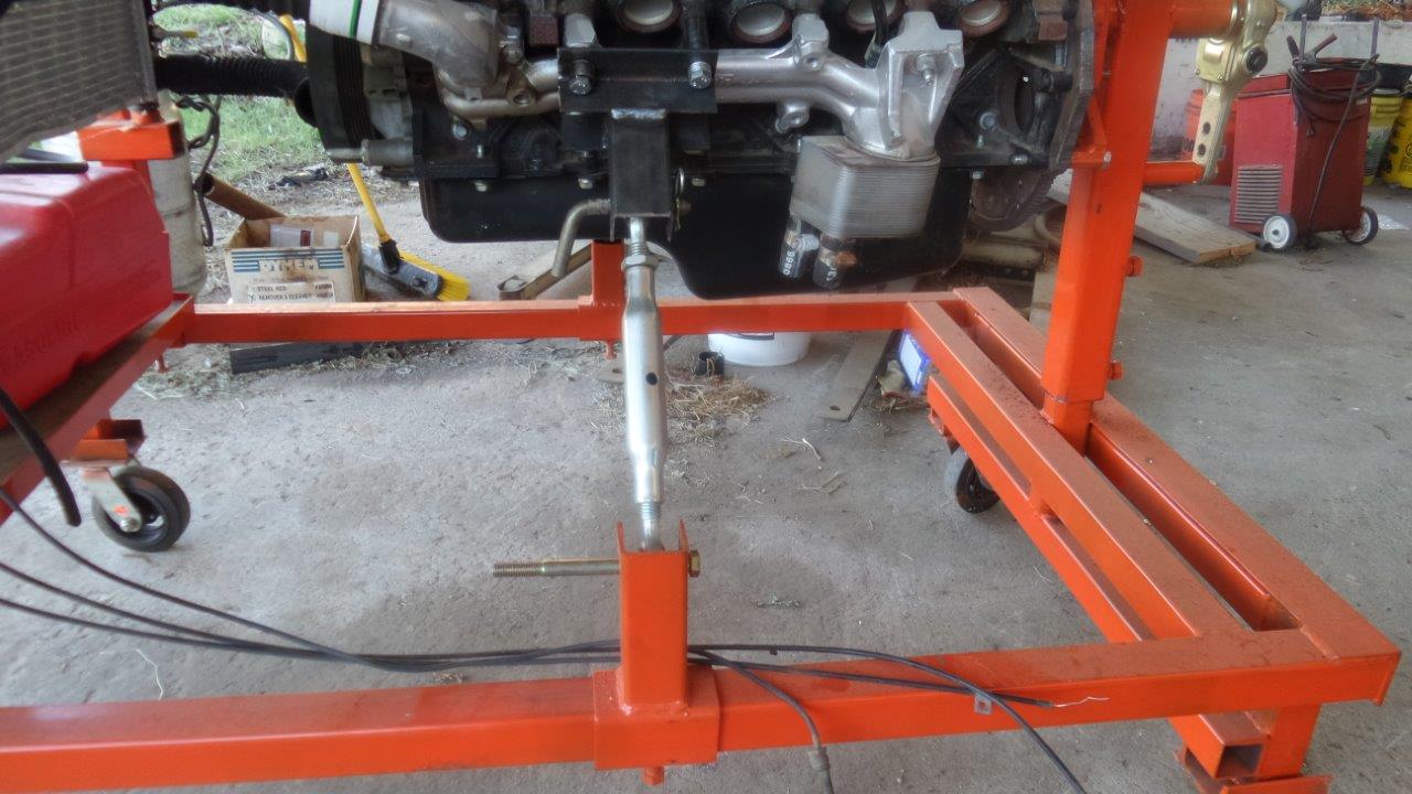

The lower engine mounts are fully adjustable. I used a category 0 tractor top link. I made simple plates that attache to this ford V10. Plates will need to be fabricated for each types of engine I use this for.
Things I plan to change on this design. I plan to weld on forklift slots so I can lift with my forklift. Also the fingers on the engine stand really need to be longer to clear flywheel/flex plates.
