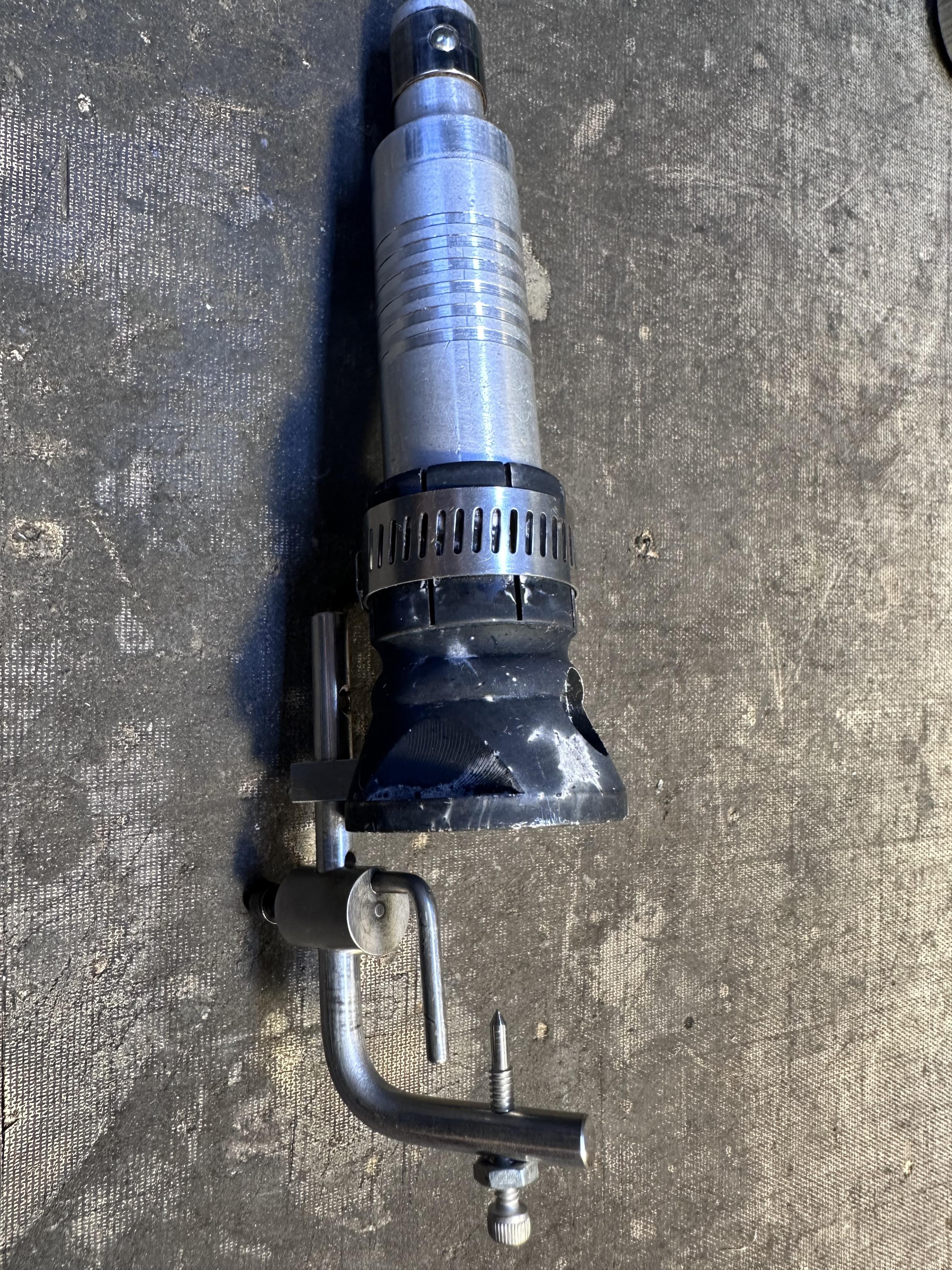

Also, the most common handpiece, No. 30, has a simple cylindrical shape one inch in diameter. The absence of any features or contours makes it really easy to fabricate various holders to permit bringing the work to the tool when that is appropriate.
One of the attachments I have for my Foredoms turns the handpiece into a very small lathe...
Attachment 49625
