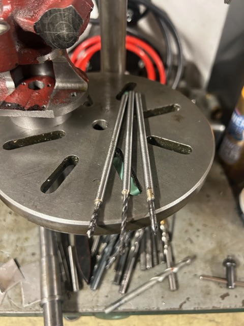

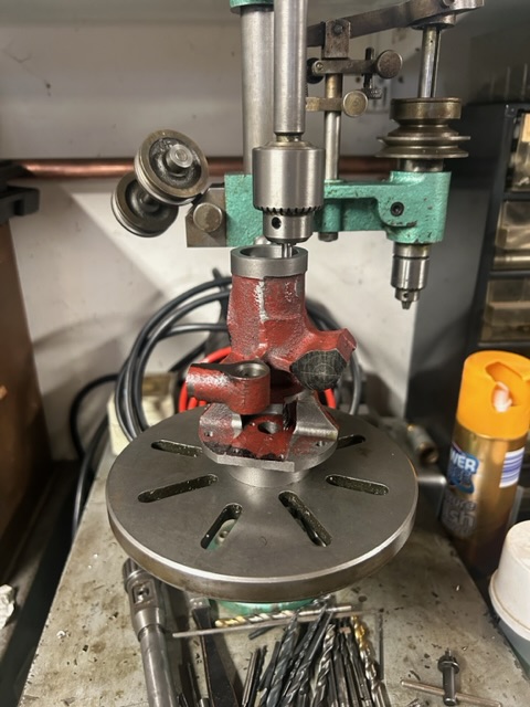

Some cutting tools needed to be extended to reach to the bottom of a bore in the trunk guides for my 3”scale Foden steam wagon for the stuffing box studs.
This is an easy fix which makes an otherwise difficult task very easy to machine.
First a suitable diameter piece of steel plain round bar is cut to the required length and drilled to accept the cutting tool shank diameter. A hole is then drilled at the depth of the hole to allow air to escape when silver soldering. If this hole isn’t drilled the cutting tool will eject itself out of the hole, it also helps with the capillary action required for the joint to be successful. The HSS retains its hardness after soldering so a clean up of the flux and the extended tools are ready to use.
The photos show a centre drill, twist drill and spiral flute machine tap soldered into the extensions. The centre drilling and drilling of the holes was completed on the mill and tapped on my home made mini drill/tapping tool
Attachment 46492Extended tooling
Attachment 46493Tapping the holes
This would have been impossible to do without the modification. These tools now live in my draw of special tools that one day I might never use again, but are ready if ever needed. :lol:
