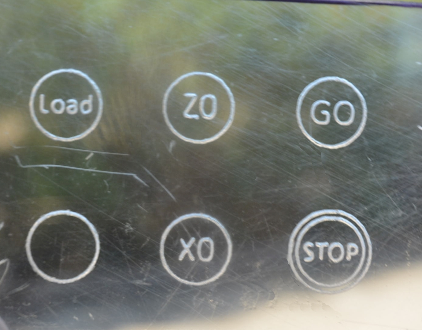

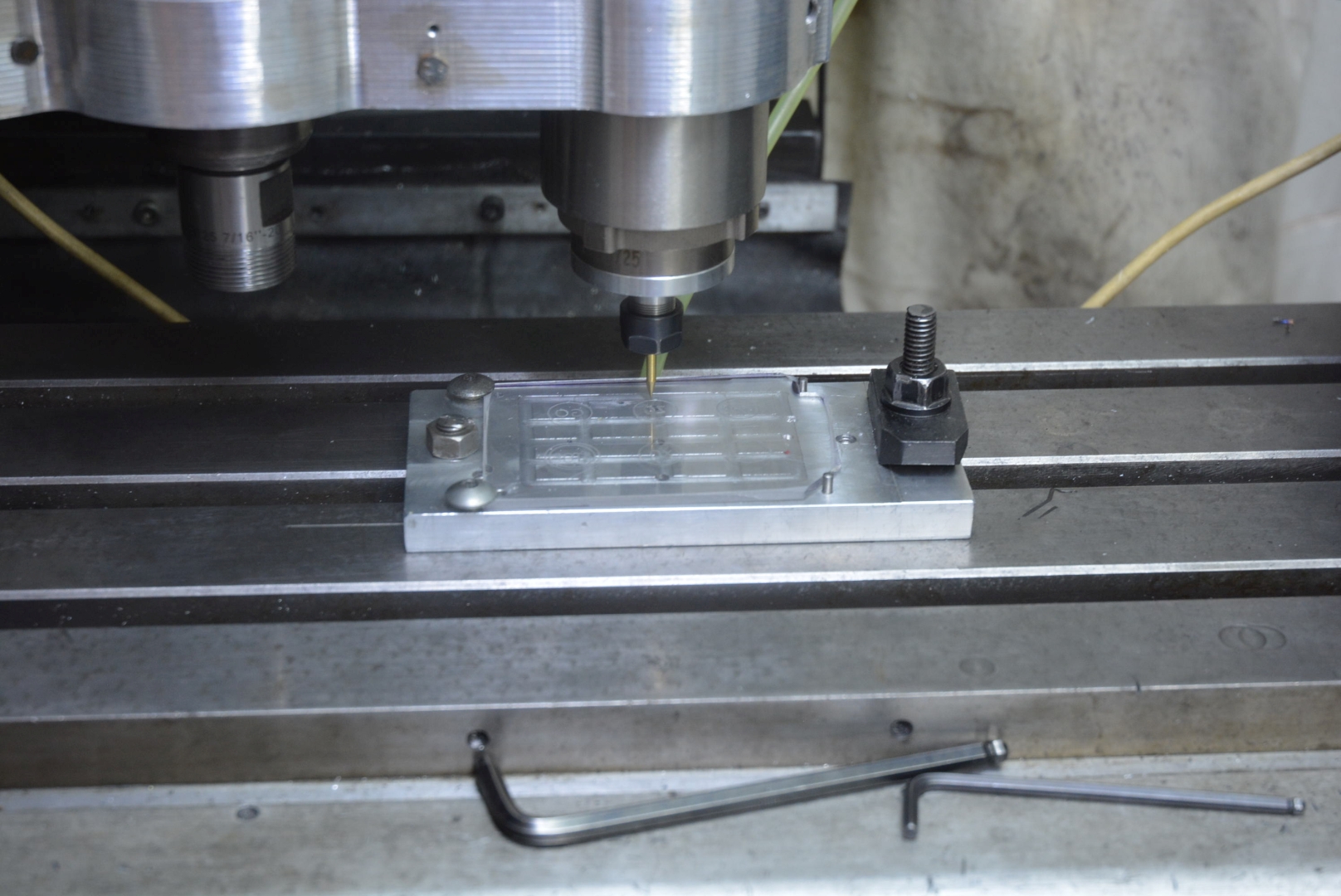

Holding thin stuff for machining is always a challenge. This morning I needed to mill some 3 mm polycarbonate. The cutting forces being a lot less than the steel plate used as an example in this post, that enabled me to use a simple vacuum chuck that I made for PCB milling.
Attachment 47497 Click for full size.
Attachment 47498 The finished piece.
ARe the 8mm set screws to hold the jig in place pushing up on the T-slot?
