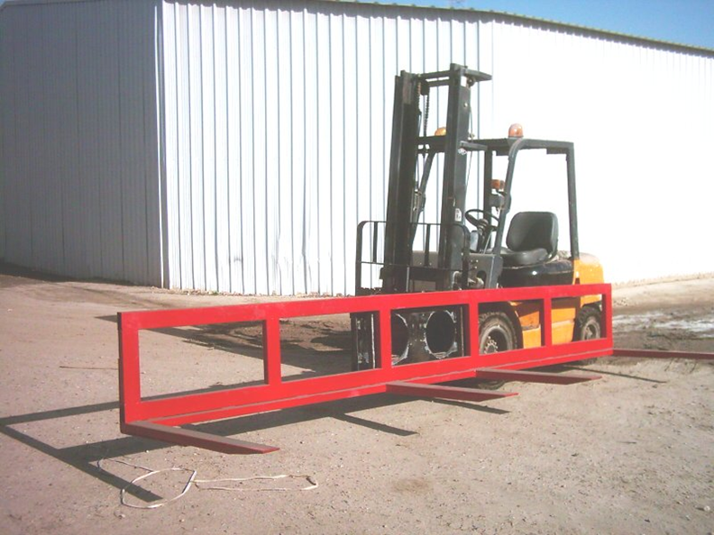

extra wide fork lift forks for carrying very long materials
When you need to carry things like foam sandwich panels that are 45 ft long the wider you can place your forks the safer it is to carry
I made this attachment ot slid over the standard forks of our forklift to do just that. With the 2 additional forks placed 16 feet apart did a good job of protecting the foam sandwich panels from breakage
Attachment 31915

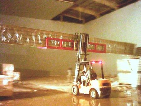

when used in conjunction of the pivot carriage this enabled us to move the sandwich panels through the 12 ft wide door openings in the cold storage building we were constructing
Attachment 31916

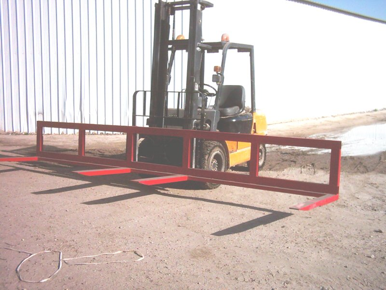

Attachment 31917
