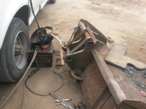

    Extra wide mini excavator bucket

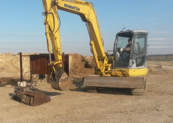

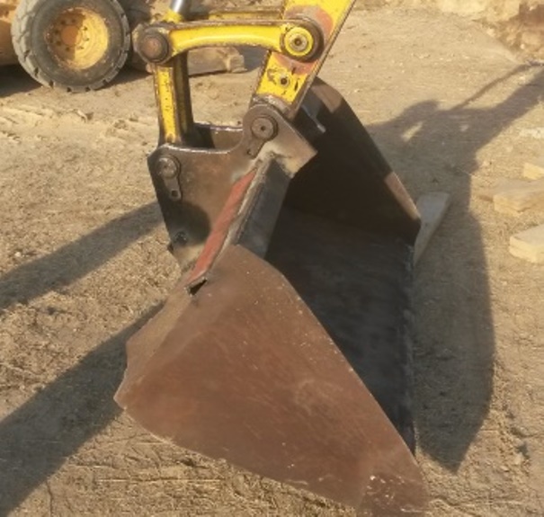

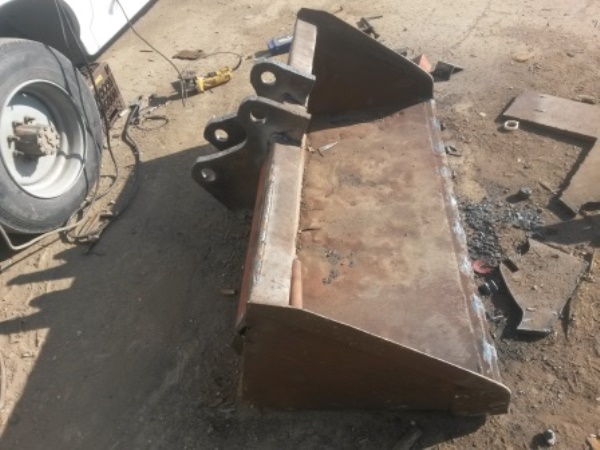

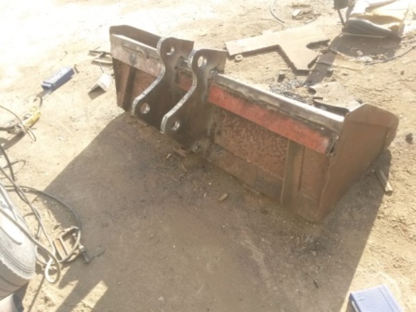

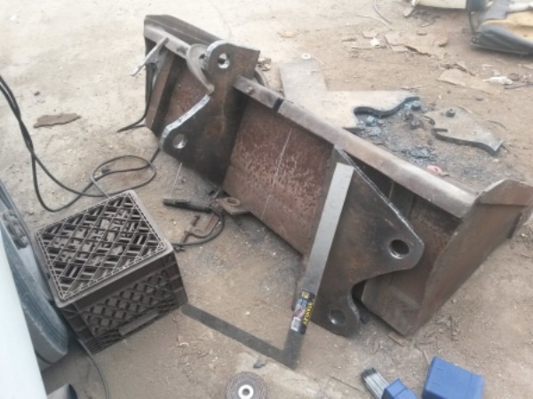

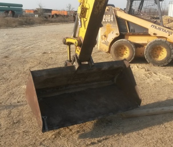

    Recently my good friend had to rent a mini excavator but it only came with a 24" toothed bucket and the job he was on would have taken forever to complete so I took a 5 ft skid steer bucket, removed all of the teeth and made mounts to convert it to an excavator bucket
    The nice thing is it will also fit my Ford 750
