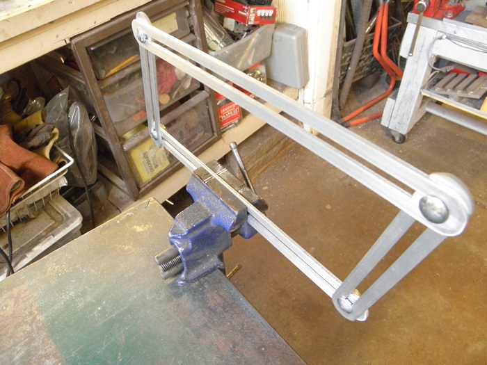

EZ PATTERN MAKER

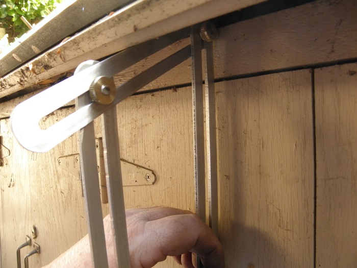

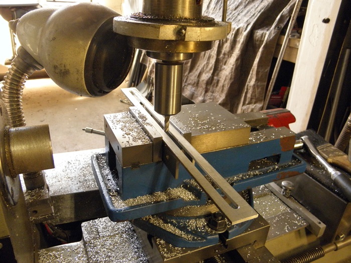

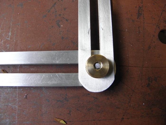

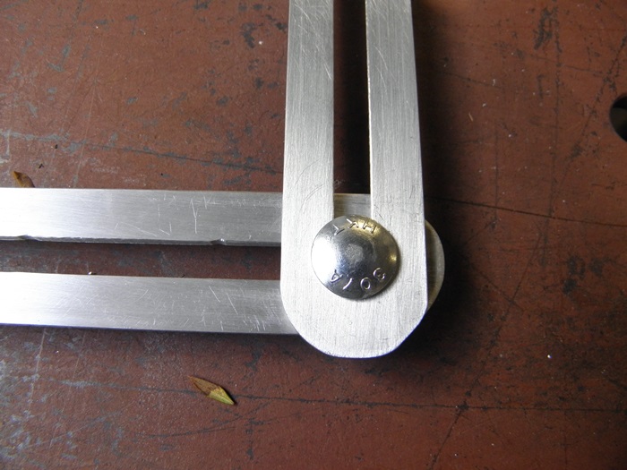

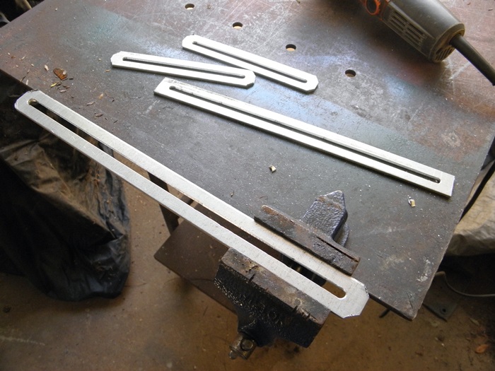

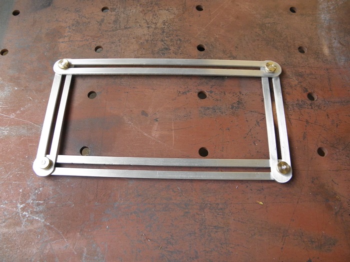

EZ PATTERN MAKER. MADE FROM ALUMINUM , BRASS FINGER WHEELS AND 1/4" STEEL CARRIAGE BOLTS.
THIS IS A FOUR SIDED PATTERN MAKER. PUT IT UP NEXT TO THE AREA YOU WANT TO COPY ADJUST THE WHEELS AND TRACE THE RESULTS ON THE NEW MATERIAL FOR A PERFECT REPRODUCTION.

Very Nice Cap'n! Looks Real handy and looks like you could even change it to 3 sided! Love the light on you mill, it reminds me of the martian probes on War of the Worlds!! Thanks for sharing!! ~PJ
Hello PJs, Yes the light must be cleaned every aluminum job as it will spark like the dickens...:rofl:
Hum three sided new thought....:O) Thanks for your comment.
