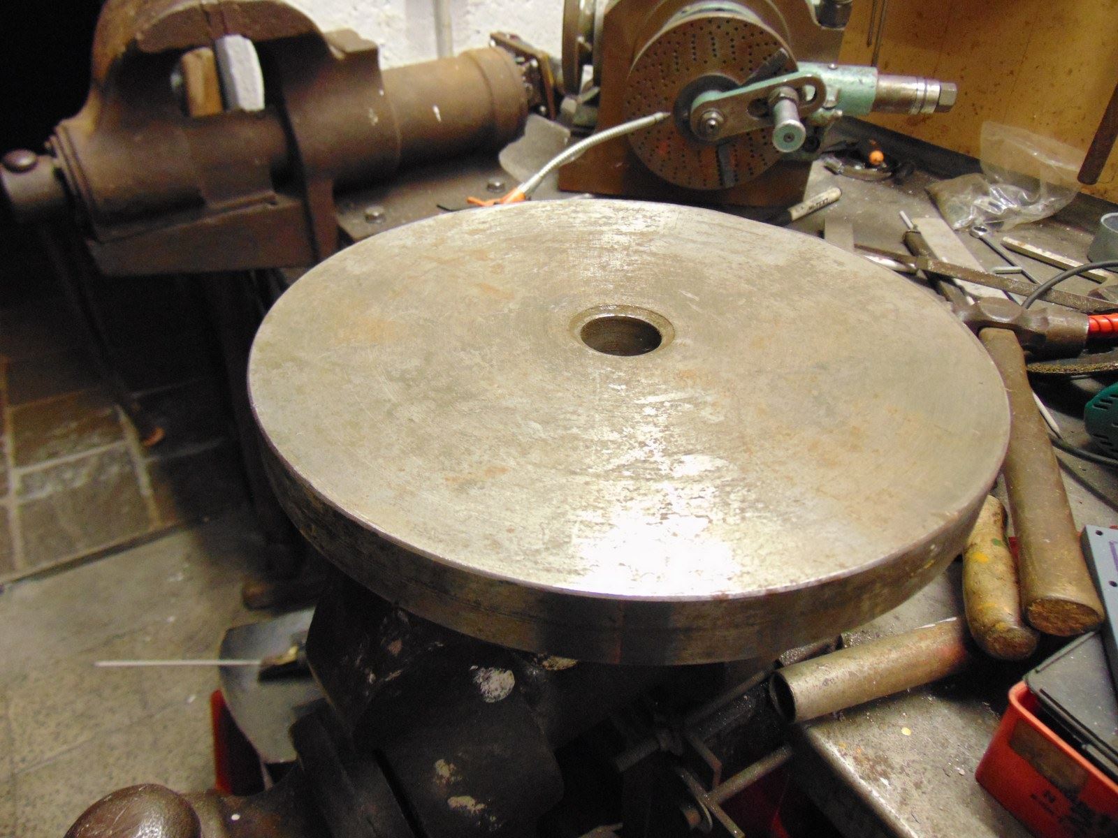

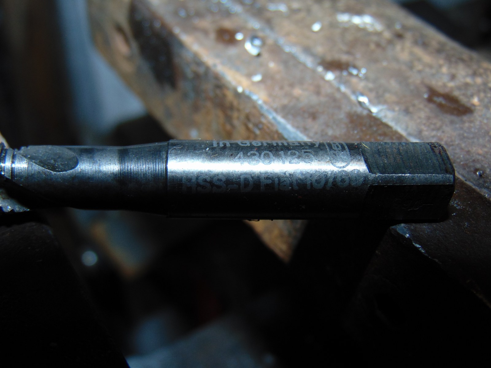

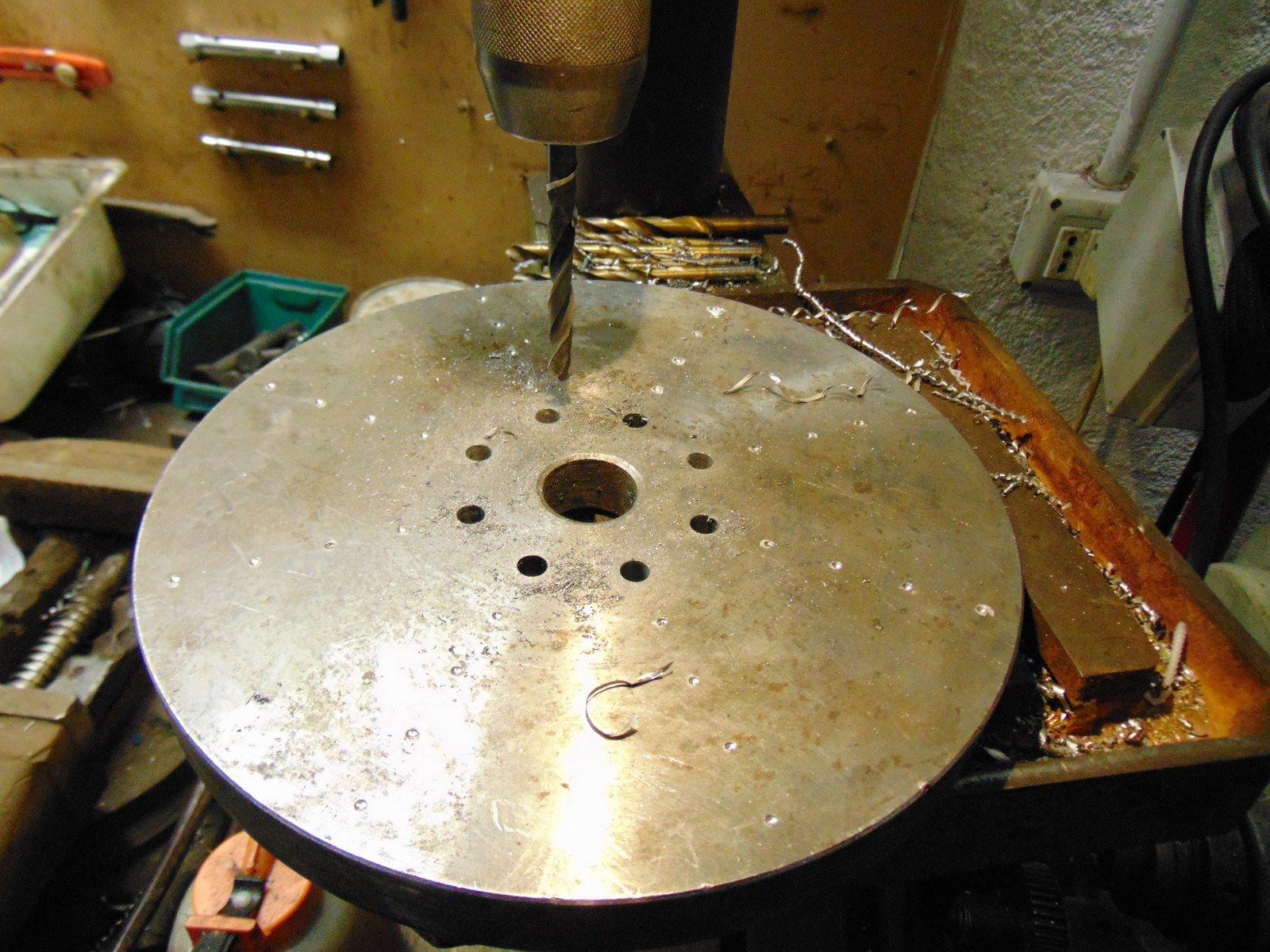

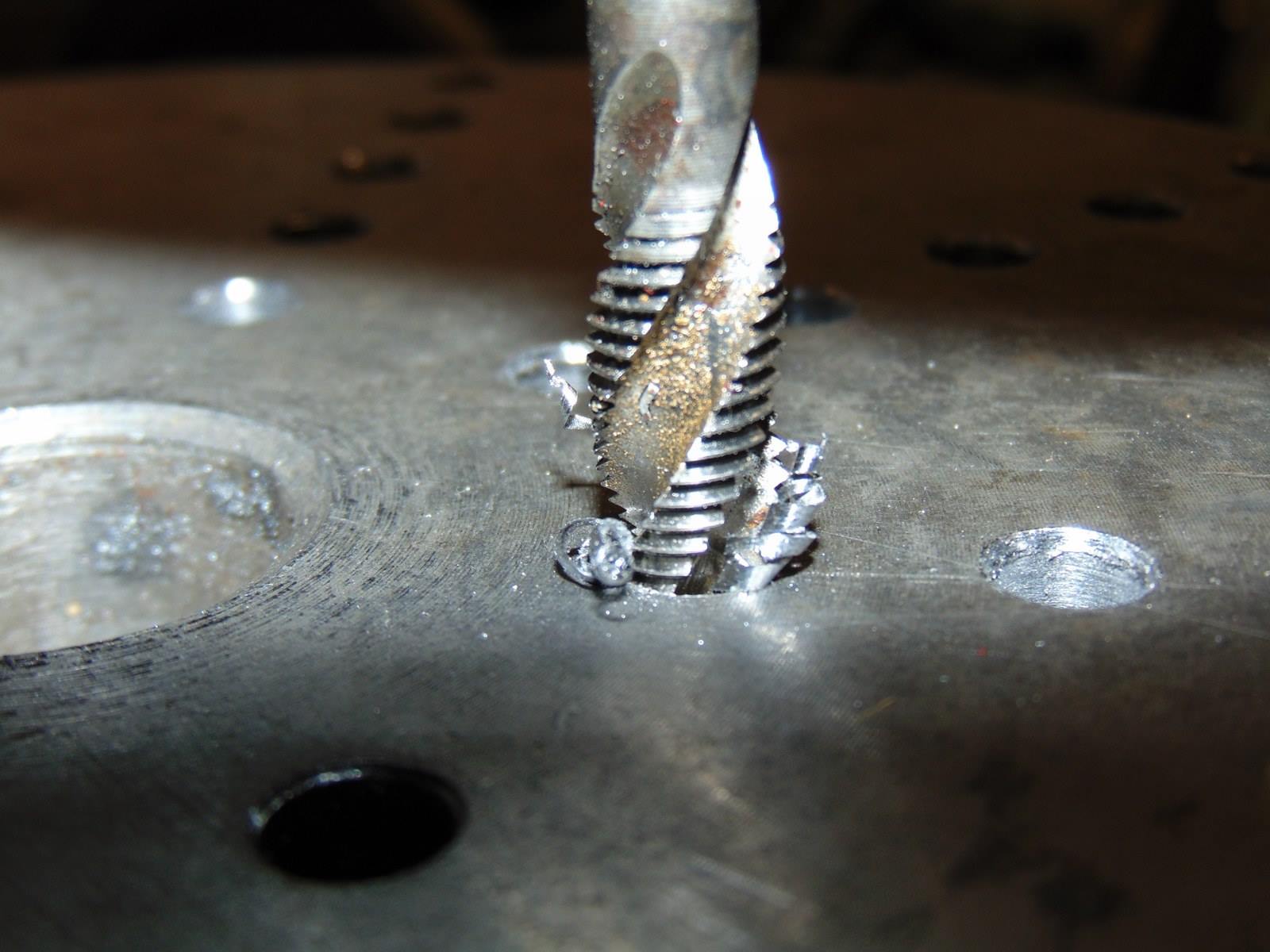

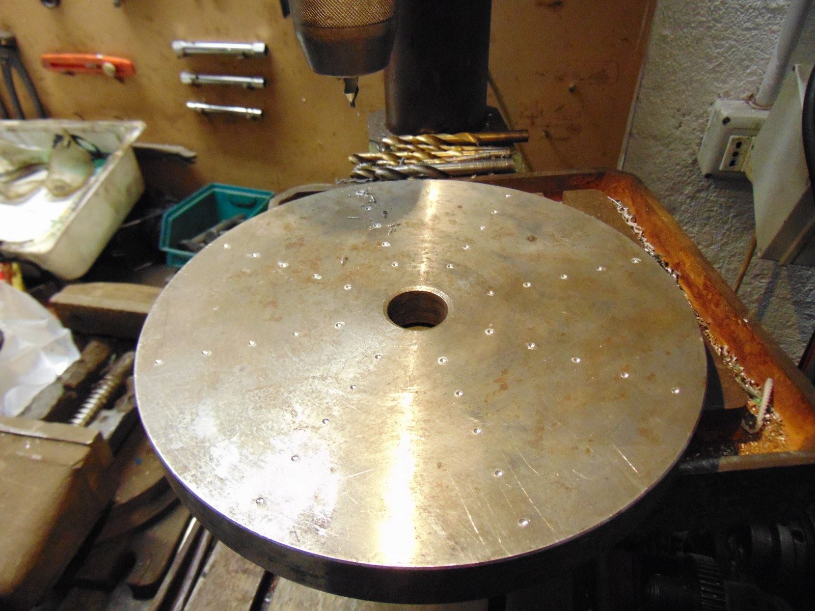

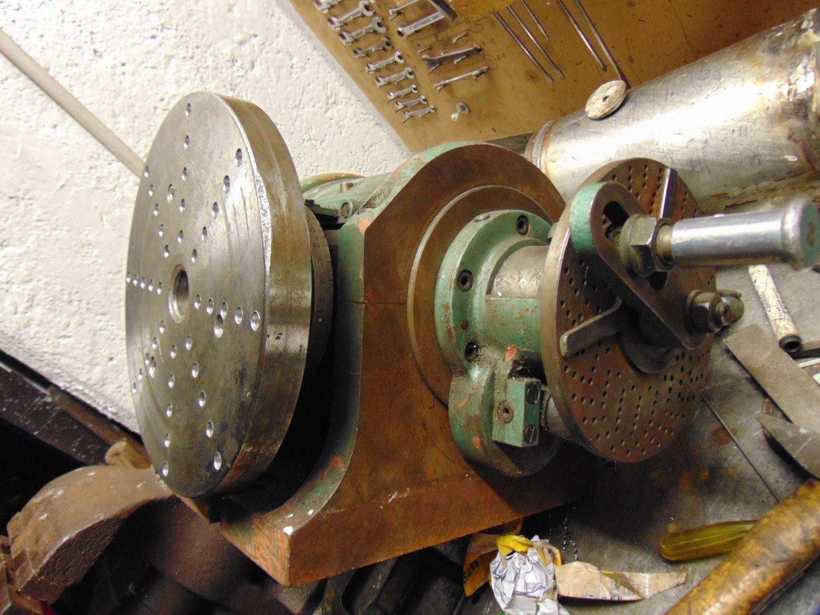

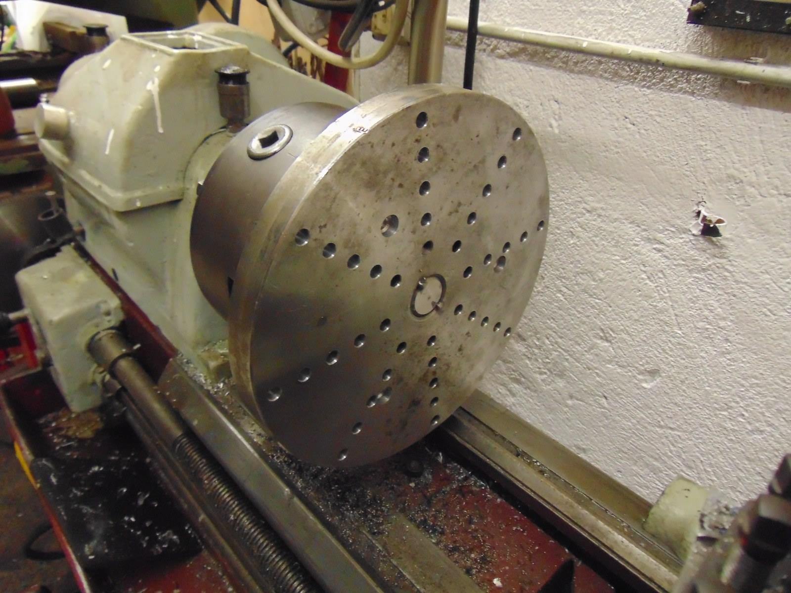

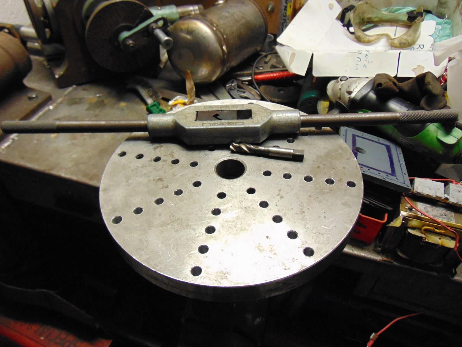

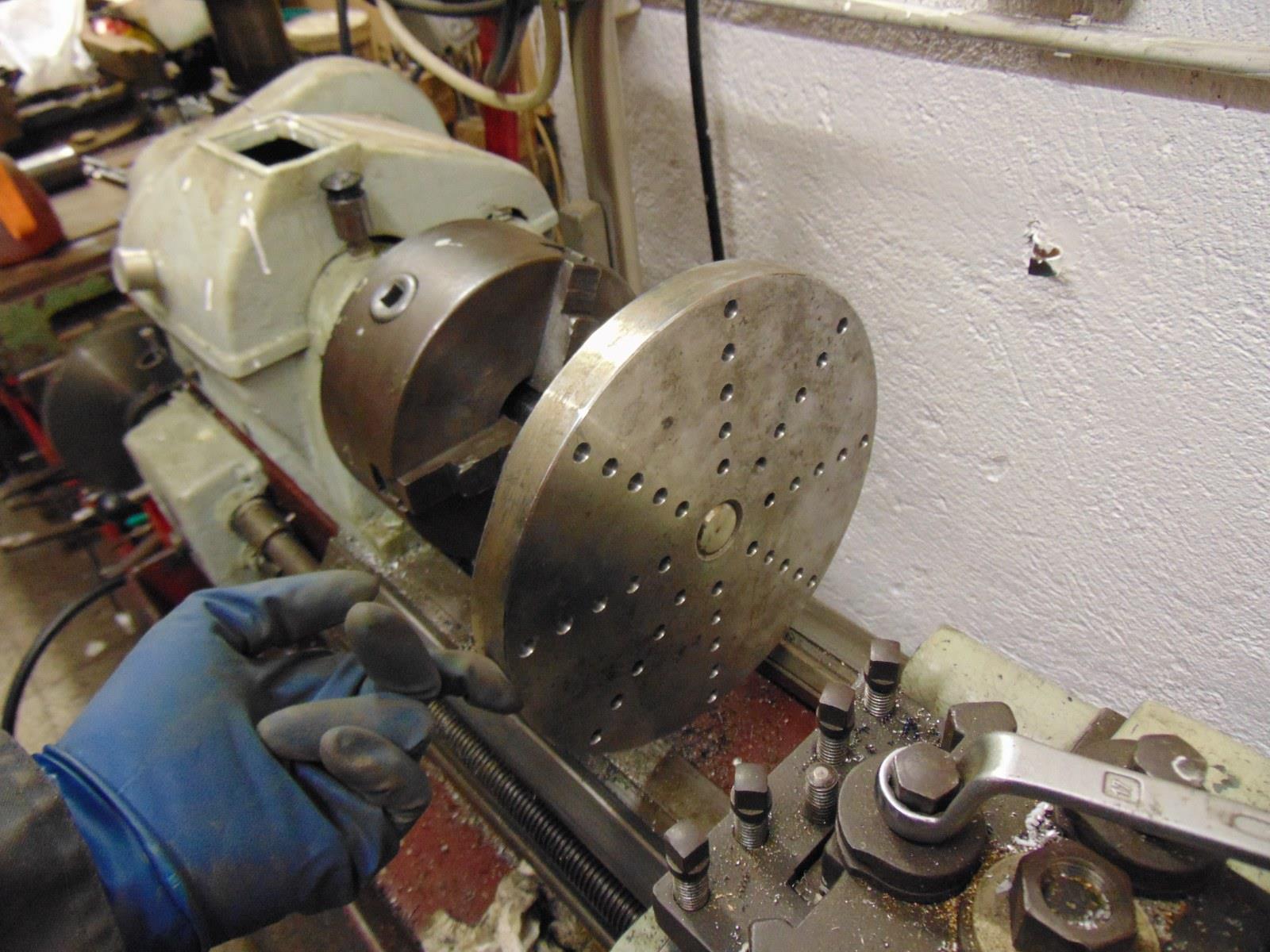

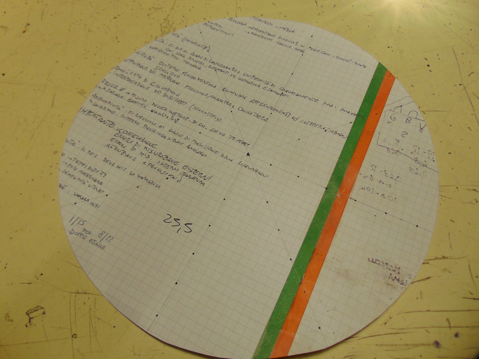

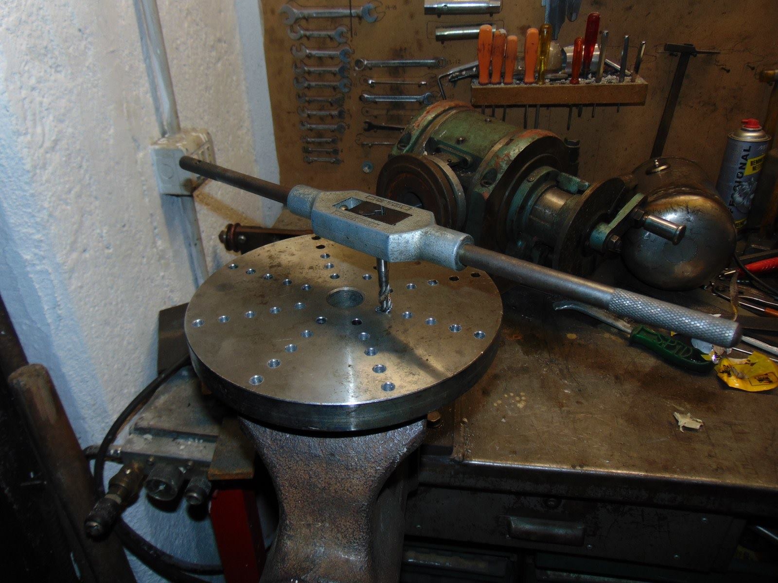

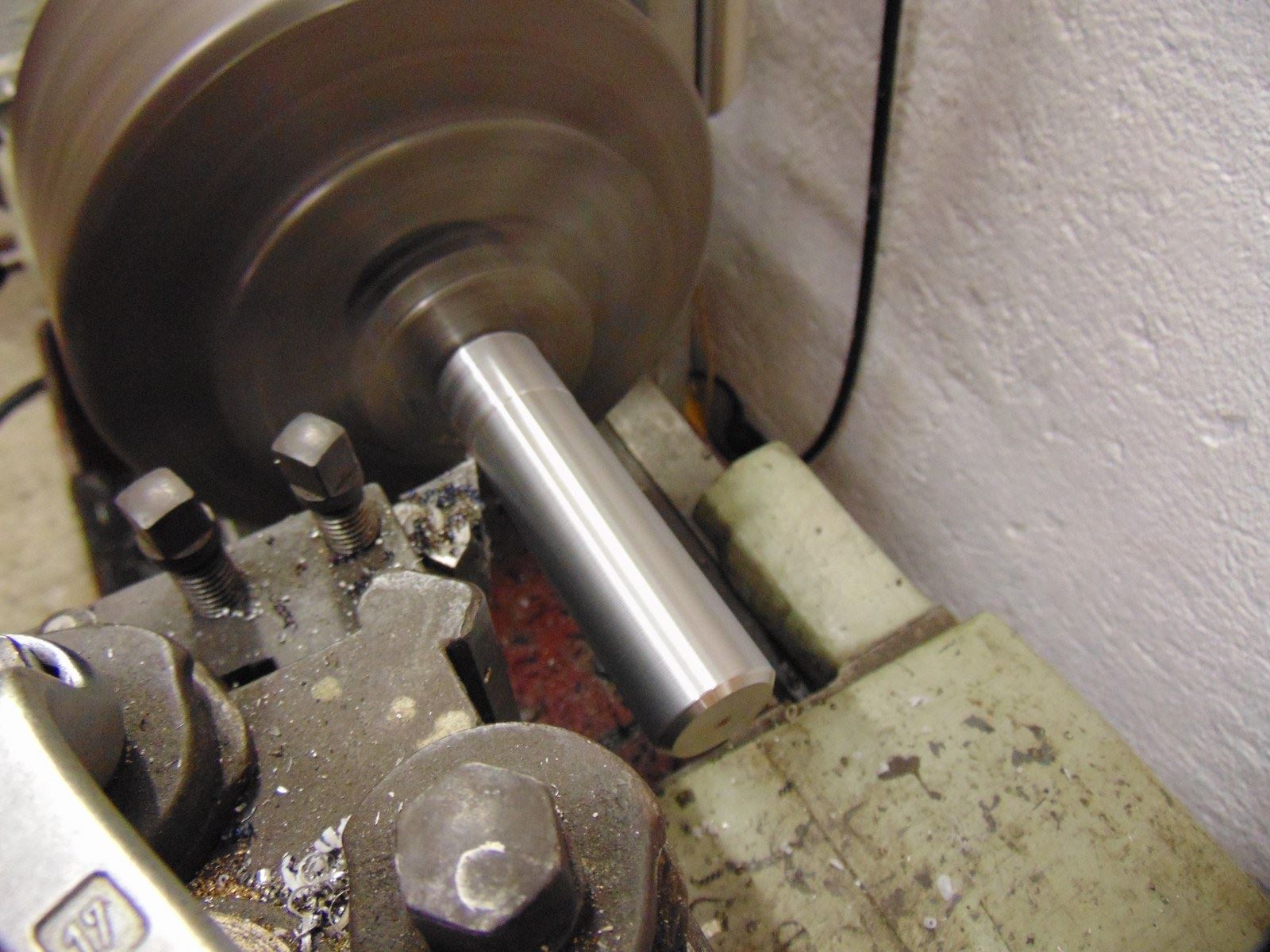

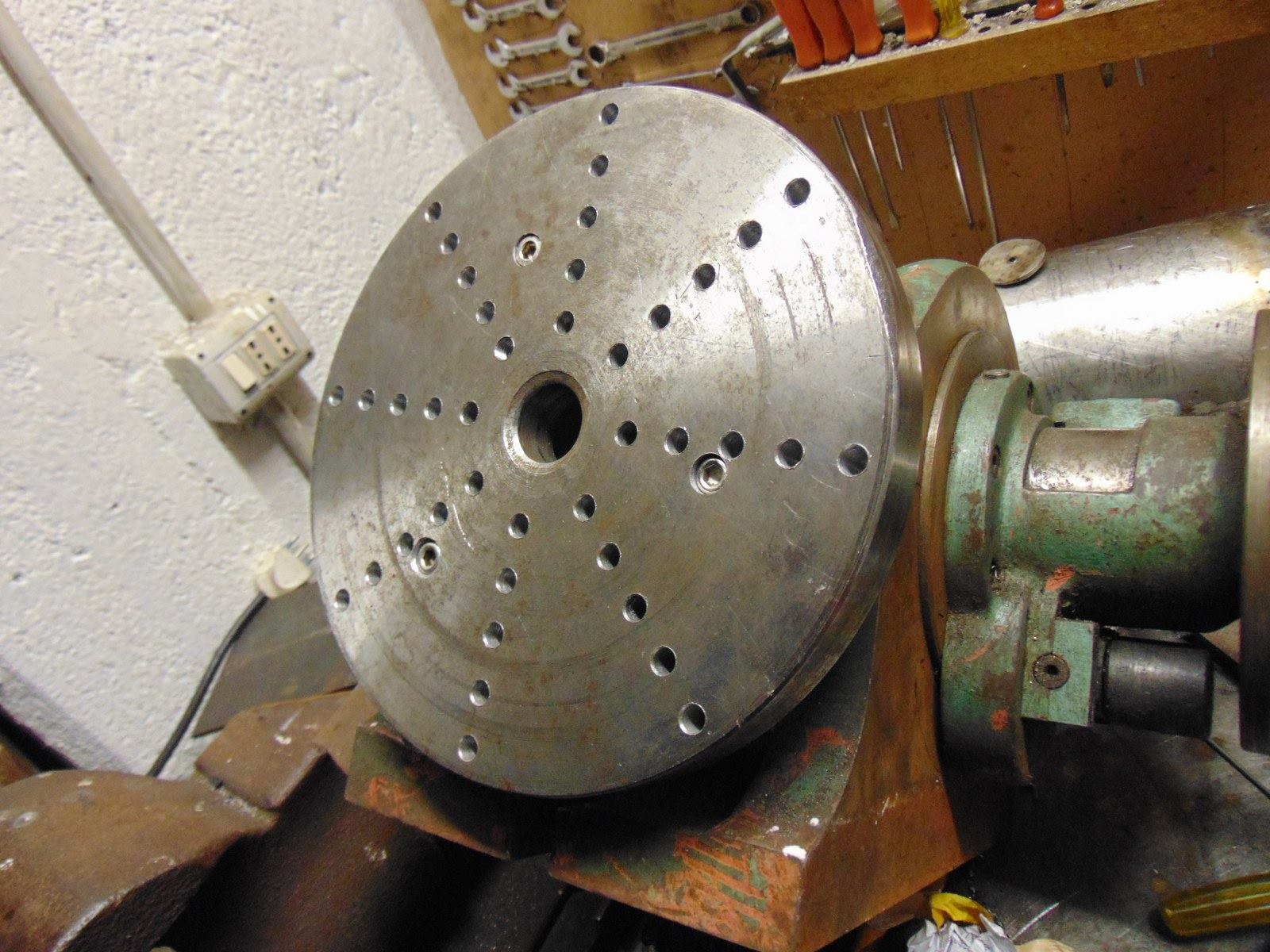

I decided to make a simple faceplate in order to complete some speaker panel I need for test.
It can be useful for large parts or strange shape.

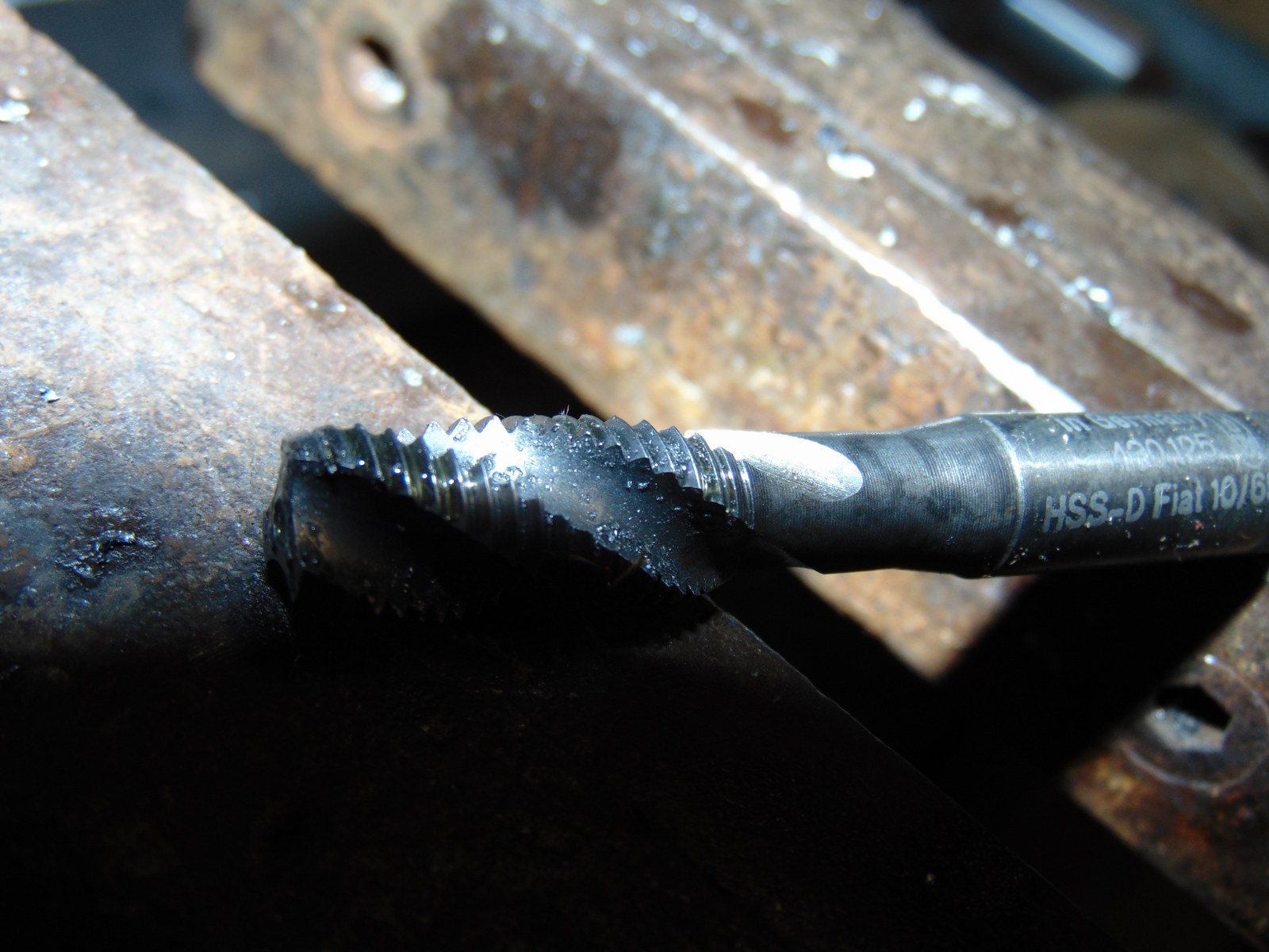

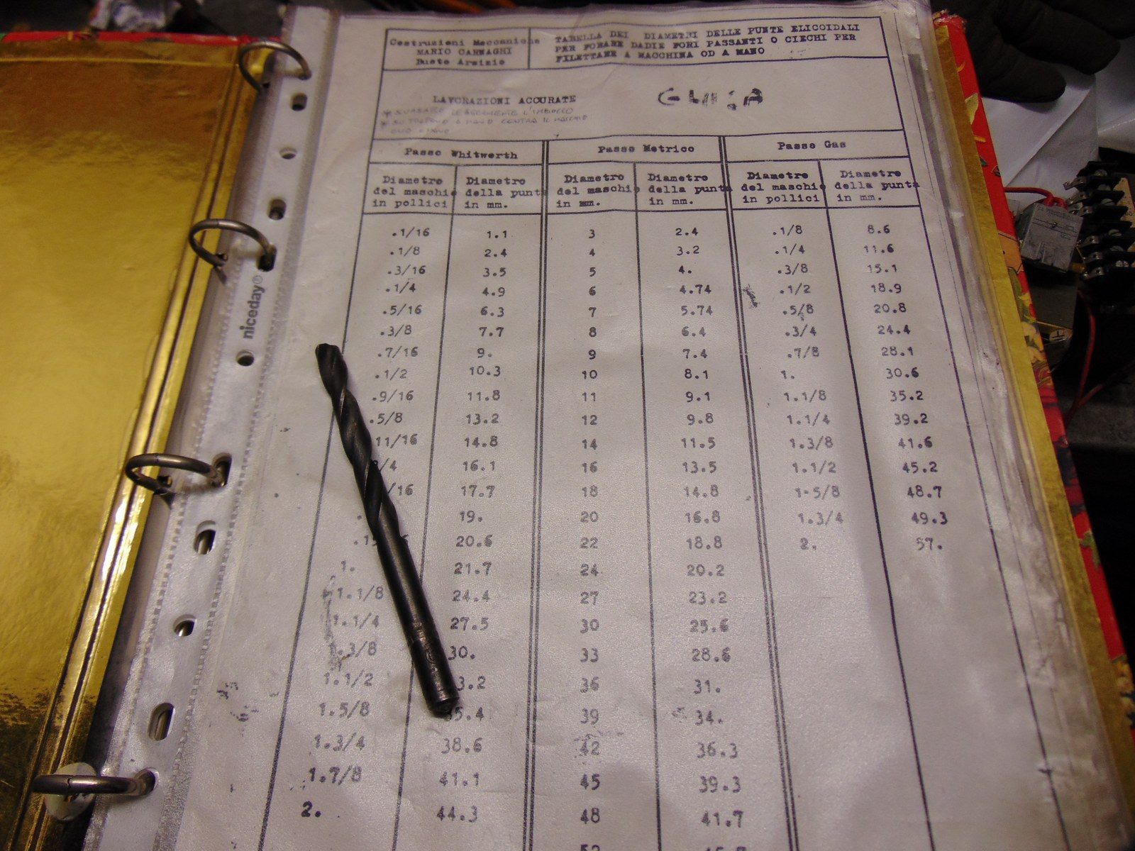

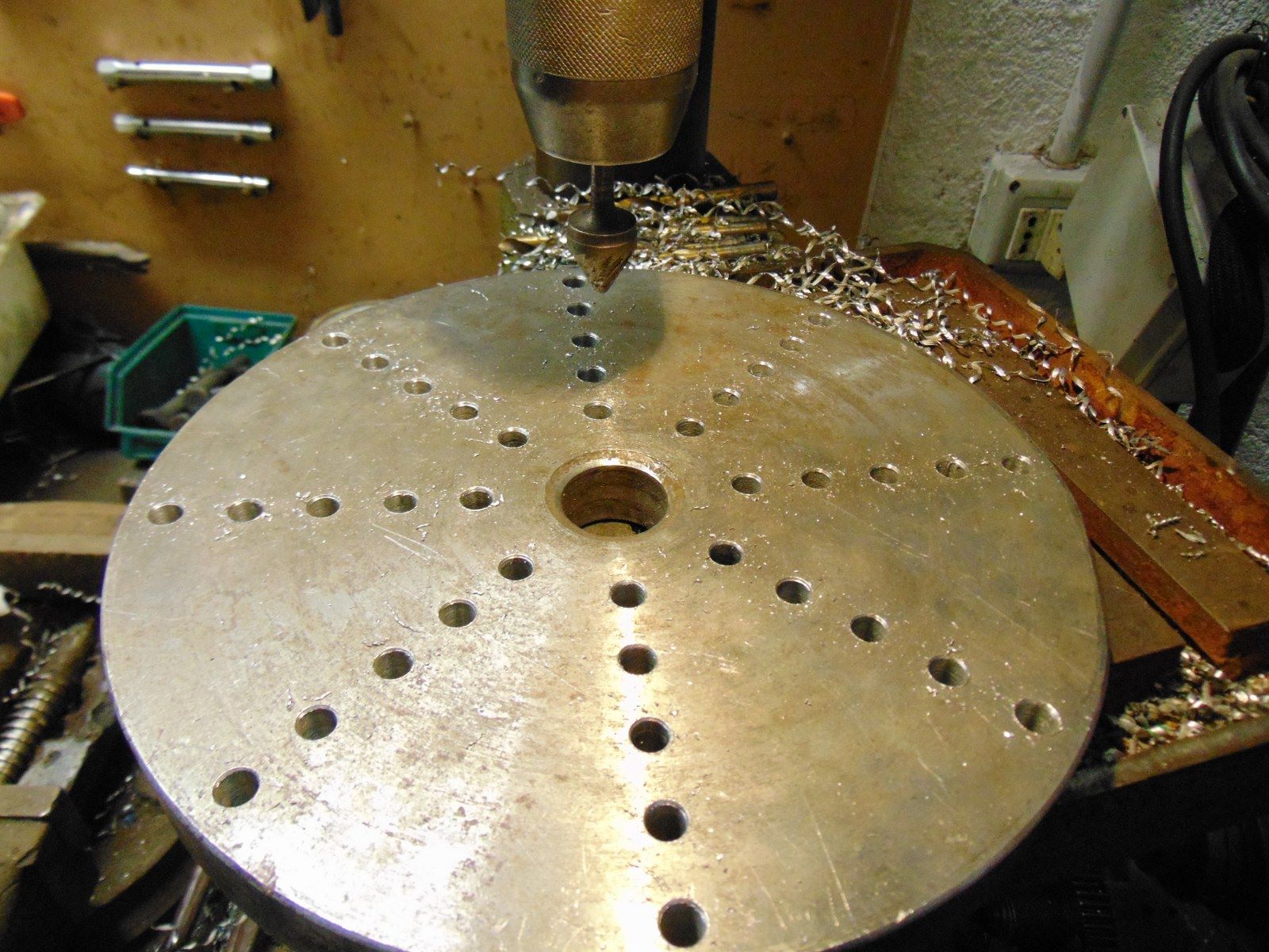

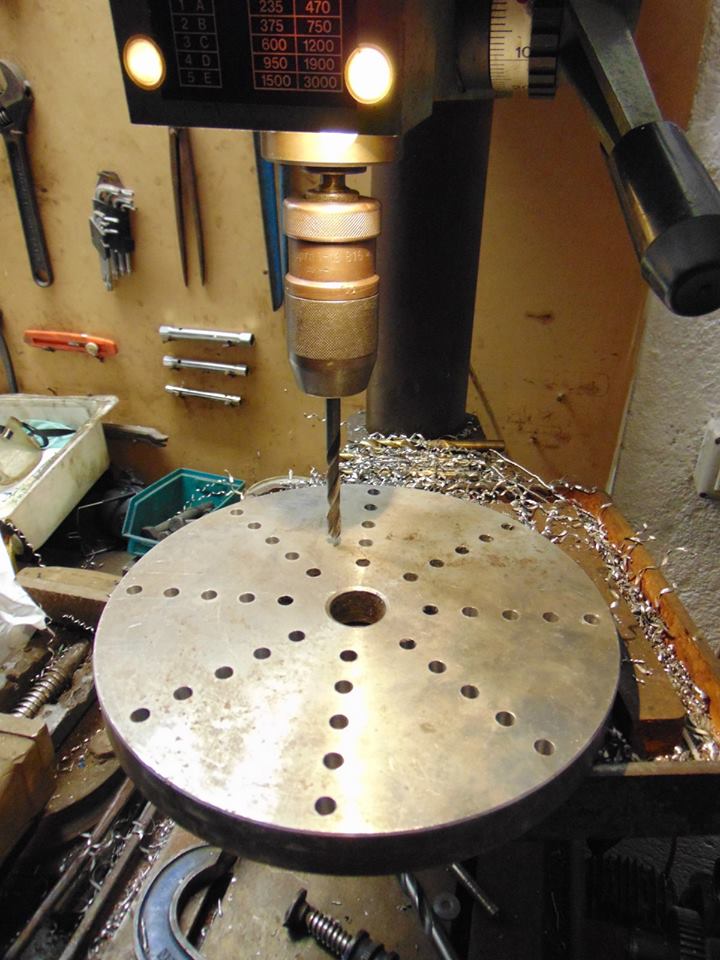

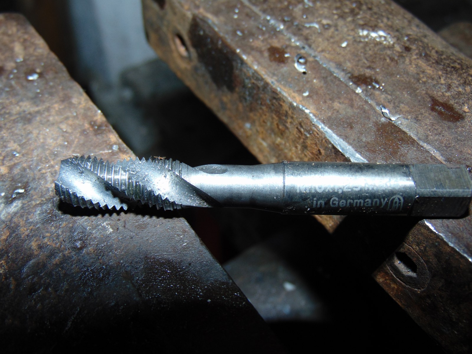

Size is 255mm diameter, 25mm thick steel. I drilled 40 holes, 8,25mm for M10.
Attachment 21278 Attachment 21279 Attachment 21280
Attachment 21281 Attachment 21282 Attachment 21283
Attachment 21284 Attachment 21285 Attachment 21286
Attachment 21287 Attachment 21288 Attachment 21289
Attachment 21290 Attachment 21291 Attachment 21292
Attachment 21293 Attachment 21294 Attachment 21295
