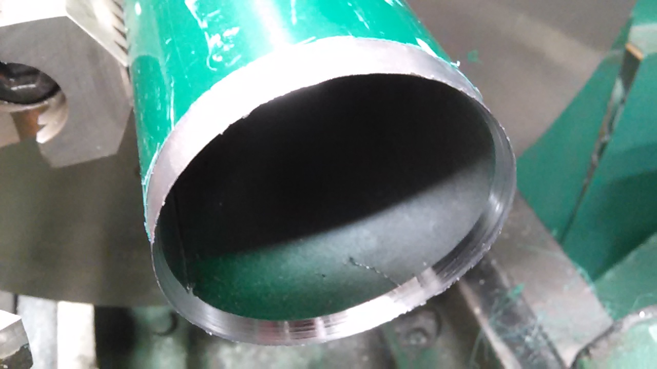

So I thought I could take a piece of the PVC pipe and machine a sharp edge on it, and cut the fiberglass. That was a bust, except I did figure out the angle to machine the 2" electrical EMT (electrical metallic tubing) conduit piece I had laying about. My initial attempt was with a 16 degree setting, and this produced too thin a section of material that could be rolled over easy.
I set the compound of my lathe to 25 degrees, and used a boring bar to cut the inside to this taper. I then put the compound back to 0 degrees, and cut the outside (mainly to remove the paint, it also improved the knife edge). I was able to push and rotate this into the fiberglass and cut a clean hole through it. I have a photo where I tested this on 3-1/2 inch insulation in the garage that does not have sheet rock on it.

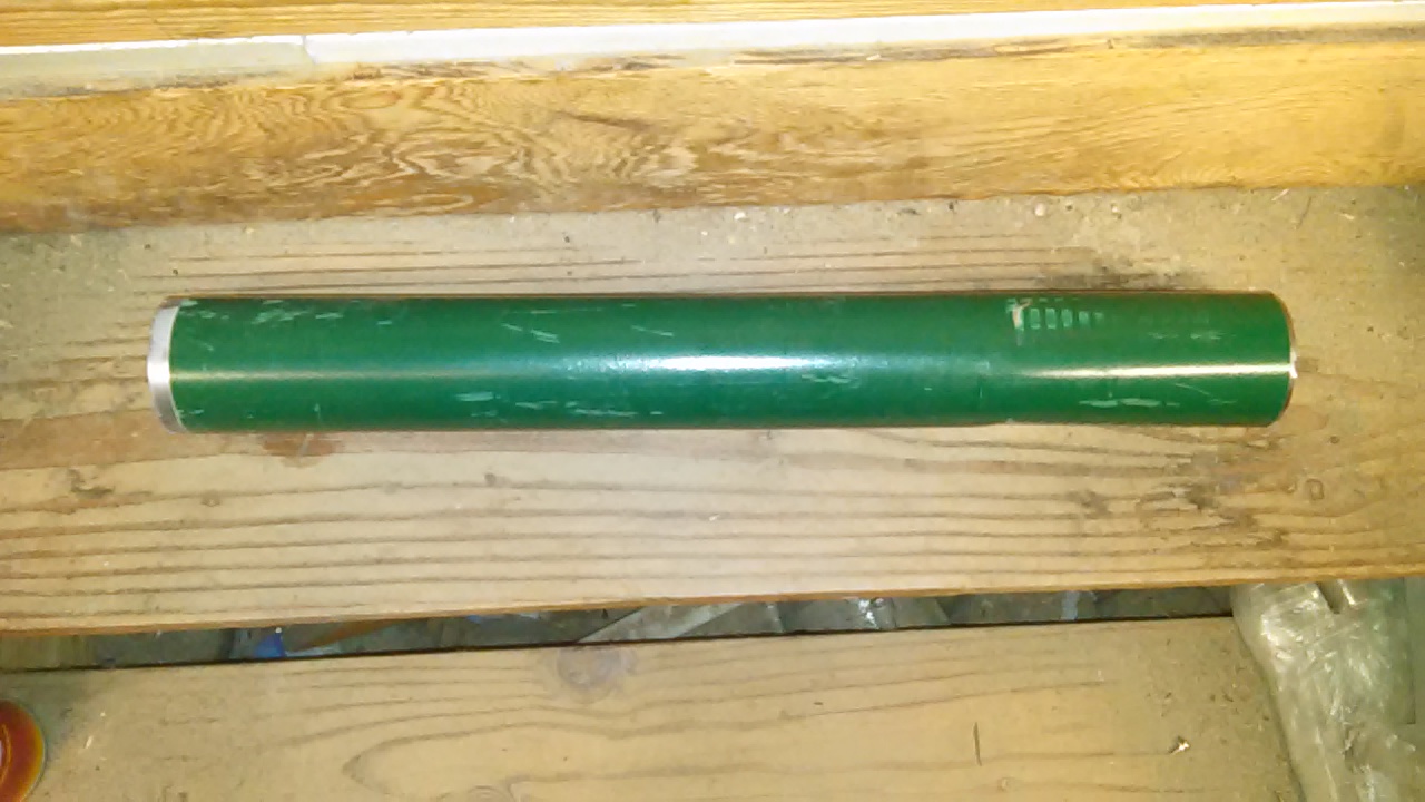

Attachment 32321 I found this piece of EMT laying along the roadside, someone had painted it green, here it is mounted in the lathe. The edge is not perfect and has a few jags, but mostly a sharp edge.

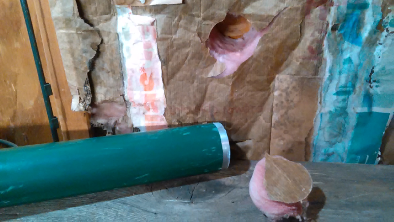

Attachment 32322Just a photo showing the cutters length.
Attachment 32323This is the test cut to show the idea. It did tear the kraft paper, but this insulation came to me used, and the kraft paper is very brittle.

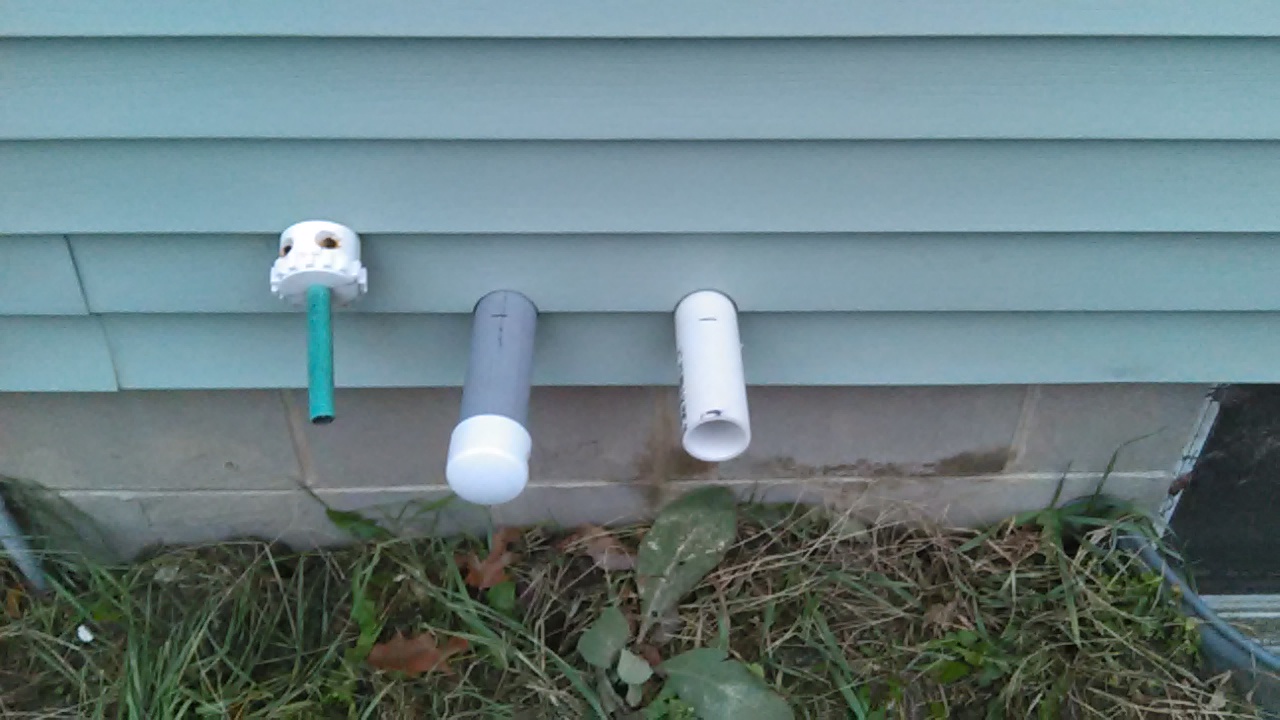

Attachment 32324This was where I cut the insulation for the 2 pipes for the furnace, via inserting the EMT through the drill holes from the outside. The odd garden hose with the weird clamp is for the sump pump hose discharge (a piece of scrap laying about the shop for 35 years).

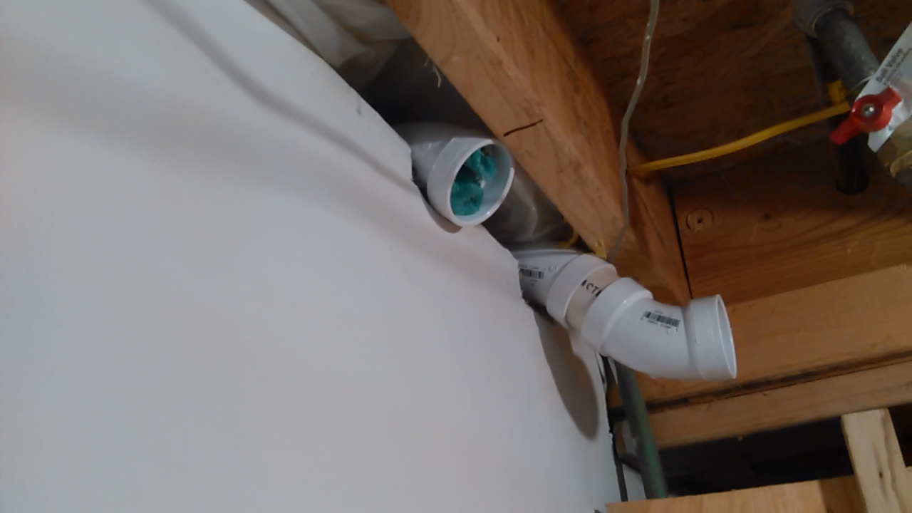

Attachment 32325Here is a photo from the basement view of where the pipes will connect to the furnace. It is a tight space to get my hands into, as the block wall is 8 inches, and then the thickness of the insulated construction is 5 inches, this is 1 inch of rigid foam insulation, and a 3-1/2 2x4 wall with 1/2" drywall (I like to over insulate). So the opening where the fiberglass insulation bat is, is tough to work on. And I could not think of any way to pierce a hole in the insulation.
It worked good enough that I don't need to get a tool post grinder out to make it sharper. The real problem with using EMT, it is not perfectly round, and certainly not tool steel.
