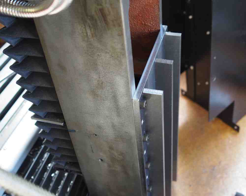

Whilst fitting the DRO you will have seen that I created a space between the column and the power supply case.
Enough space for a bracket.
And so I created a Sieg SX2.7 stiffening bracket
Attachment 39730
This has increased the static stiffness by 1.5x :lol:

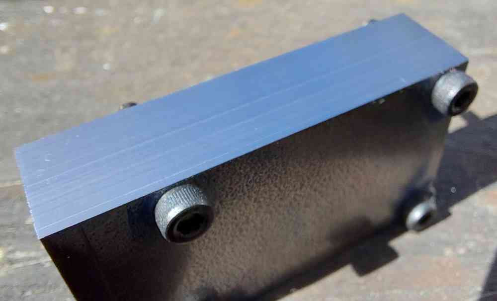

Mill Stiffness = Top Finish is definitely true, I made this end mill cut on 2 off 1/4" thick mild steel plates bolted together. I can feel that the vibration on the column is significantly reduced with the bracket fitted and when making this type of cut.
Attachment 39771
