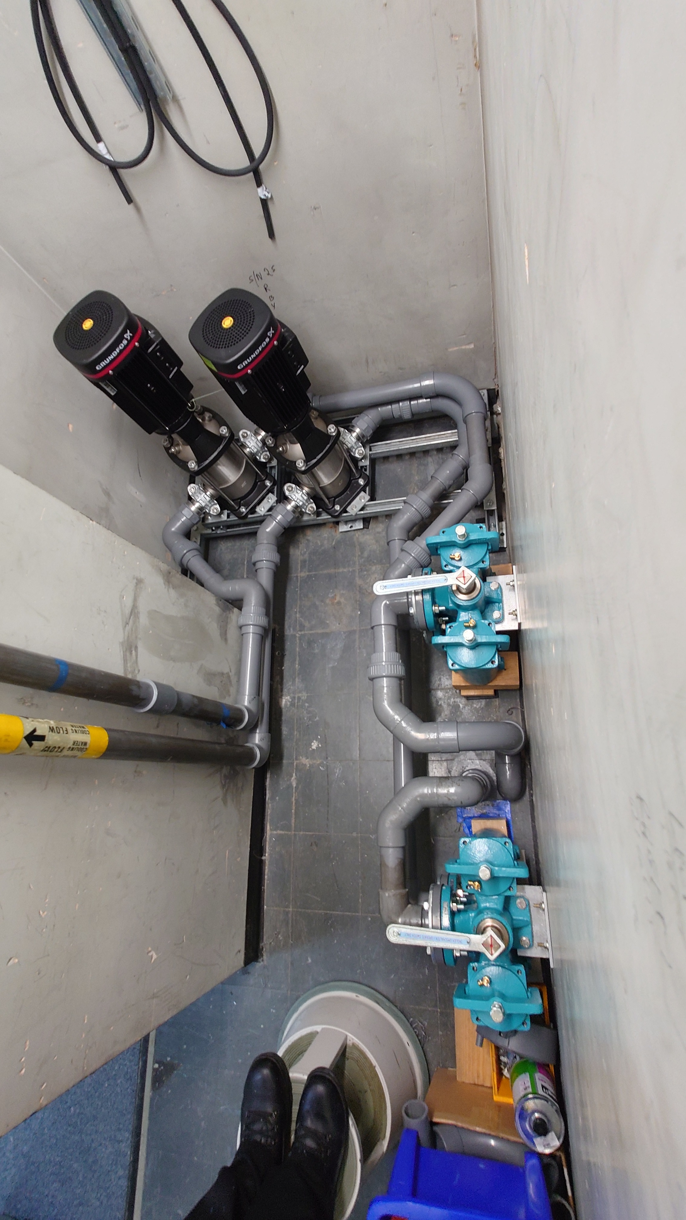

    I wonder just how good those melt together joints are? When jointing PVC or ABS systems we have to solvent clean the extrusion lube wax off both the tubing and the fittings...Fitting a PVC pipe elbow - GIF-46.jpg A recent replumb I had to design and install in another building, from original floor stubs to rising lines with new pumps and additional change over filters, mainly solvent cement jointing, floor tiles are 6" square, pipe is 2" nominal bore for scale.
