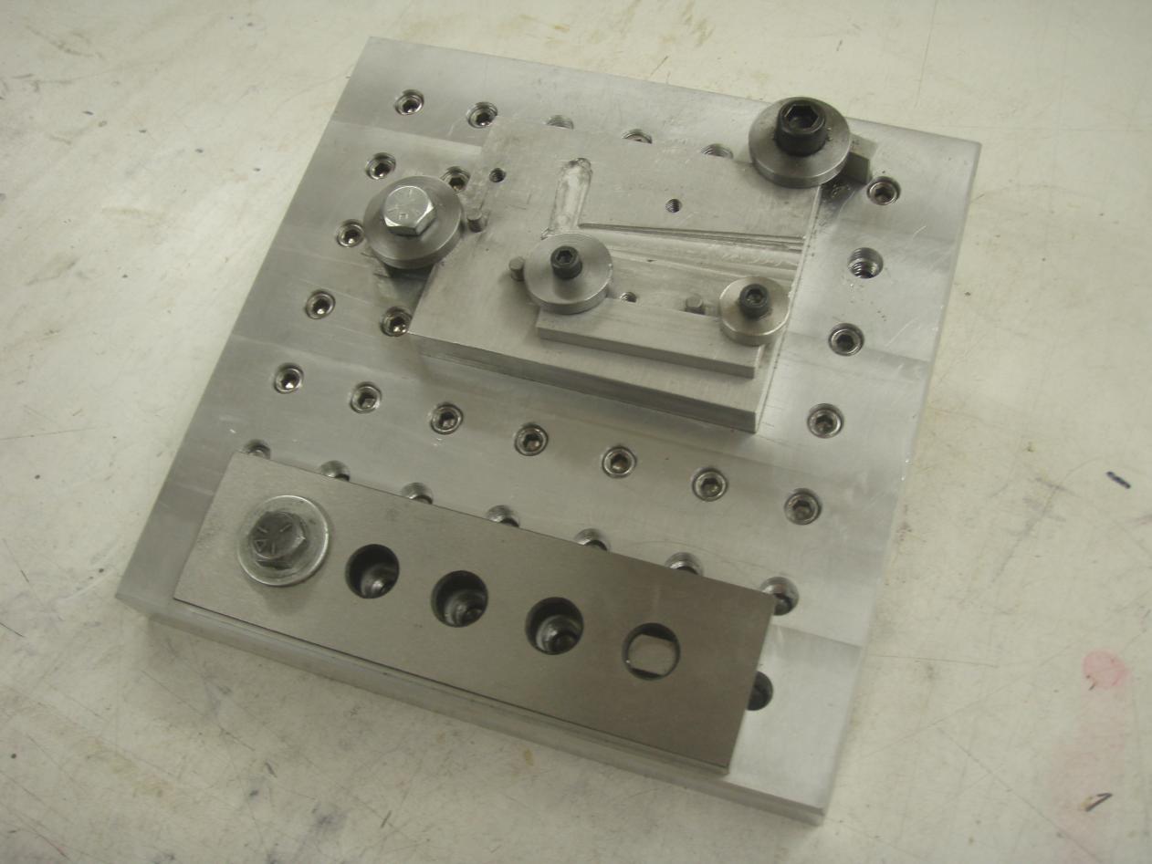

Fixture Plate
Fixture Plate 1" x 8" x 8", 6061 Alu., 3/8"-16 Threaded Grid. I made this fixture plate to fit my Kurt Vise. This is the setup of the fixture I used to mill the Angle Plate sets. I used the 5" Sine bar and the mounted parallel to set the angles.
