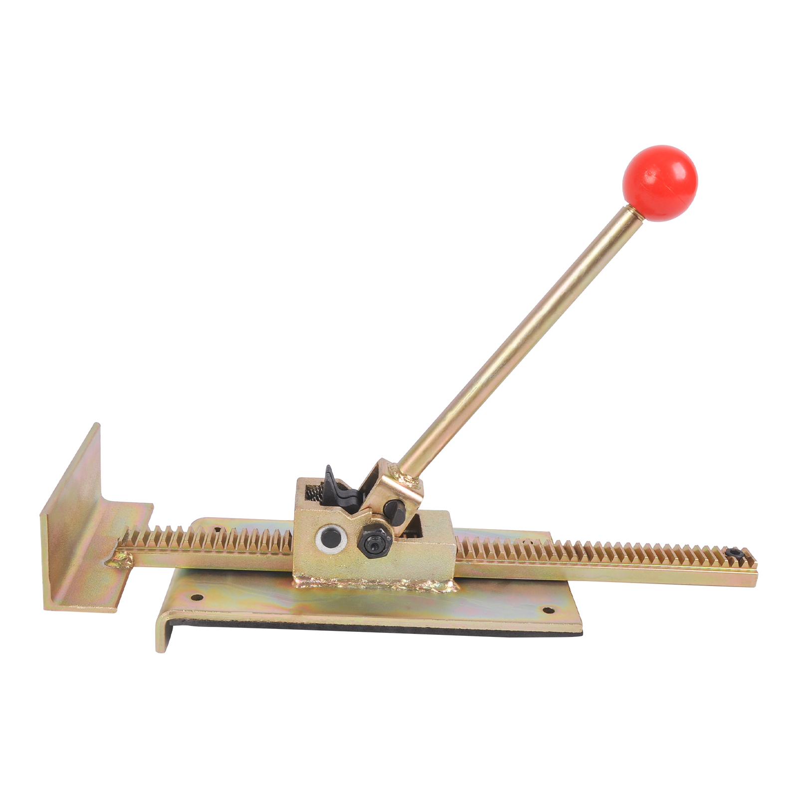

Also another tool is a flooring jack to tighten boards that are warped or near the wall where it's difficult to get them together tight, and using a finishing nailer to complete the courses as the nailer has limits how close you can get to the wall.
Attachment 44492
surely those boards are just pre laid out for fit, because if they are already nailed down that floor won't last anytime at all I also see a few that require trimming to length to get rid of bad ends and split off pieces
