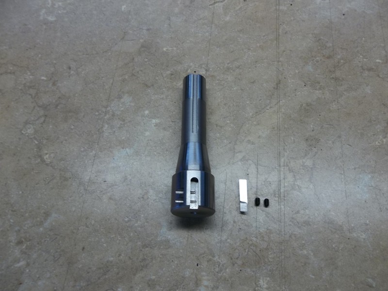

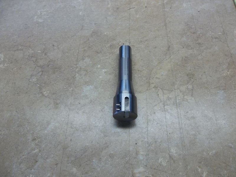

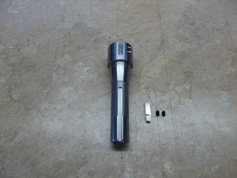

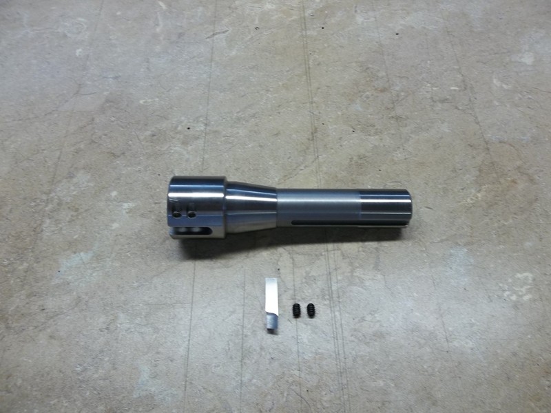

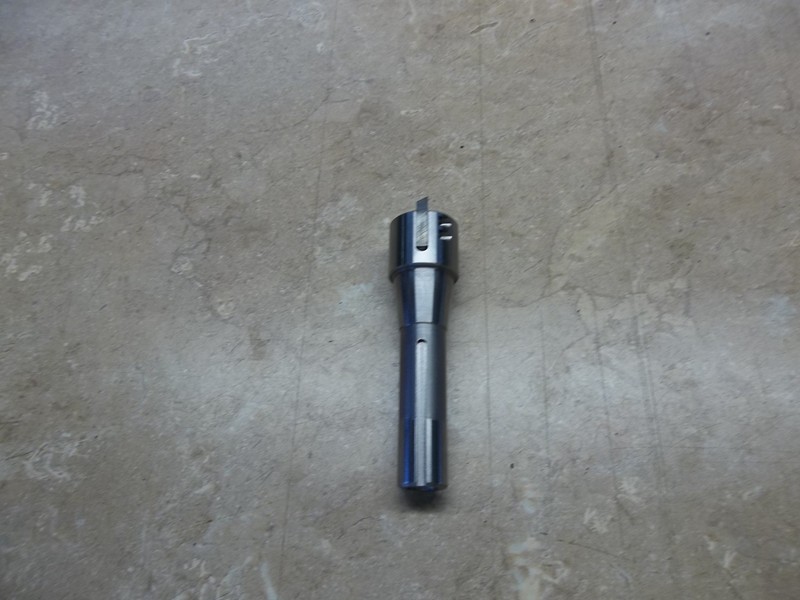

Made this little fly cutter with an integrated R-8 shank, It's made from 1.500" round 4140 steel, pre-heat treated to a 27-32 RC. It doesn't have an adjustable cutting diameter, It's a fixed 1.500" diameter which is plenty enough for me, I have adjustable ones but they make such a large cutting diameter, It holds a 1/4" high speed steel cutter or carbide, This fly cutter will save on end mills too.
When I drew this up in cad I drew it up as 1.250" round, But when I went to my steel rack all I had was 1.500" round, I wasn't about to turn it down so I left it at 1.500", But I didn't change the cad drawing, never the less it wouldn't make any difference if it was 2.000" or what ever, the measurements would not change.
Below are some photos
