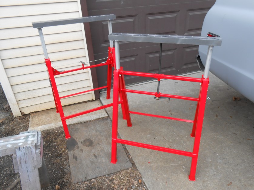

Folding Metal Saw horses (2 versions)

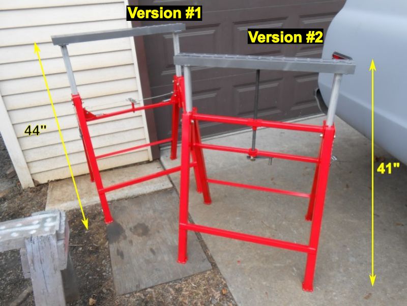

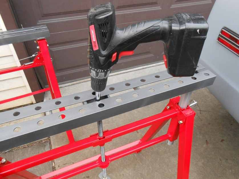

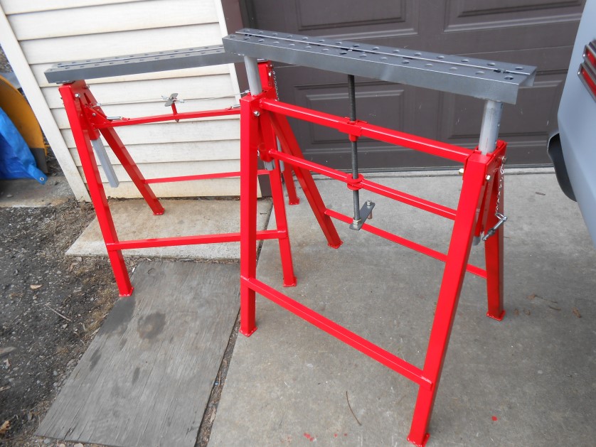

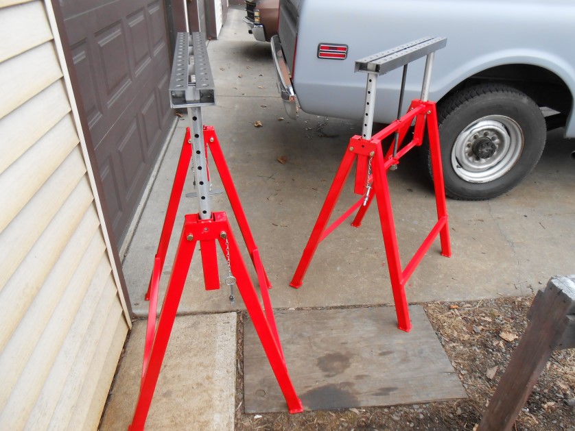

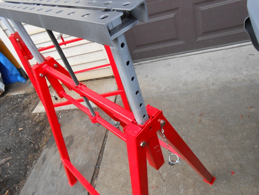

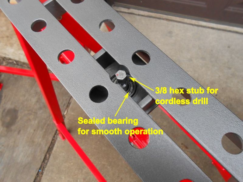

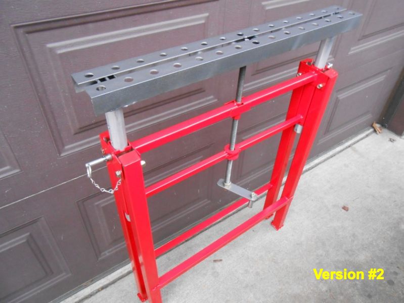

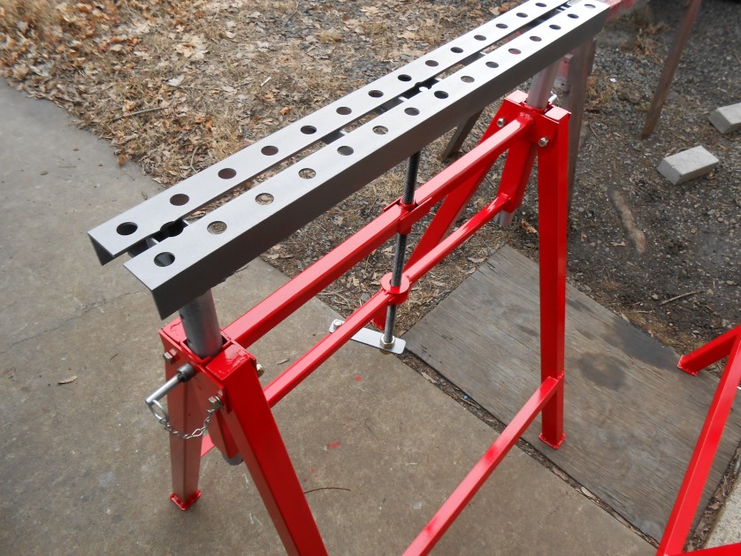

I designed these saw horses to be both fold-able and adjustable for height. I've created 2 different mechanisms to make things interesting but both saw horses share many things such as; 2 inch on center 16mm holes in the tops to match my welding table (so accessories can be used between then if needed) Both saw horses fold up flat for storage when not in use. The main frame on both are made from 1-1/2" 14 gauge square tube steel with 1-1/2" x 1/8" angle for the tops. Both are decked out in Rustoleum Gloss Cherry red and Hammered silver.
Now for the differences...

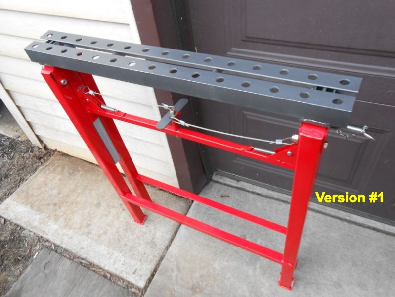

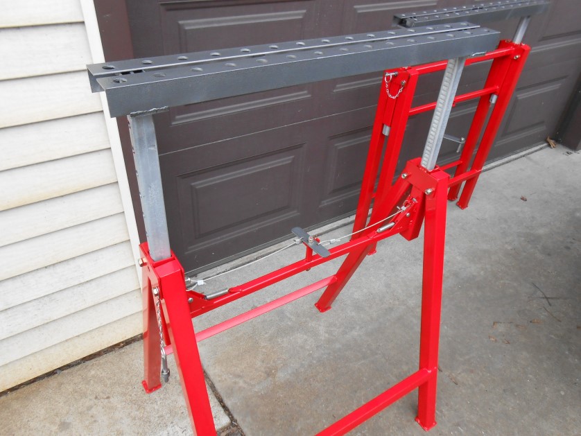

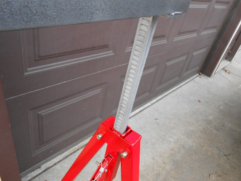

Version 1:

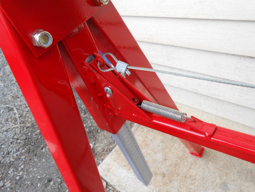

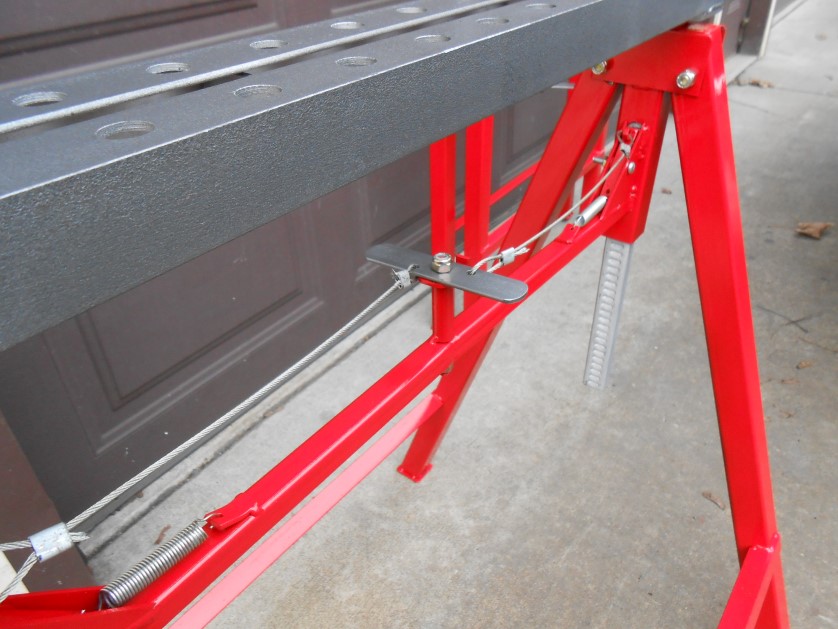

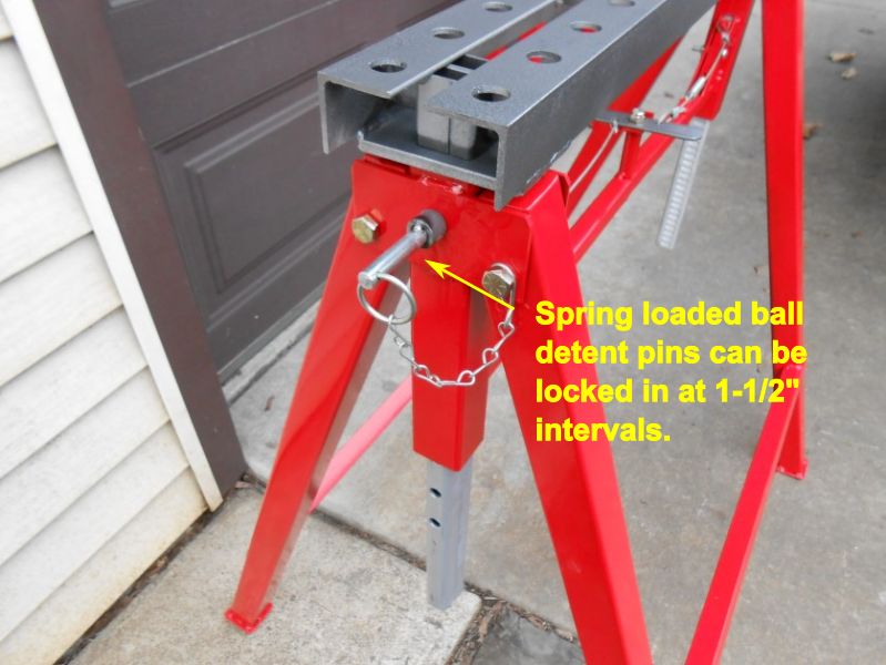

This saw horse uses the post from an old car bumper jack. I cut the post in half and mounted them upside down so the "teeth" lock with downward pressure to support any heavy load. I made 2 spring loaded square pins that engage with the grooves in the post. You can pull the top up and the pins will ride over the grooves to the height you want.(makes a neat ratchet sound too-lol) To adjust downward, just rotate the center handle slightly which will disengage both pins.
I've also installed spring loaded detent pins for each side in the event you want to lock this more securely for very heavy loads. Holes are 1-1/2" on center. This saw horse goes from 32 inches up to 44 inches.
Attachment 33670Attachment 33686Attachment 33672Attachment 33673Attachment 33674Attachment 33675Attachment 33676Attachment 33677Attachment 33678
