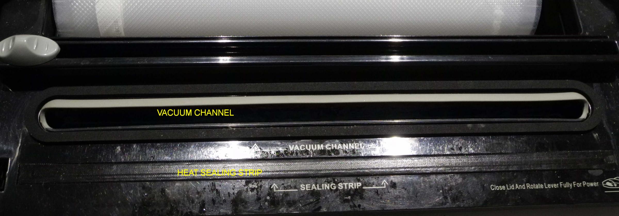

A Foodsaver, using vacuum sealed bags, can save a lot of food. Food thus packaged seems to keep for a very long time in the freezer. But the bags are a bit pricey, and the Foodsaver wastes about an inch of bag material in the gap between the vacuum channel and the heat sealing strip. In normal use, the machine won't evacuate the bag unless an edge of the bag is in or at least over the vacuum channel. They probably make more money selling bags than they do selling the machines that use the bags.

This is particularly wasteful when I re-use bags several times, just cutting off a seam each time, taking out some food and then re-sealing the bag.

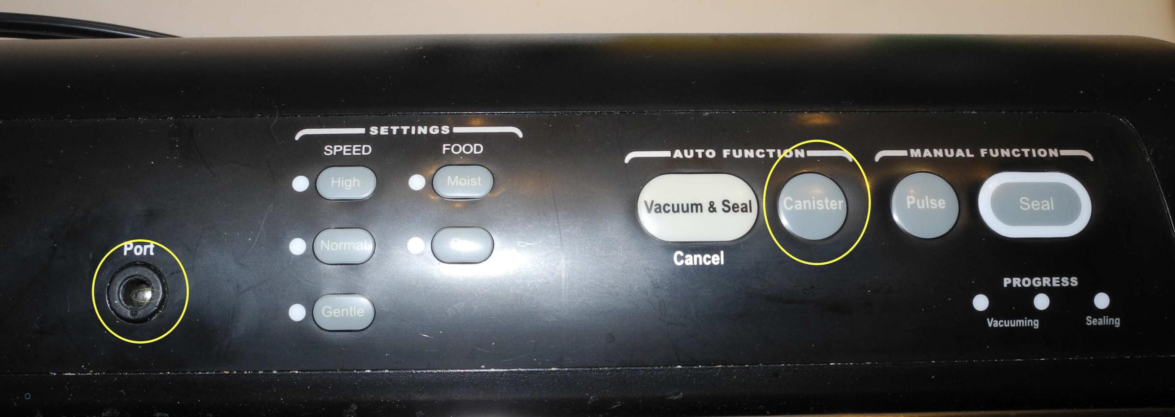

But the foodsaver also has a "port" with a vinyl tube intended for evacuating cannisters.
Attachment 34399
When the vinyl tube is plugged into the port and the cannister button is pressed, the vacuum pump sucks air thru the tube.

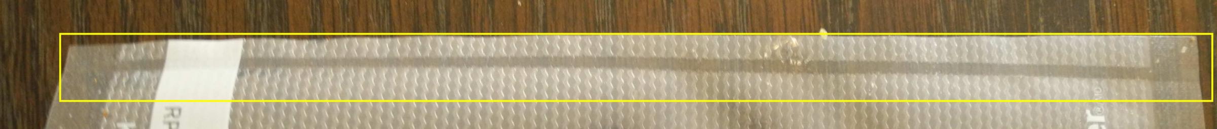

I use this to save bag material. When I'm ready to re-seal the bag I weld a seam very close to an edge. No vacuuming done to this point.
Attachment 34400

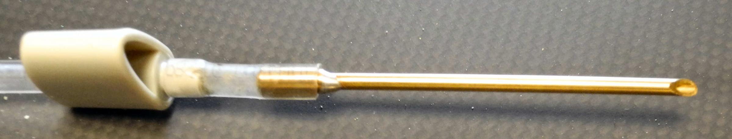

Note that very little bag material is used here. Then I use my homemade tool: a hypodermic-like needle made from 1/8" OD brass tubing, attached to the vinyl tube that is plugged into the Foodsaver's vacuum port. I silver-brazed a short piece of 1/4" brass tube to the end of the 1/8" tube to form a vacuum-tight fit in the vinyl tube that came with the machine.

I slip the needle thru one side of the bag near a corner of the bag and push the cannister button. The vacuum pump starts. When the bag is sufficiently evacuated I stop the pump. This works so well that if I don't stop in time it will suck a piece of bread so flat it looks more like pie crust -- which won't make very good sandwiches later. I don't re-use bags that stored uncooked fish or meat, but it works great for things like bread, vegetables and cooked food. If there is any question about safety, I can sterilize the contents of the sealed bag using the UV-C germicidal ultraviolet light I previously posted here for keeping cheese free of mold in the fridge.

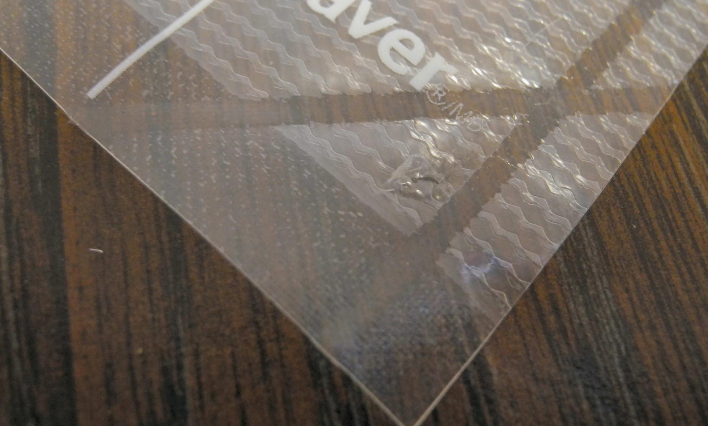

I then withdraw the needle with my finger over the "wound" to prevent letting air back in (is it possible to let vacuum out?) and then I seal the corner using the heat sealing strip.
Attachment 34402
