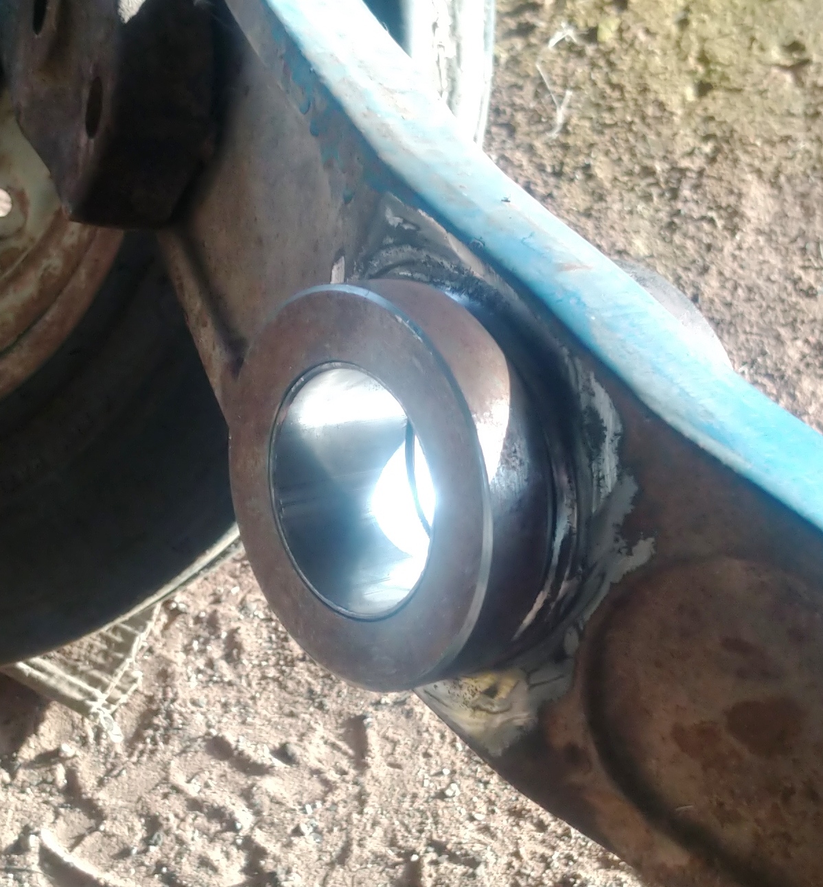

This tractor will never need to have the axle width changed to I opted to resolve the center pivot issue once and for all by welding a boss to both sides of the beam allowing me to use 2 center pivot bushings
I started out with a piece of turned drop that was near to the size already, it just needed boring out and parted in two.
Attachment 40720

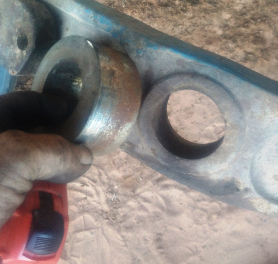

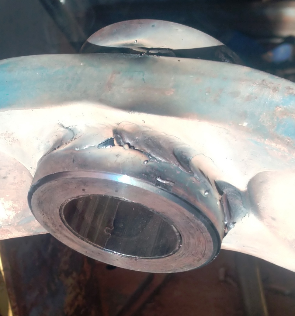

A little grinding to clean off the rust for welding the bushings are pressed in for alignment before welding
Attachment 40721
Attachment 40722

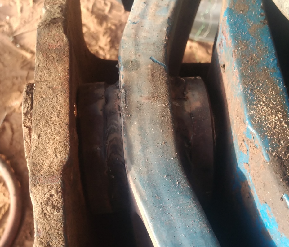

installed now there is very little space between the beam and the front housing the bearing surface is now 3inches long instead of 1 1/2inches
it should outlast me and the owner alike
Attachment 40723
