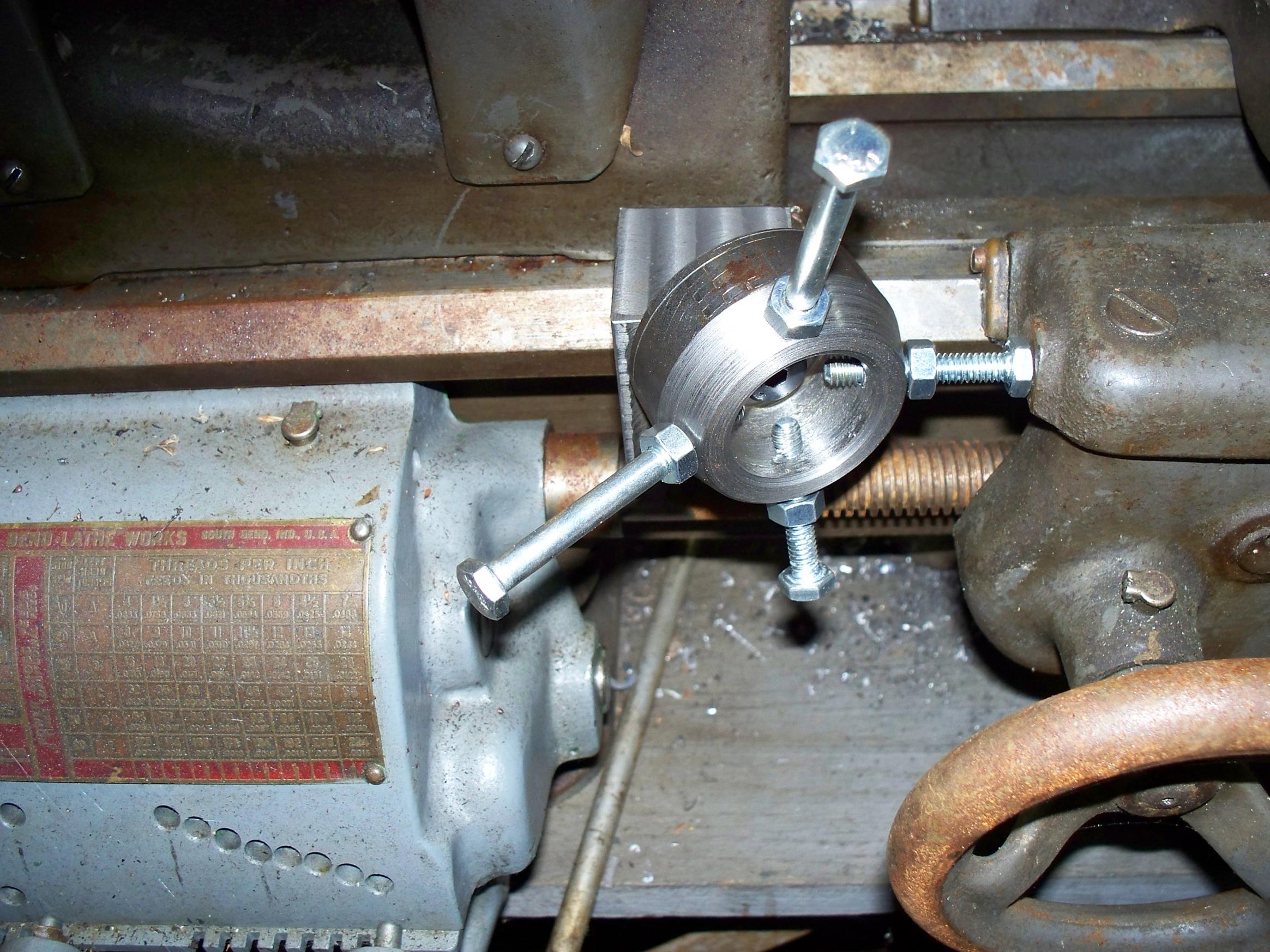

Check out my latest weekend shop project. I wanted to make something different, so I built this 4 way carriage stop. It turns at a 45 Degree angle has 4 stops , and has a ball spring position stop. The angle lets you work closer to the chuck.
I will replace the bolt stops with knurled machine screws.
Any comments / suggestions appreciated.Attachment 19253
