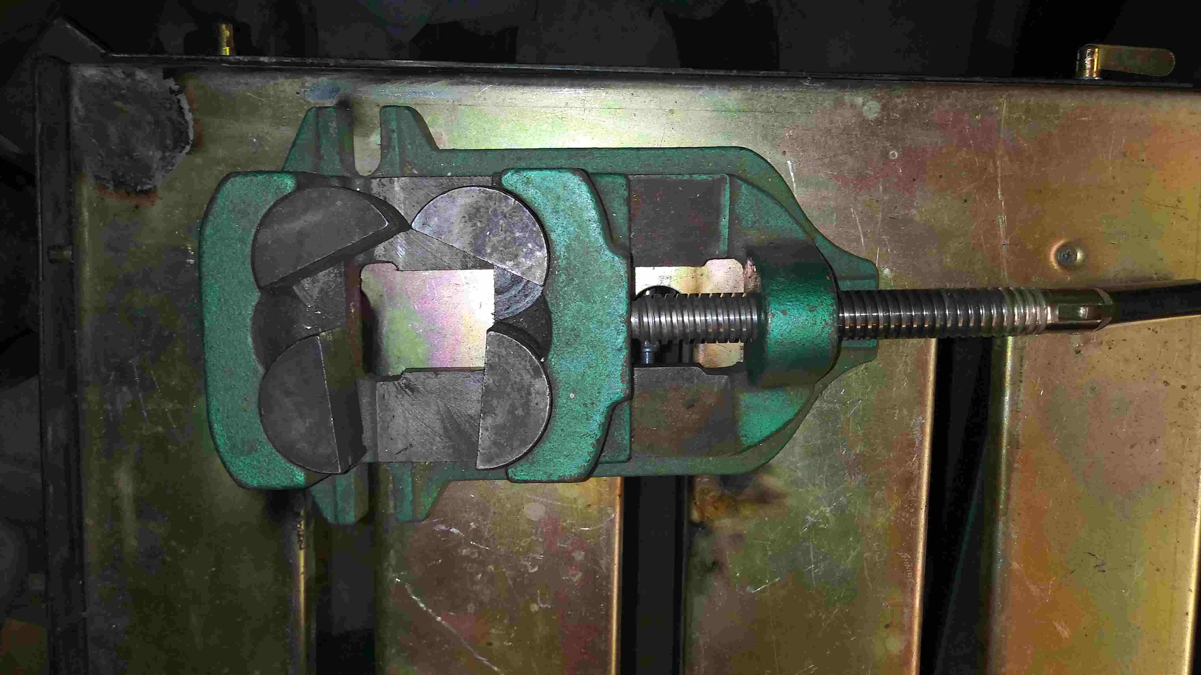

Is this a commercially available vice or a "one-off"?

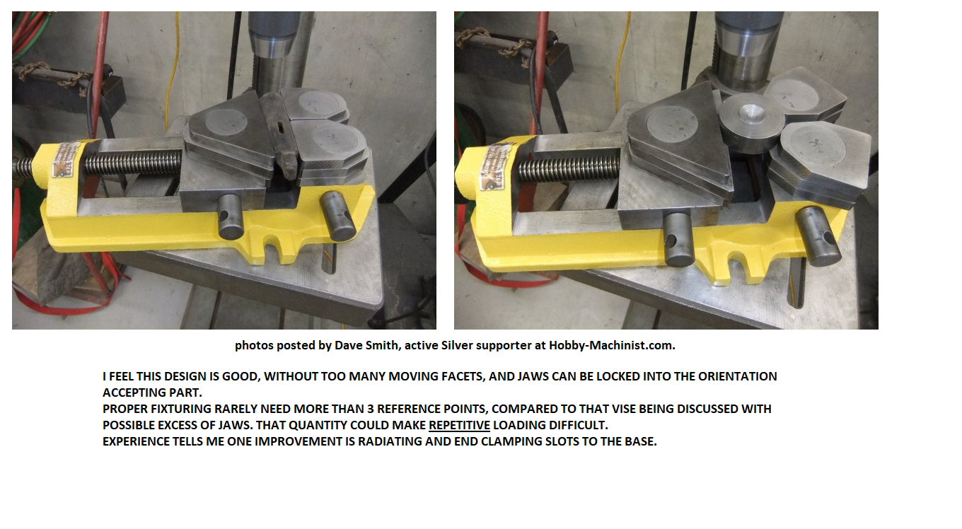

Recent as 70's-80's, an articulating vise was available, with 3 pivots. It was the "Morton" and expensive enough that I put off getting at least one. Equipped better now, making a proper DIY is not insurmountable
Attachment 40002
One thing remains, articulating jaws are suited to short run or prototypes, conforming jaws work best with long run jobs.
So here is my cheap "Servo style" (I think that's what they called it) drill press vise;
Attachment 40021
This came from the local home supply story 25 years ago. I've not seen them since then. Quick search ebay could not find one.
