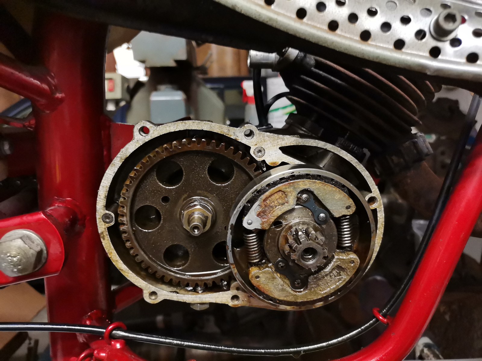

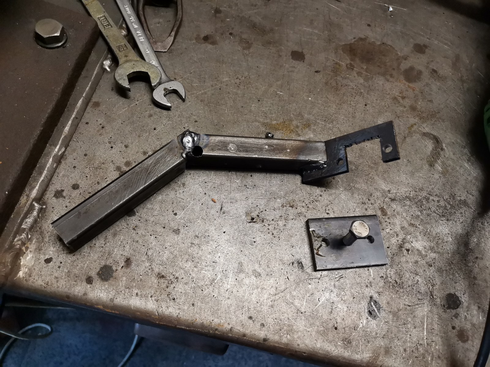

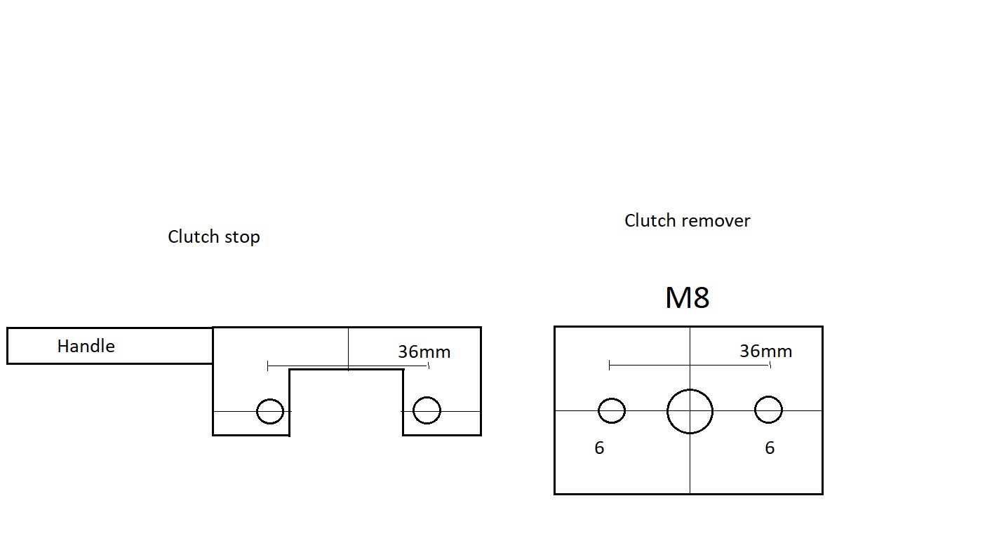

Not a great tool but something used to remove the clutch of the Franco Morini S5 (50cc two-stroke engine). The first tool block the shaft and allows to unscrew the left nut, the second one is the clutch remover. The distance between holes is 36mm, the central threaded hole is M8.
The tools I built are ugly but effective, made with little scraps in the trash.
