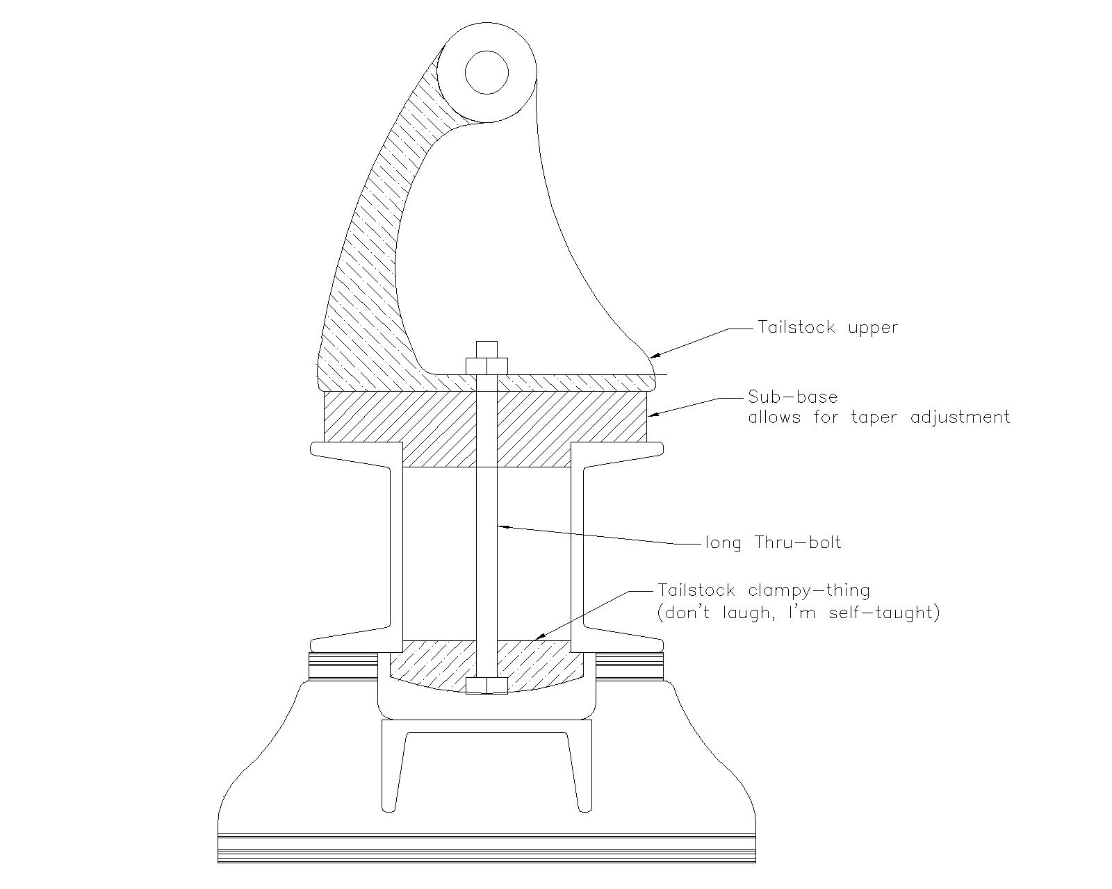

The plan is to turn the c-channels sort of back-to-back, and get a longer bolt for the tailstock clamping bit with the idea being that thicker material will be closer to the point of impact when it comes to clamping, and more of the mass will be engaged if it comes to soaking up vibrations. Here is a 2d drawing of what I've got in mind:
Attachment 19280

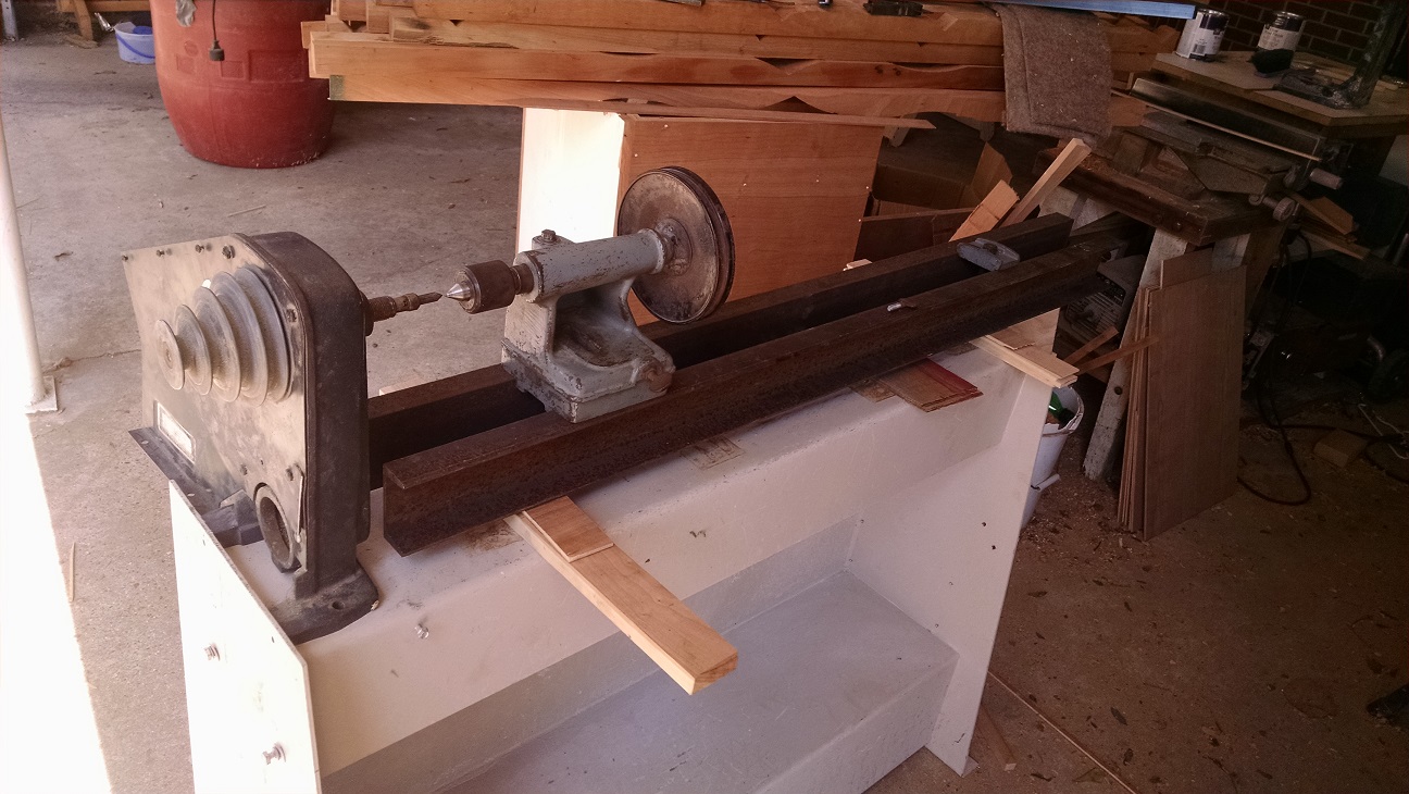

This is about what it'll end up looking like, a bit taller, a bit less... rusty, but pretty much it.
Attachment 19276
Craftsman headstock is a dumpster dive find (we'll see how that turns out... no pun intended!)

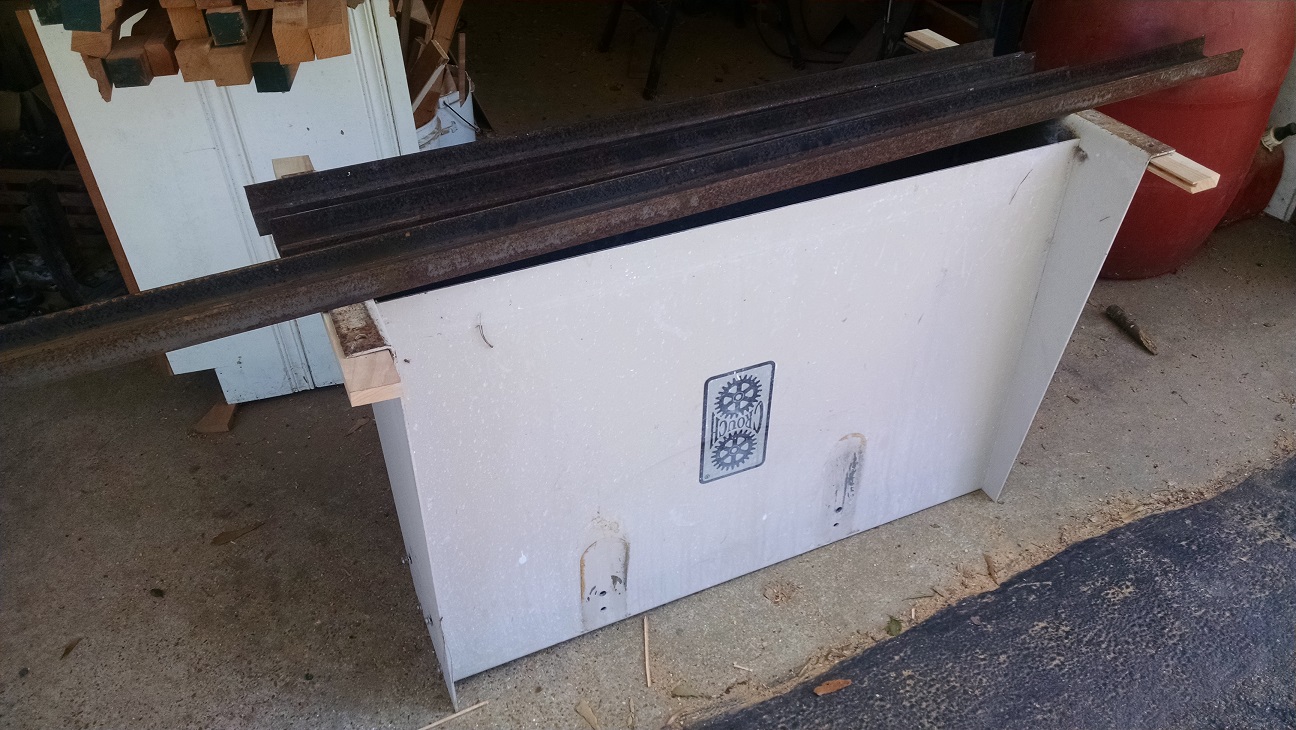

Crouch industrial edge sander base was a cast-off from my employer (with lots of huge cast iron braces pictured below also
Circa 1945 Walker-turner tailstock is an ebay purchase (came with the live center)
Base w/c-channel:
Attachment 19277

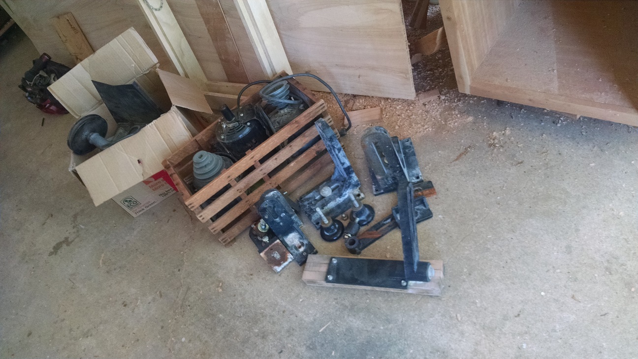

Bits & Bobs that were attached to the base, and three 1/2 horse motors from the dumpster dive
Attachment 19278
