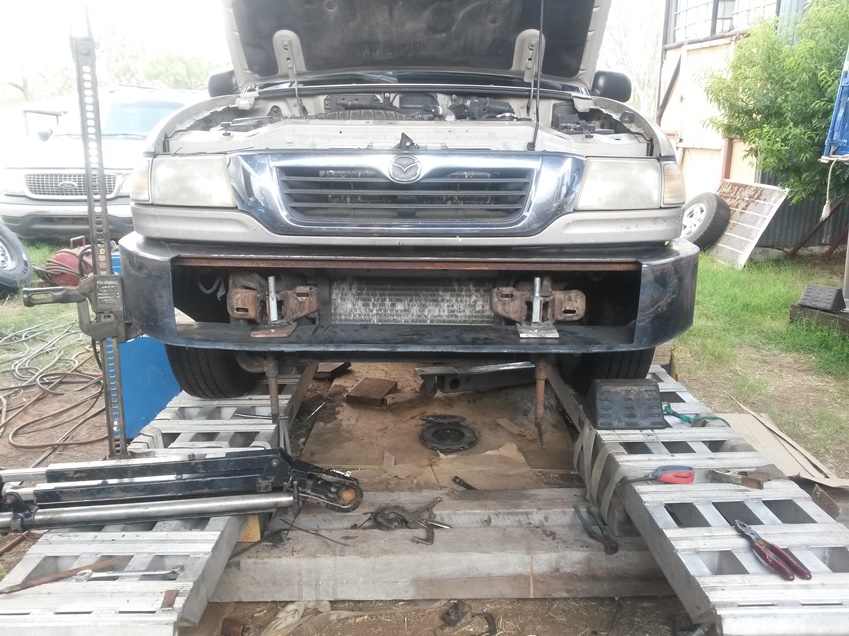

front bumper for Masda pickup

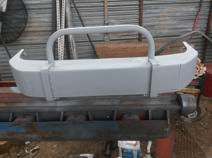

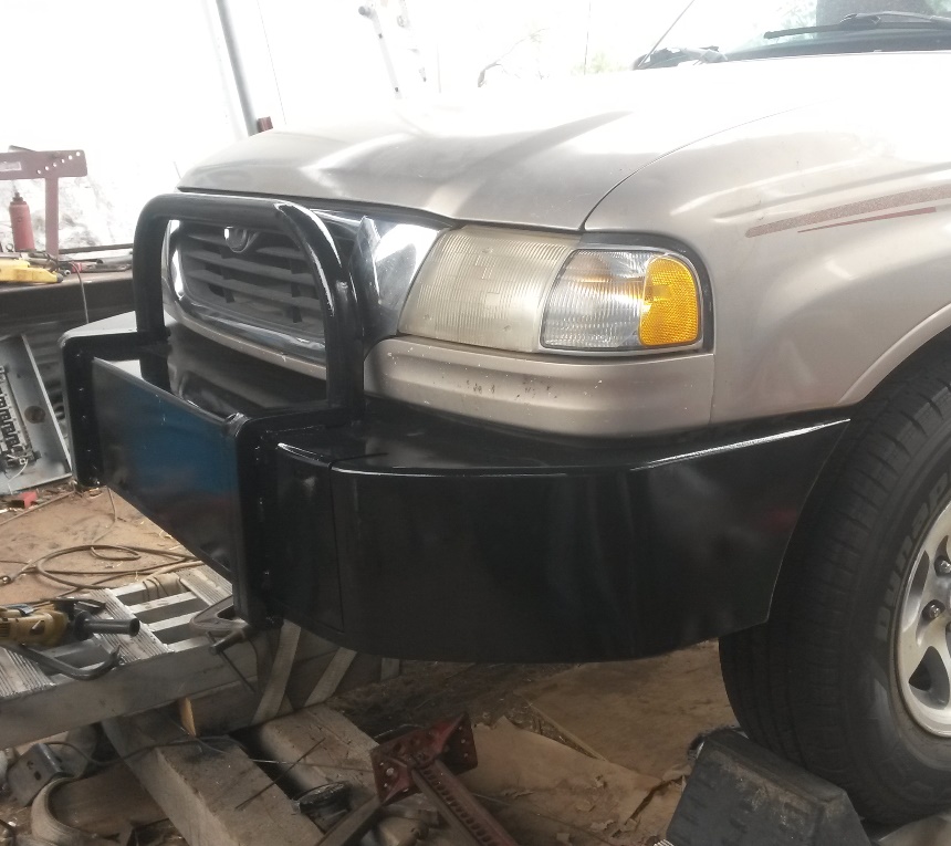

The front bumper will serve as a means to store the tow bar inside of it and also there will be other storage areas inside the bumper for related safety equipment such as safety cables tow lights and a connector cord to plug into the tow vehicle
Attachment 24677

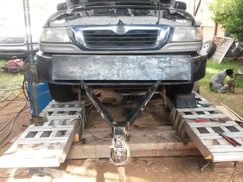

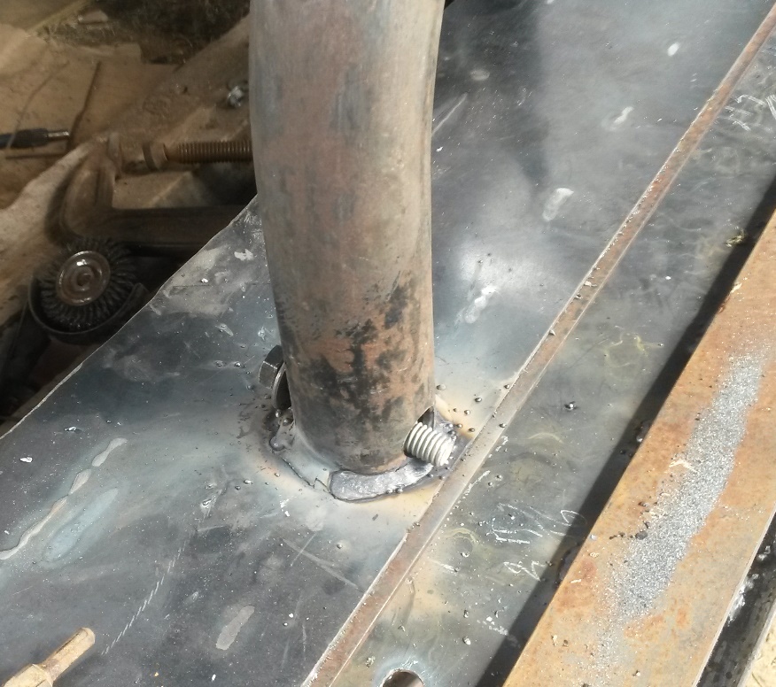

Cut out to be the door hiding the tow bar
Attachment 24678

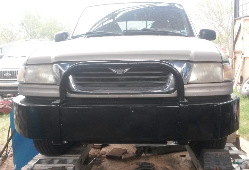

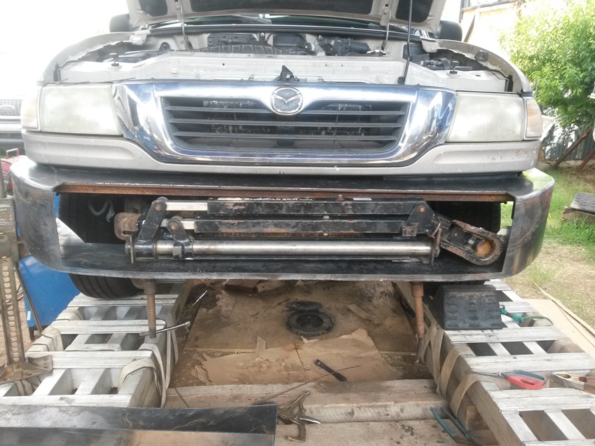

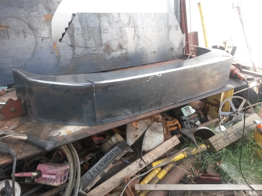

bumper clamped in place
Attachment 24679

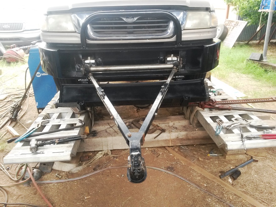

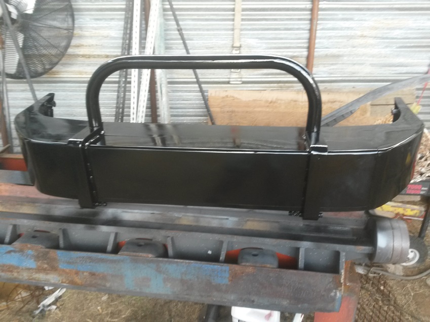

tow bar folded in stored position
Attachment 24680

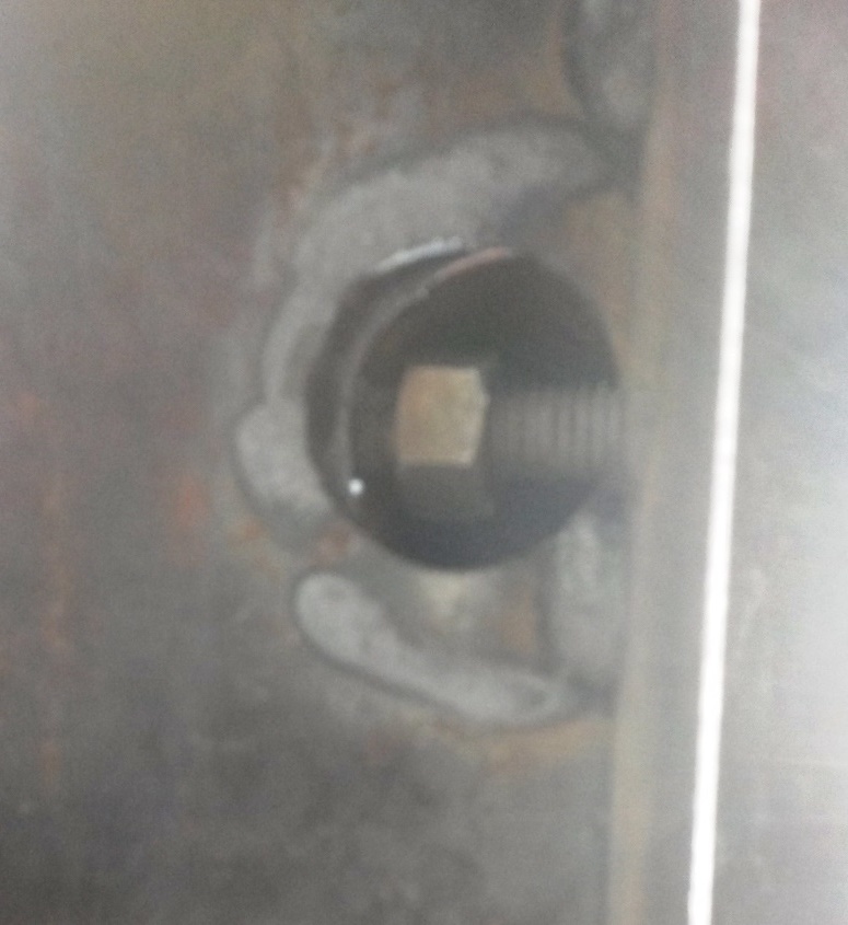

Will have to add small cut outs so the door can be closed while tow bar is in use
Attachment 24681

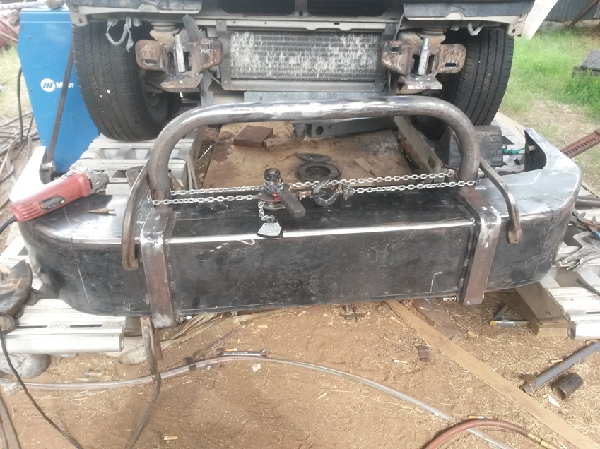

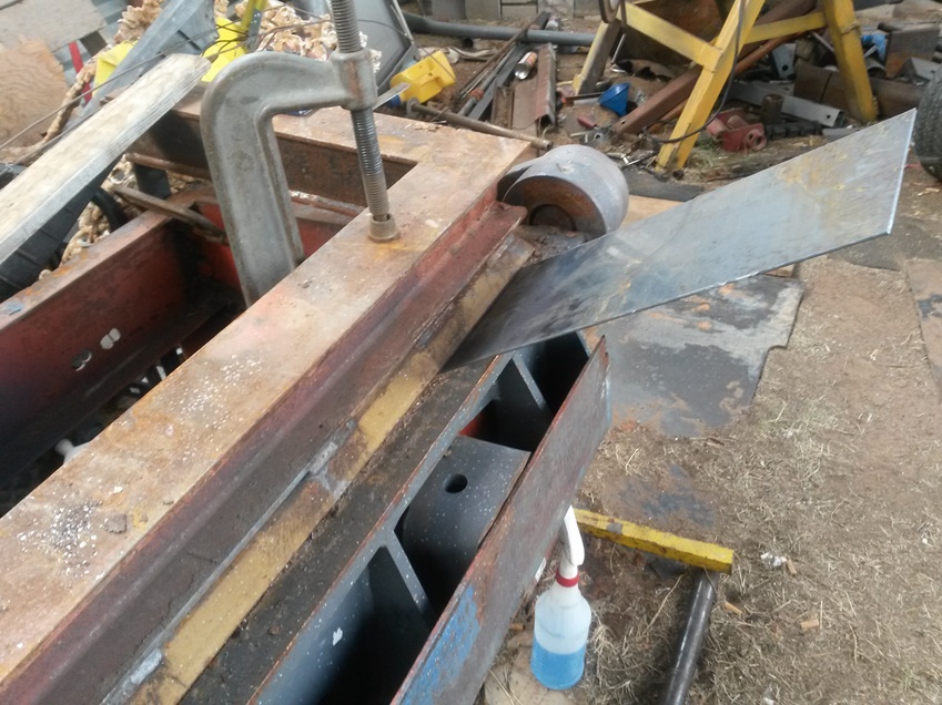

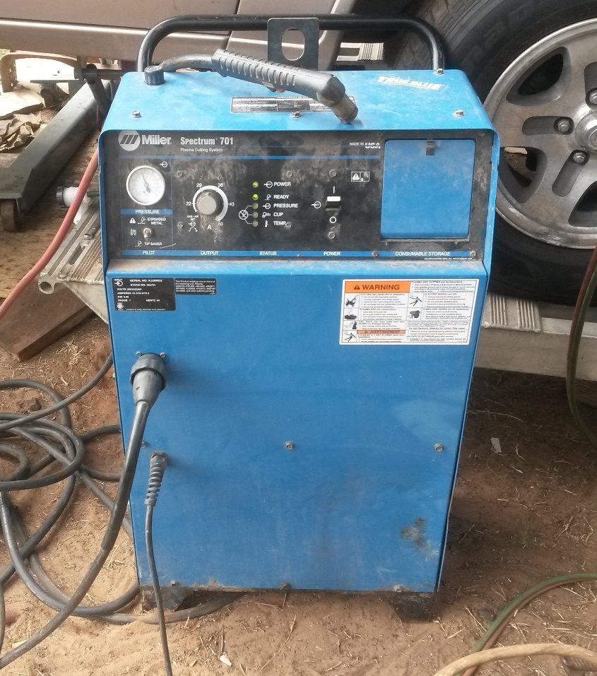

Nothing beats my plasma cutter for these projects
Attachment 24682

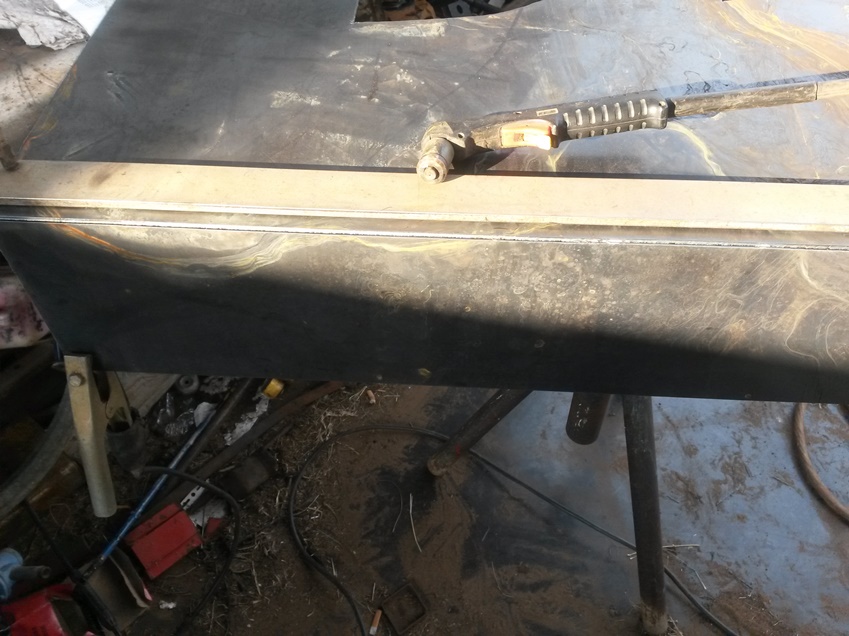

Even though I may never finish doing the mods to my folding break it works perfectly

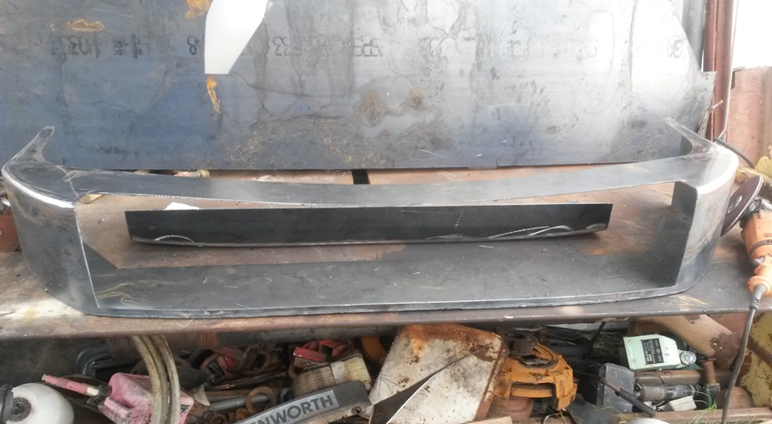

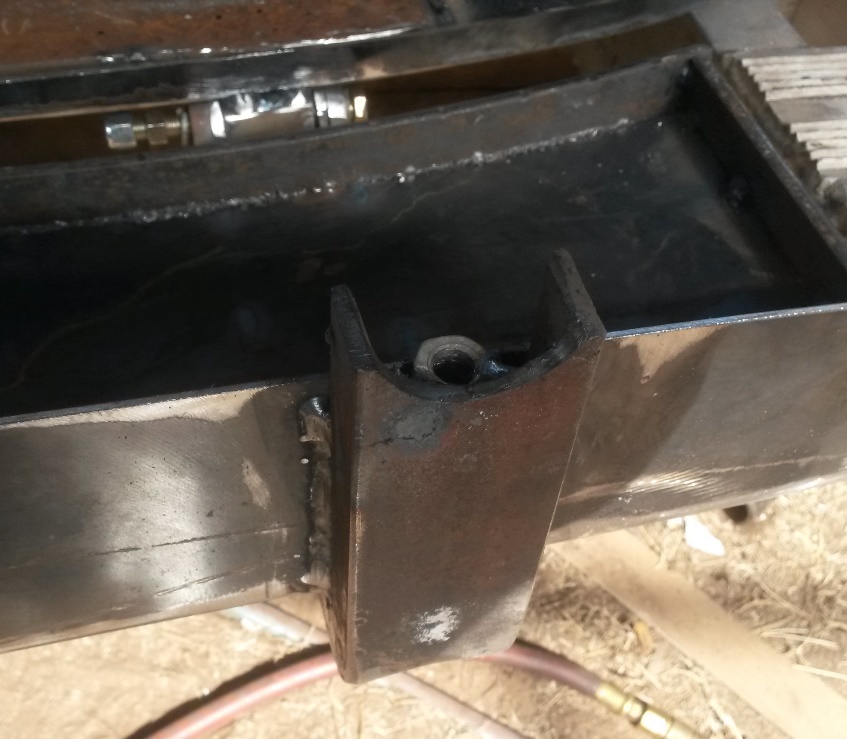

For bending the bumper parts shown is a plate which will serve as one of the mounts and a back for the built in storage compartment
Attachment 24683
