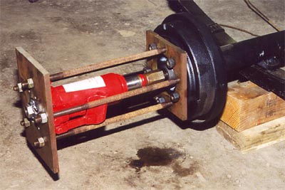

in some days before i am with big problem to remove an front hub, so i found it in web and i will post... i think not are in homemadetools...
check
Wheel Hub Removal Tech Tips on The CJ3B Page
Attachment 3822

Dear, it project not is my, i found in internet and put here.... i think an excellent project... so i am shared. thanks
That's a clever, using a bottle jack. Thanks for the idea! :thumbsup:
Cool! Thanks for sharing, Eder. All this time I thought steel plates and hardware would suffice.
