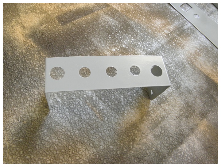

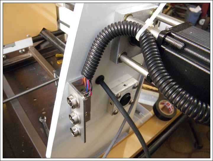

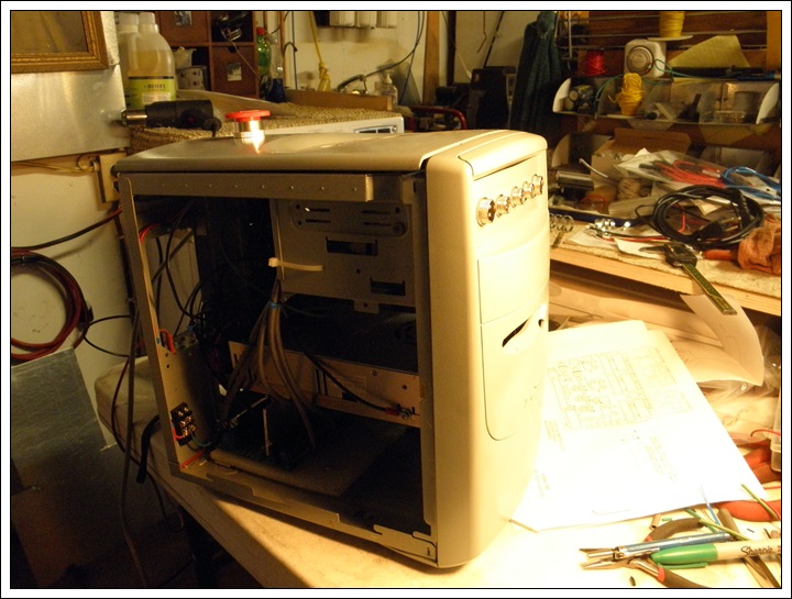

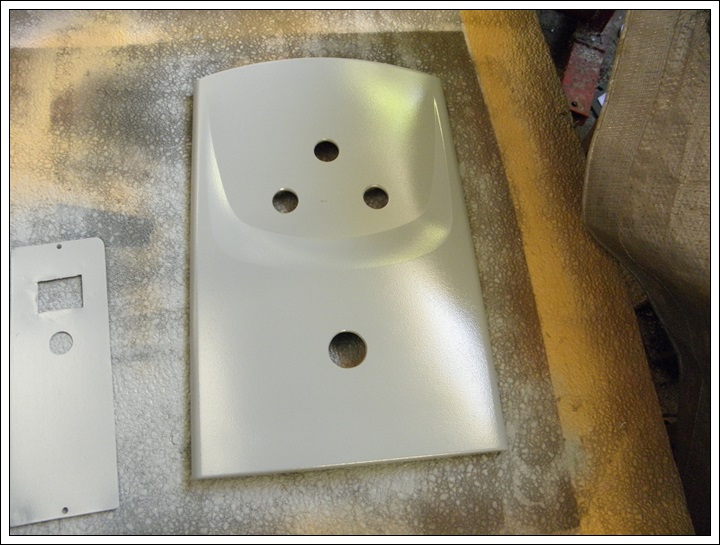

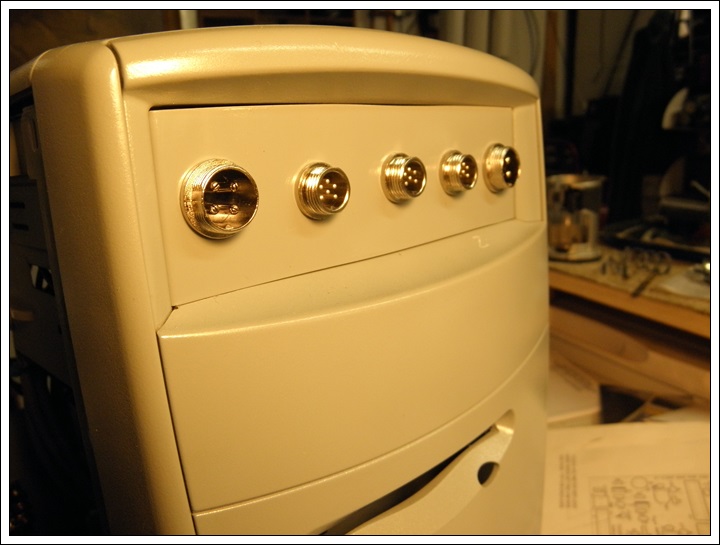

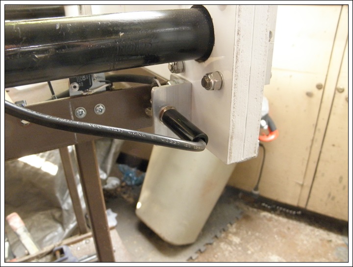

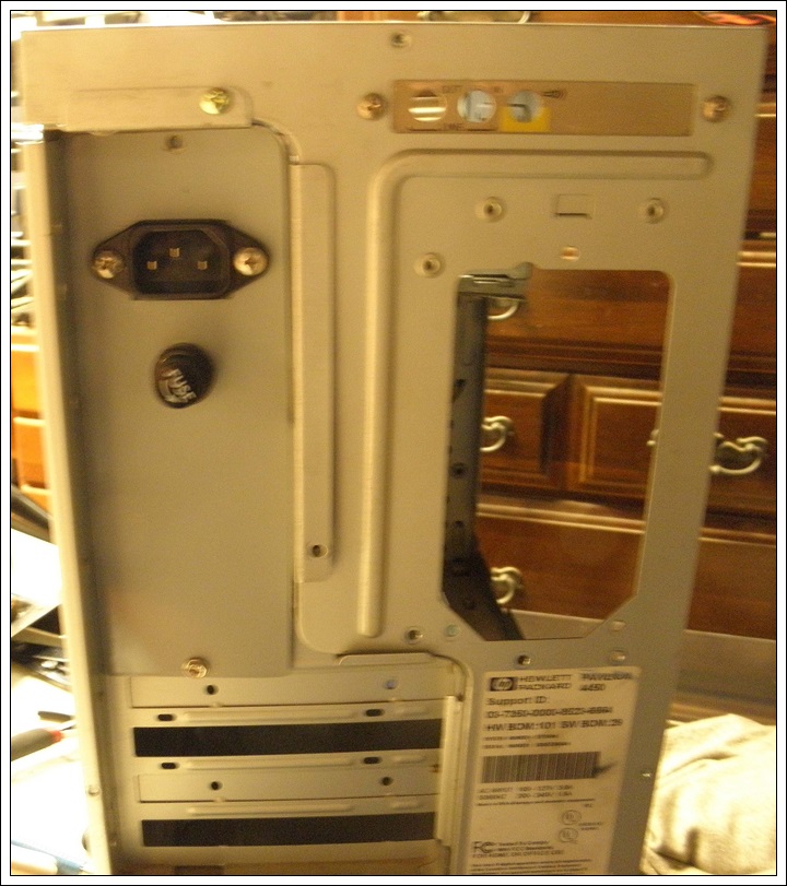

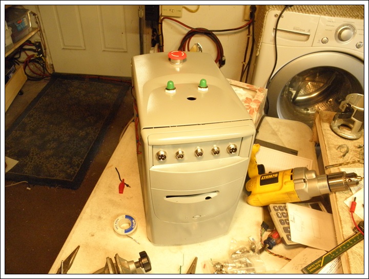

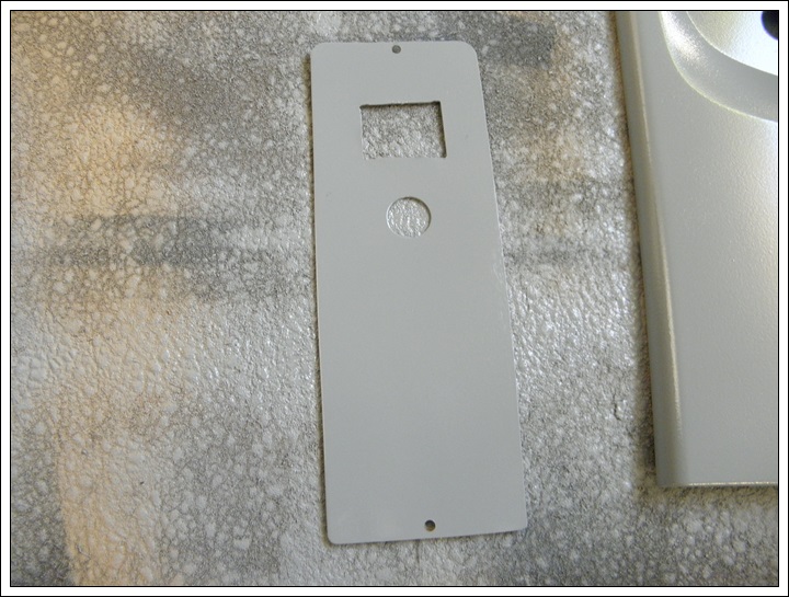

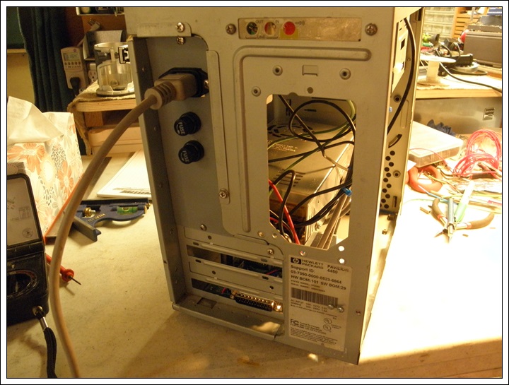

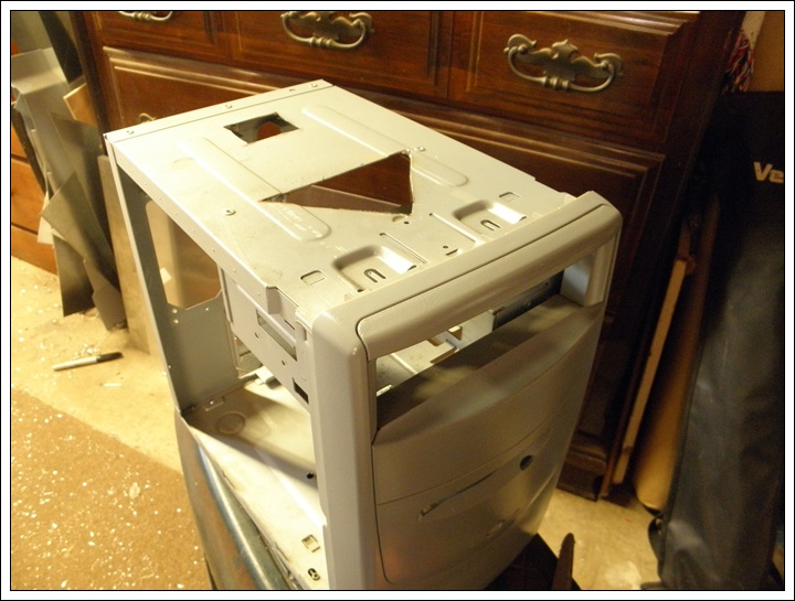

    Gantry Style CNC Router Part 5 L@@K . NEW PARTS. Control box parts plug-fuse holder, switch, pilot lights, aircraft connectors.

    Thanks Captainleeward! We've added your CNC Fuse Holder Assembly to our CNC category,

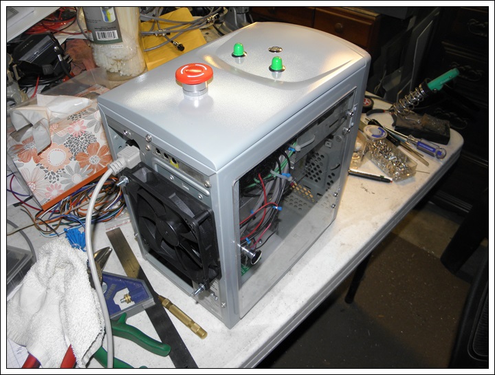

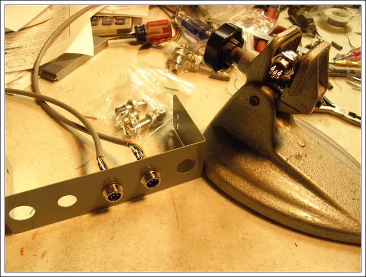

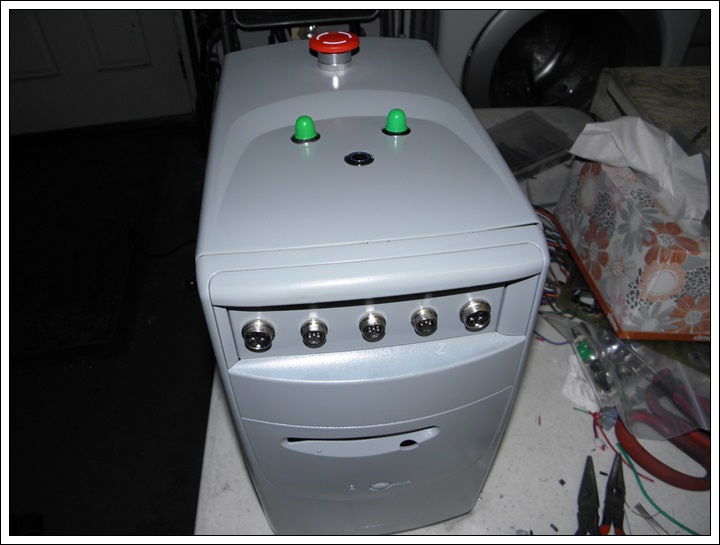

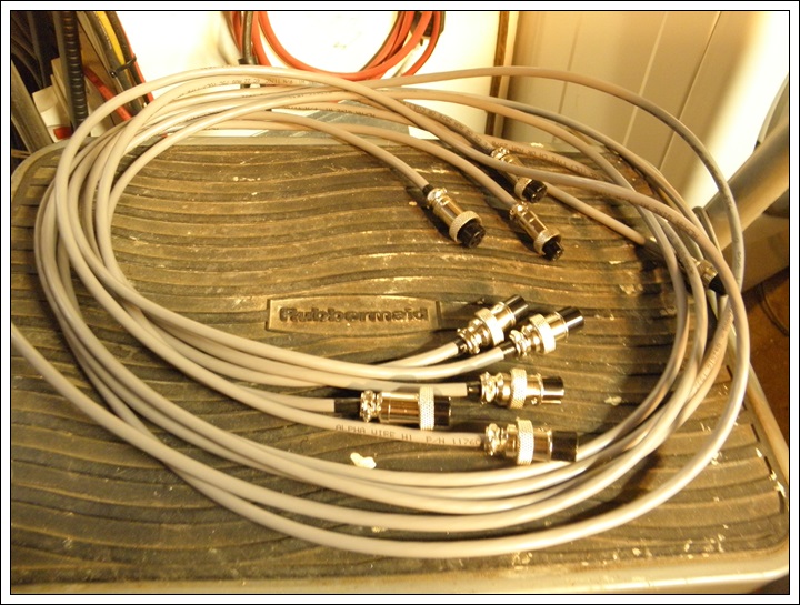

    Lookin good Captain, Nice use of the computer case for housing your electronics. Modular cables for the motors are a nice touch, I ran mine to a terminal strip but I really like your connectors.
    Looking forward to first cut.

    Hello JJR, Thank you for the kudos lets see you machine??....:O)

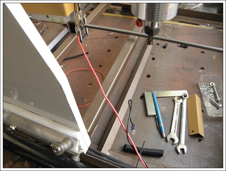

    I put the side connectors on the gantry so I can remove the gantry for storage if I want.

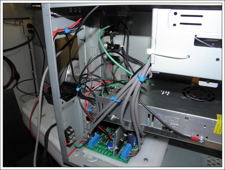

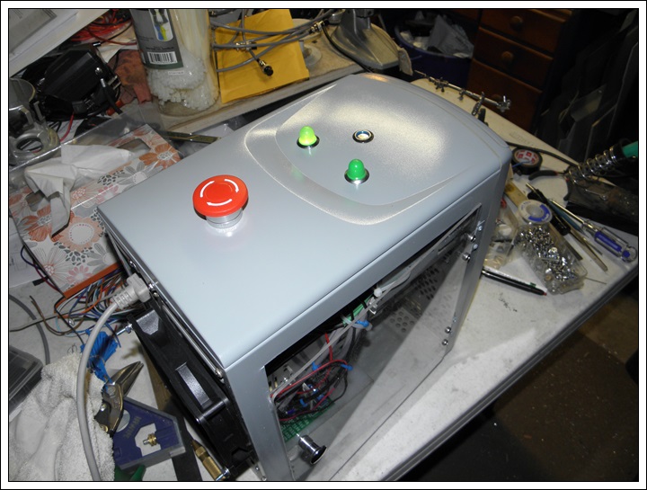

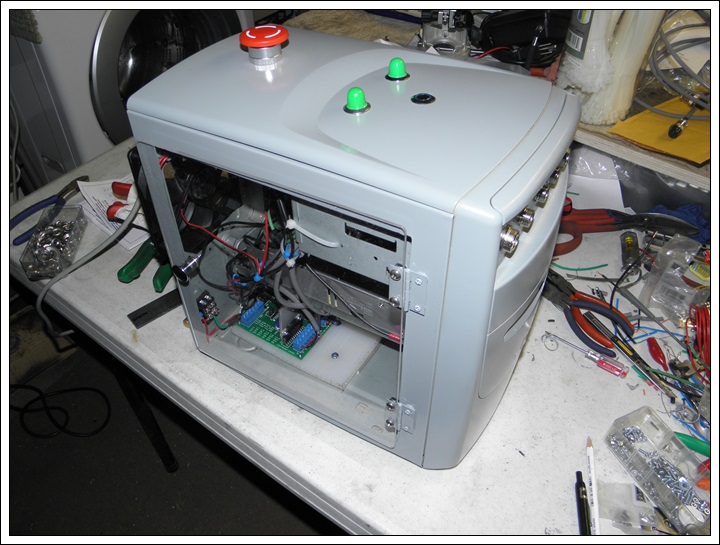

    Thanks for the update Cap'n! Quality wiring there and cable builds look Pro! Really Nice work!! Repurp'd another computer case too. Can't quite tell from the pics on how you mounted the pancake PS in there but sure fits pretty good and close coupled to the board (on Delrin/PE?). I might have mounted the board on some short stand-offs to get some cooling to the underside of the board??

    O Thanks PJs, You can't see the nuts that I put under the circuit board they are therem I just added a 4.5 inch 24 volt fan to the back of the case for added over heating protection Always enjoy seeing you builds thanks for your input.....:O)
