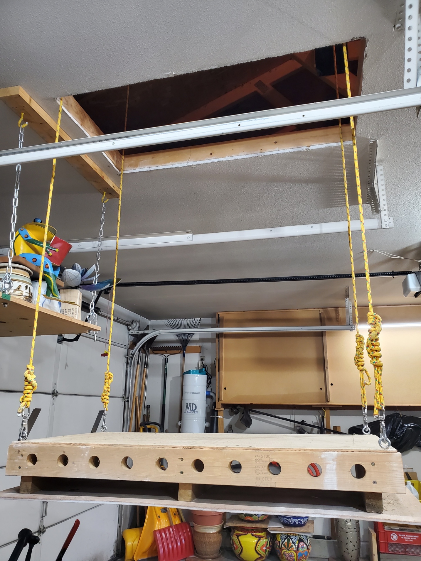

Here are two pictures of the dumbwaiter from the garage. Left is fully raised. Right is partially lowered.
Attachment 45106 Attachment 45107
The platform is secured by a rope at each corner. The ropes move in unison to keep the platform level.
The dumbwaiter is positioned between roof joists to maintain the integrity of the roof trusses. It is located between two garage doors to eliminate the need to move a vehicle and close the door before using the lift.
(The holes in the sides of the platform are from a prior project -- I re-purposed the wood. )

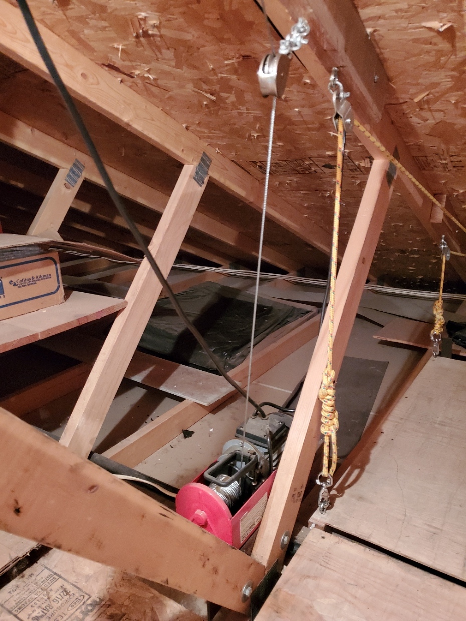

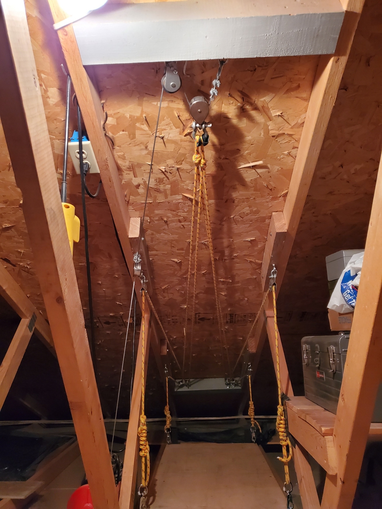

Here are two pictures from the attic with the platform fully raised. Left shows all the rigging. Right shows details of the winch.
Attachment 45108 Attachment 45109
In the left picture, the red winch is at the lower left and the yellow winch controller is on the left toward the top. The right picture shows more detail of the winch and associated rigging.

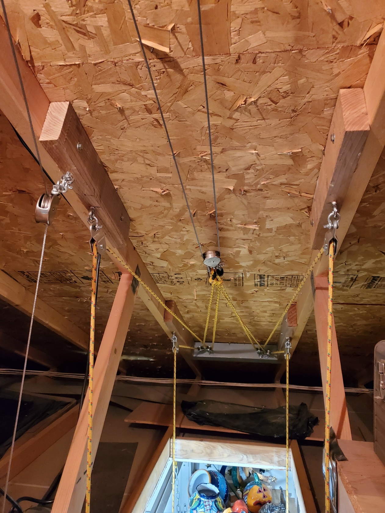

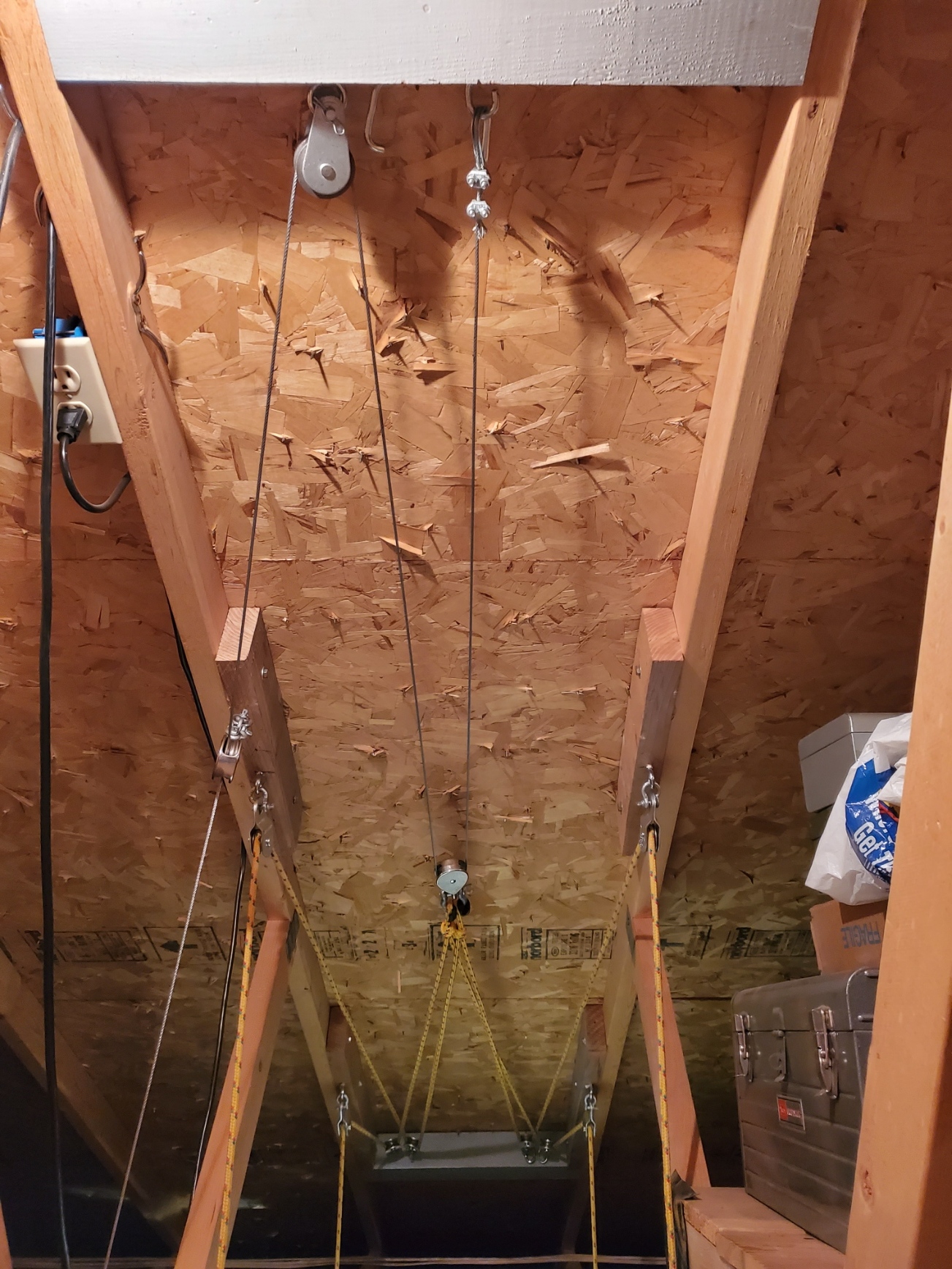

Here are two pictures of the cable, ropes, and pulleys. Platform is partially lowered.
Attachment 45110 Attachment 45111
The cable from the winch is routed by a pair of pulleys to align with the ropes attached to the platform. The cable is rigged with a 2:1 mechanical advantage for pulling on the ropes. This is primarily to reduce the speed of movement of the platform, not because of loading on the winch.
I used inexpensive "climbing" rope because it is strong and has very little stretch. The ropes are rigged with the long down-and-back run to provide enough length to lower the platform to a convenient height. Fully lowered, the platform is about 2 feet above the garage floor.
