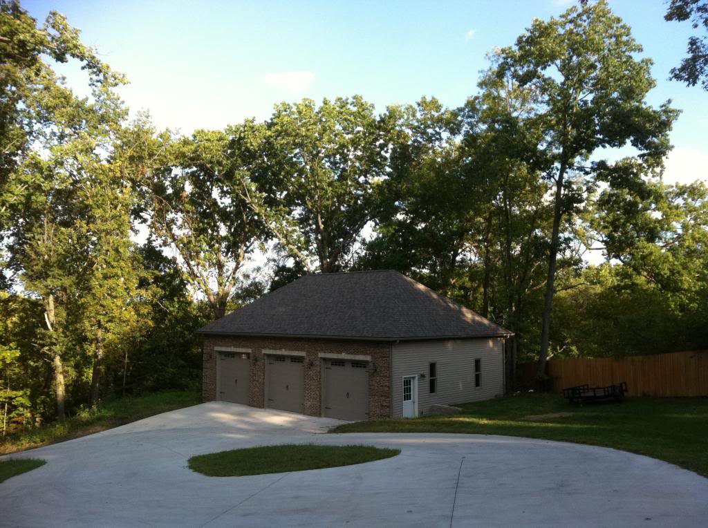

The build thread starts off like many, by recounting the builder's dream:
"I've been dreaming about my own shop since I was 15 working on my truck in the parent's driveway."
Then it quickly gets down to the nitty gritty:

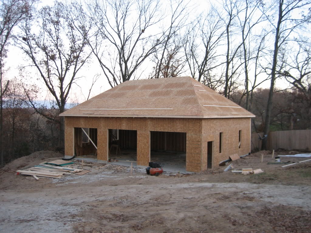

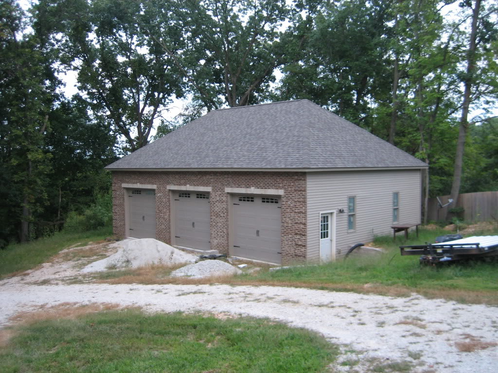

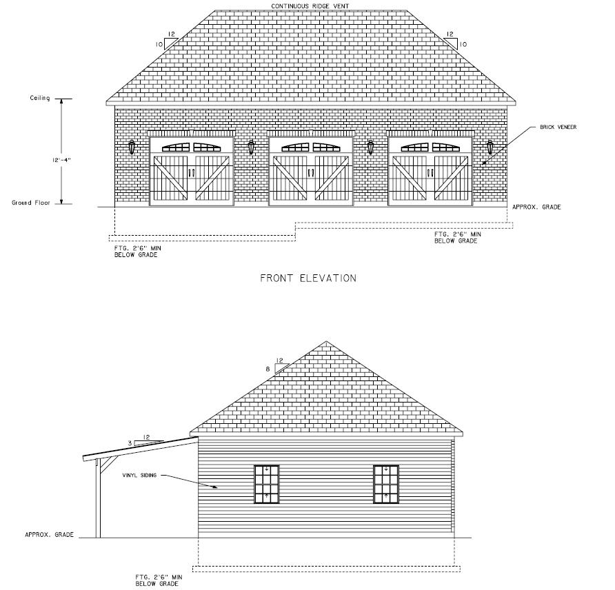

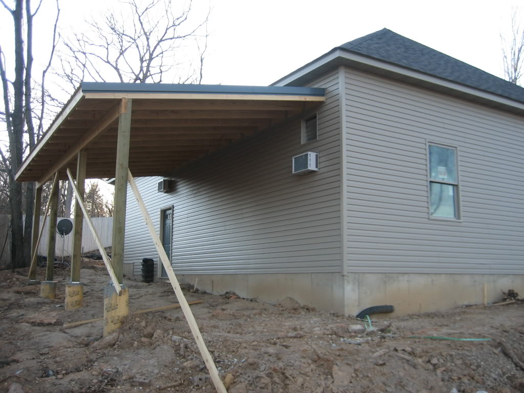

-30x46 stick-framed on full frost-walls and footings.
-Hip roof structure with attic trusses for storage room.
-12x26 lean-to off the back, for the tractor and lawn equipment.
-One 16x30 room with a 2-post lift, and another 30x30 room.
-Three 10x9 overhead doors.
-A/C and heat.

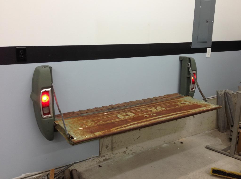

-Tailgate bench.

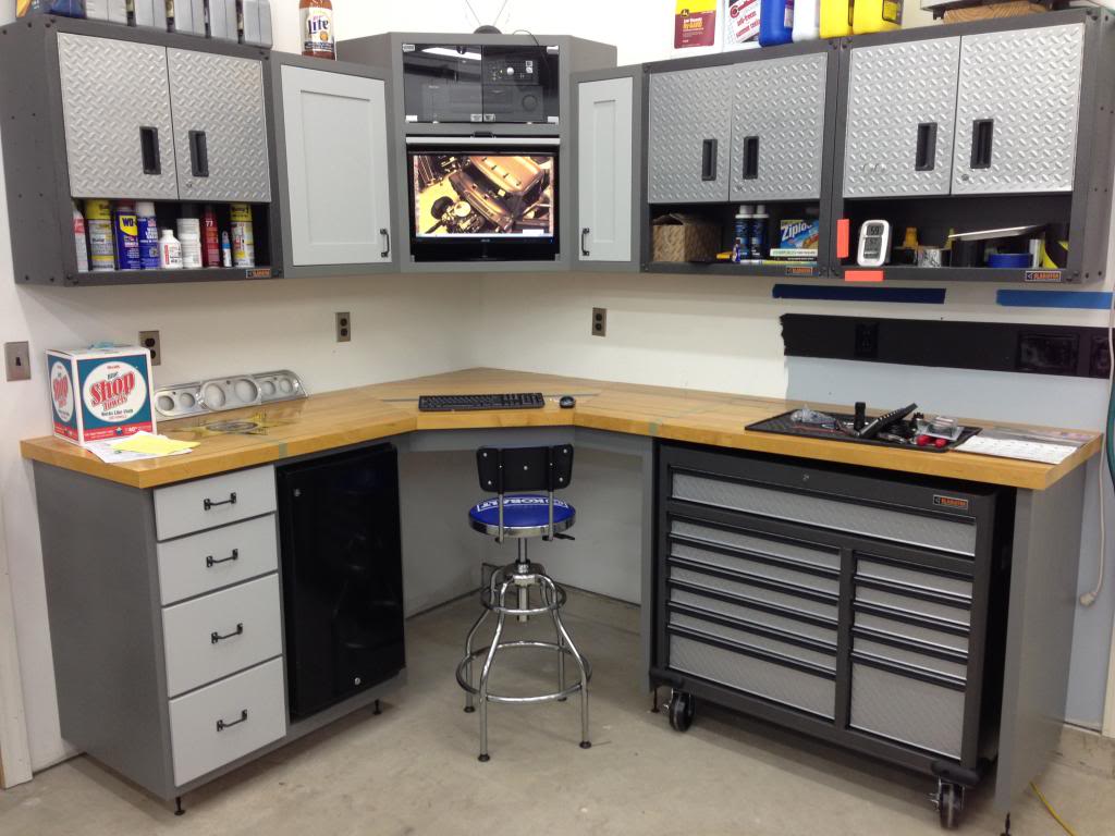

-Custom workbenches covered in 60-year-old 1" maple from a high school gymnasium floor.
