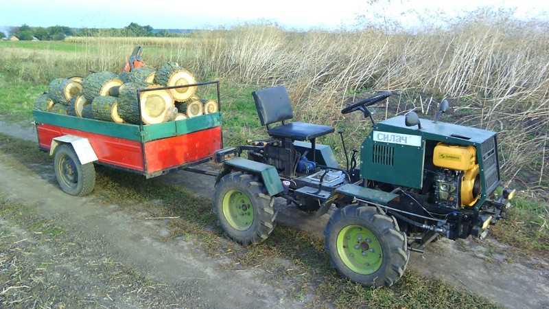

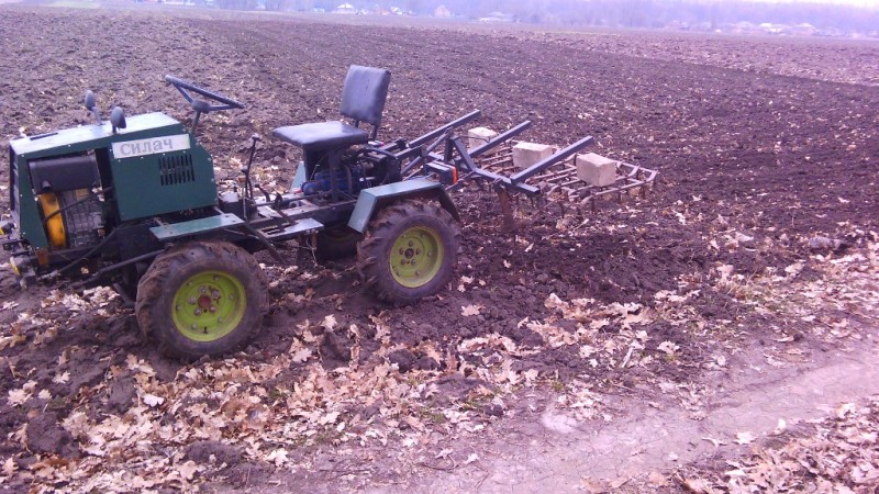

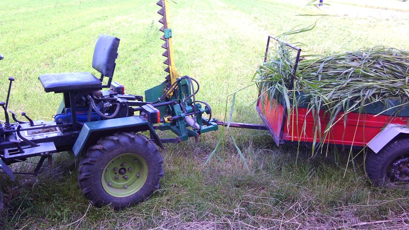

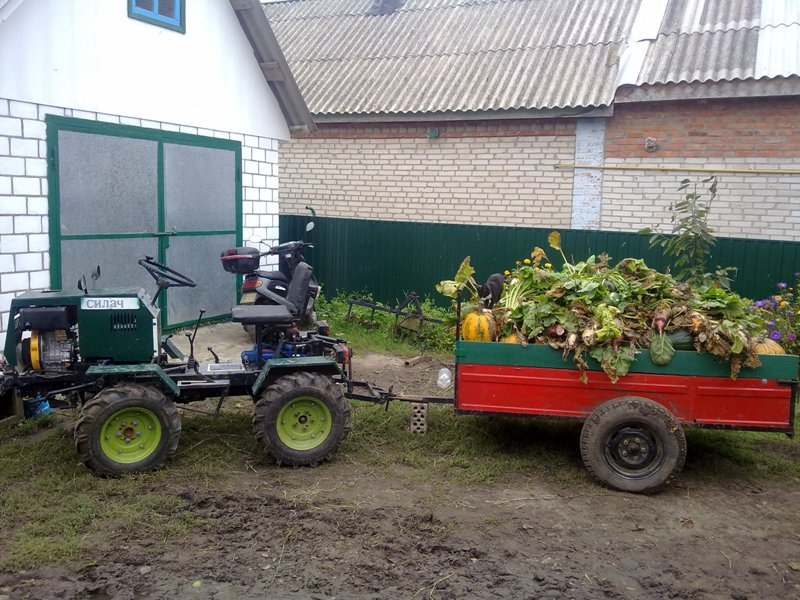

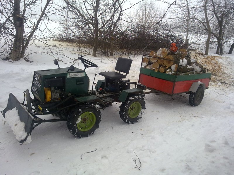

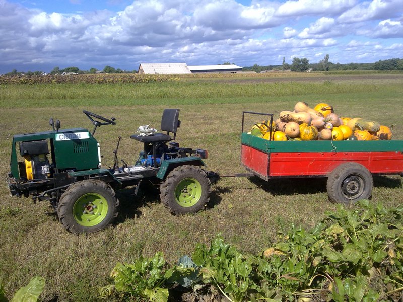

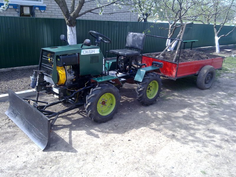

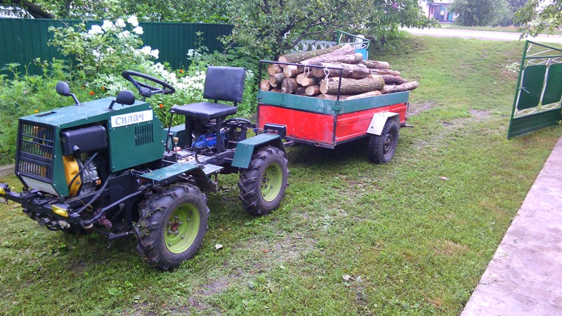

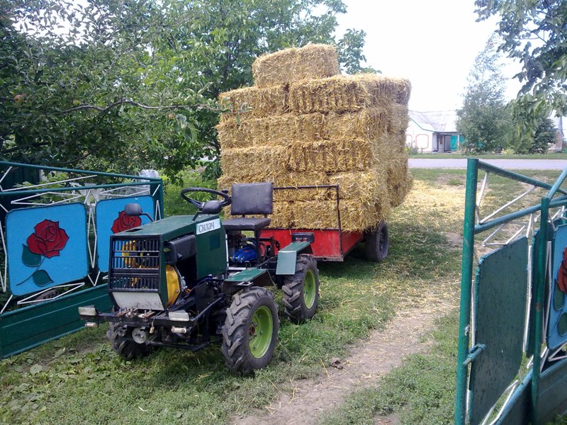

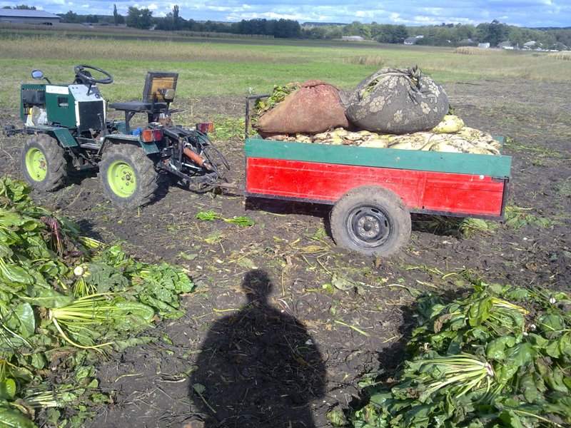

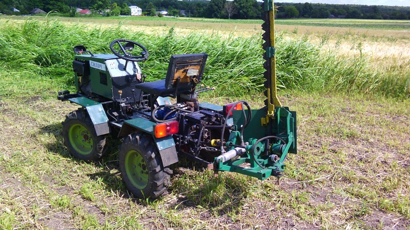

Garden mini tractor 4x4

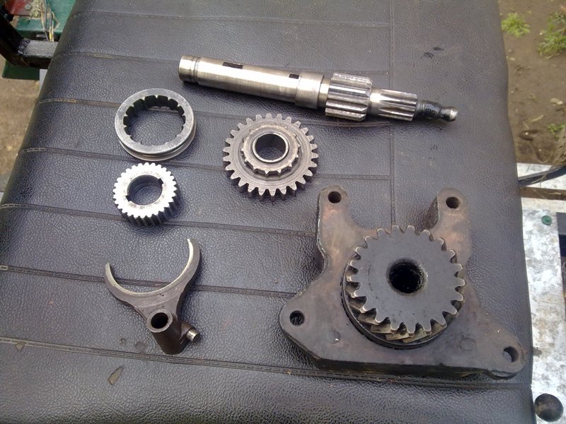

1 Attachment(s)

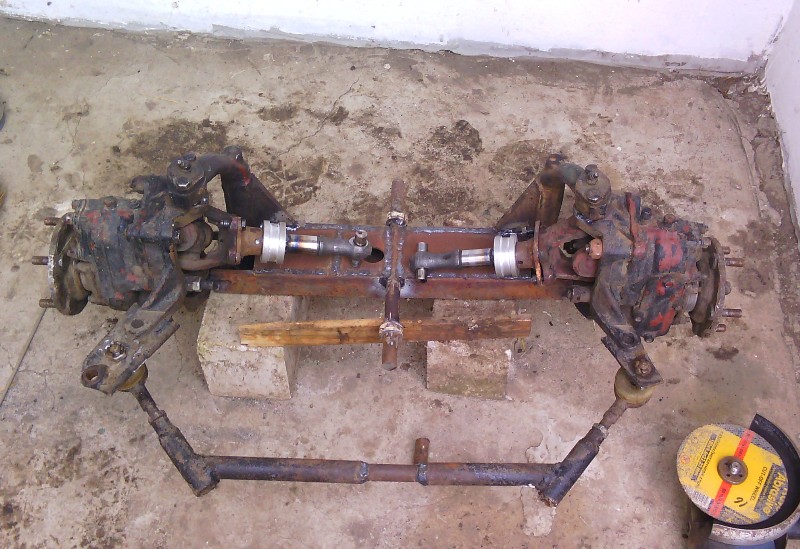

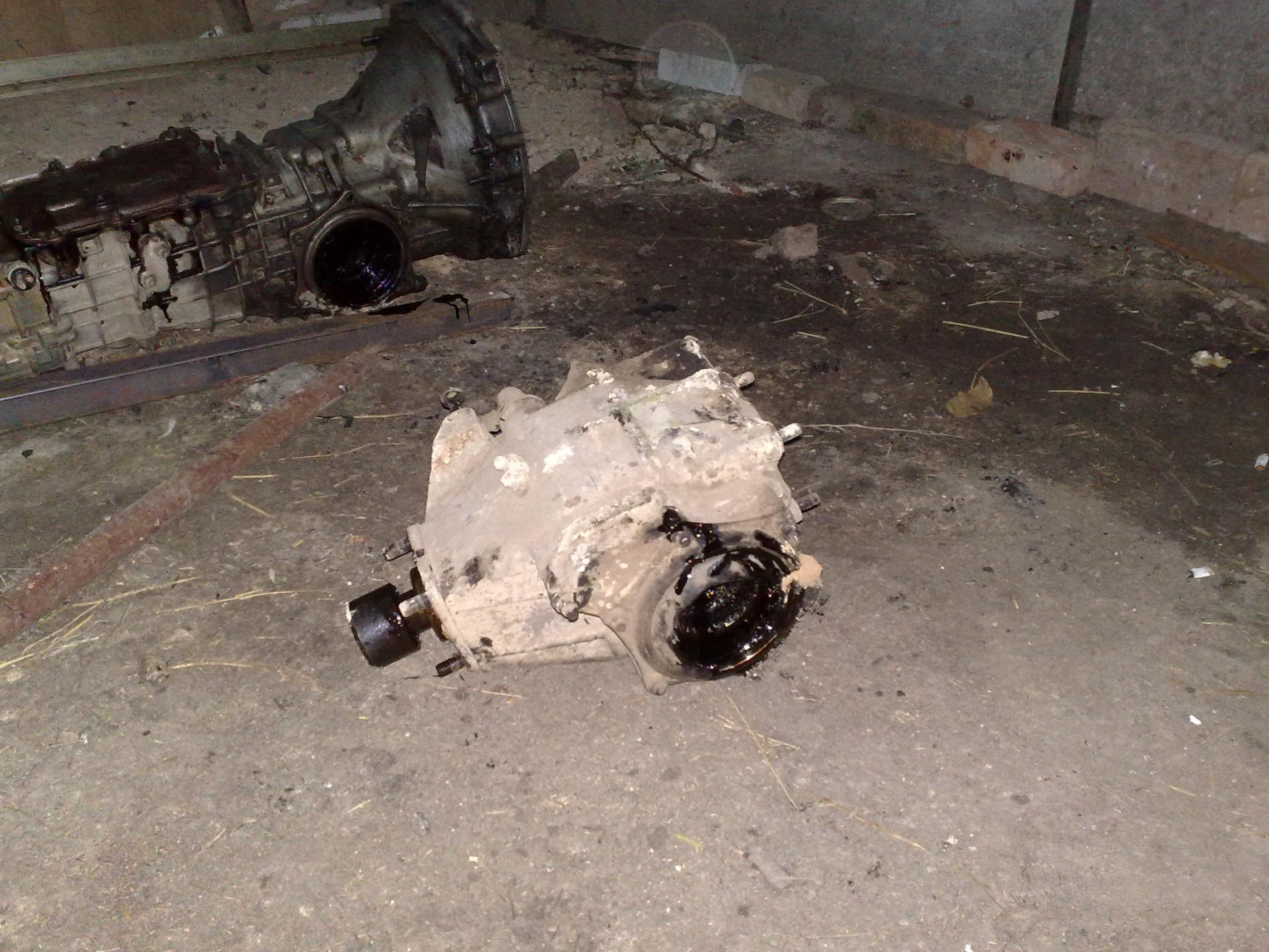

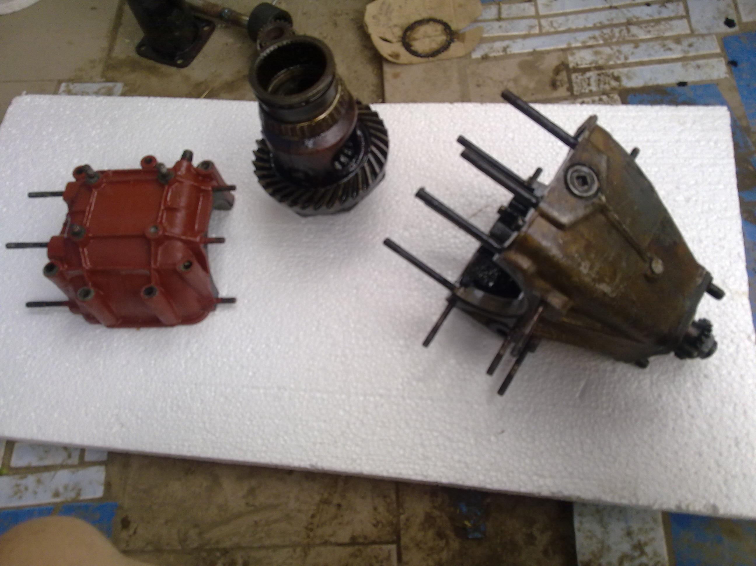

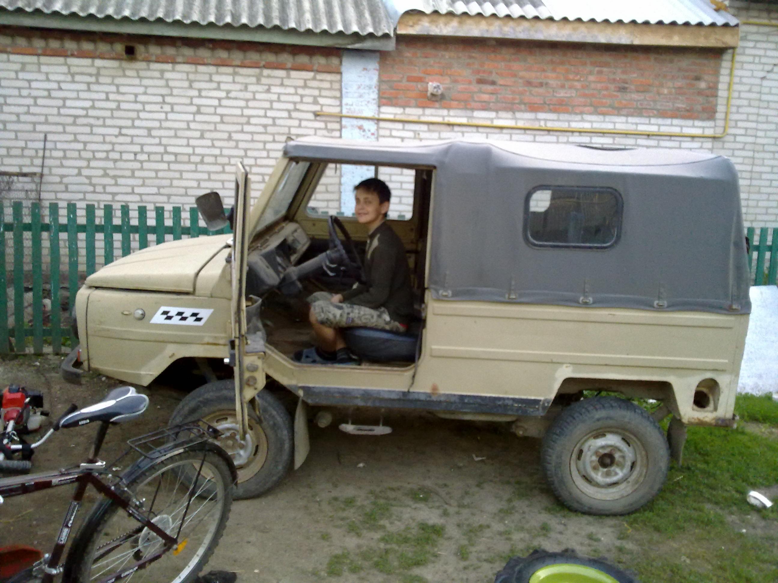

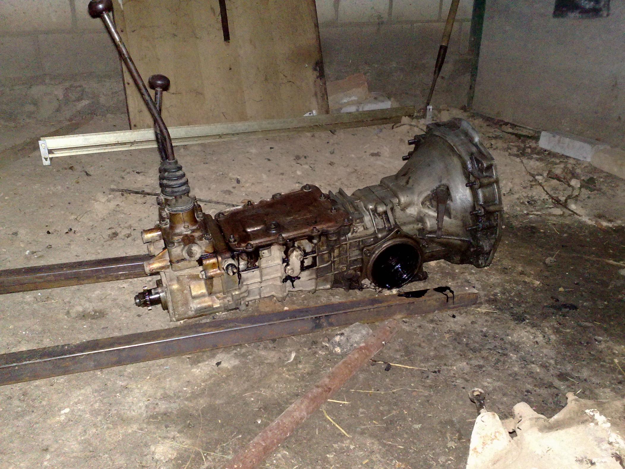

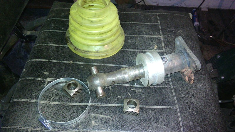

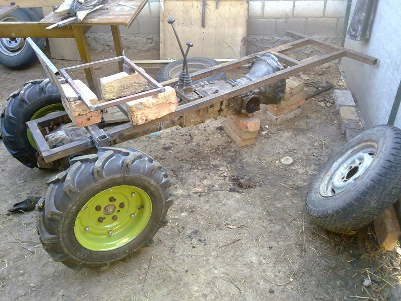

It began with the fact that I bought Donor parts LuAZ 969. Used the vehicle gearbox on the front and rear axle, side gear.
Attachment 11630

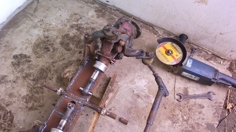

3 Attachment(s)
3 Attachment(s)

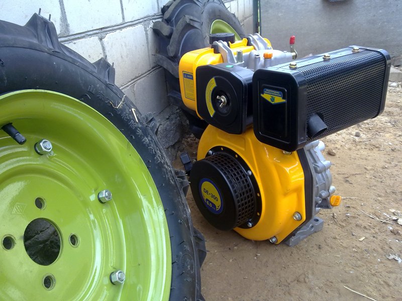

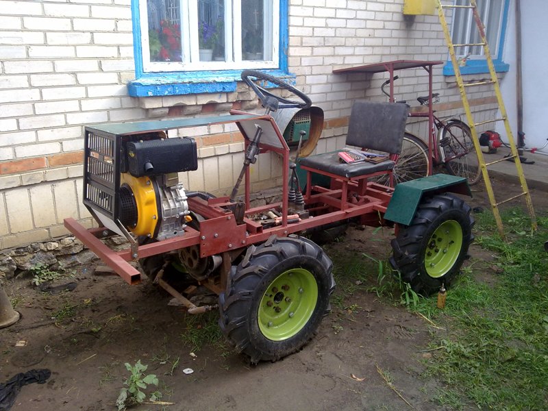

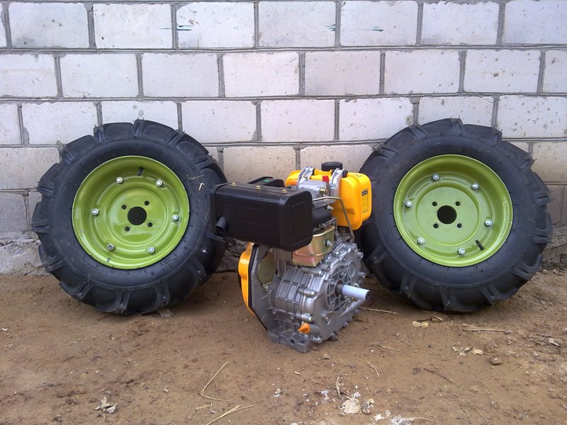

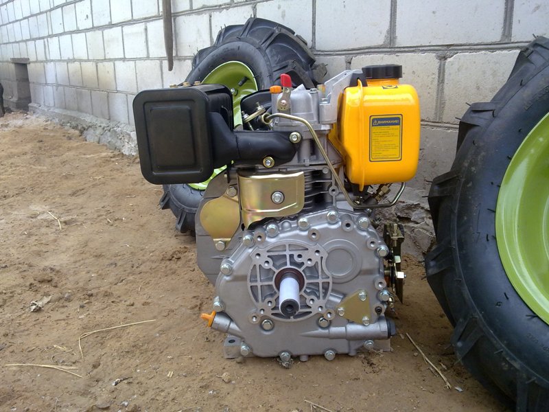

Chinese diesel engine 300cc 6 horse power and wheel r12
Attachment 11634 Attachment 11635 Attachment 11636

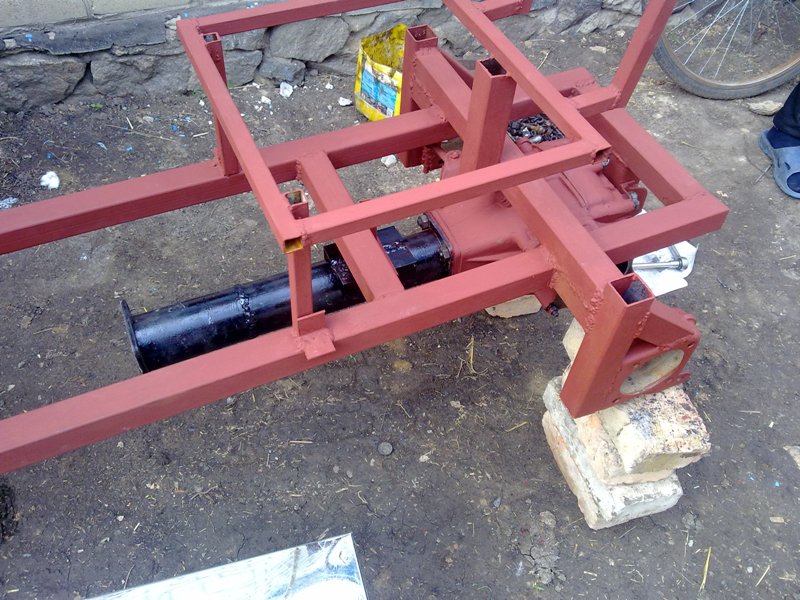

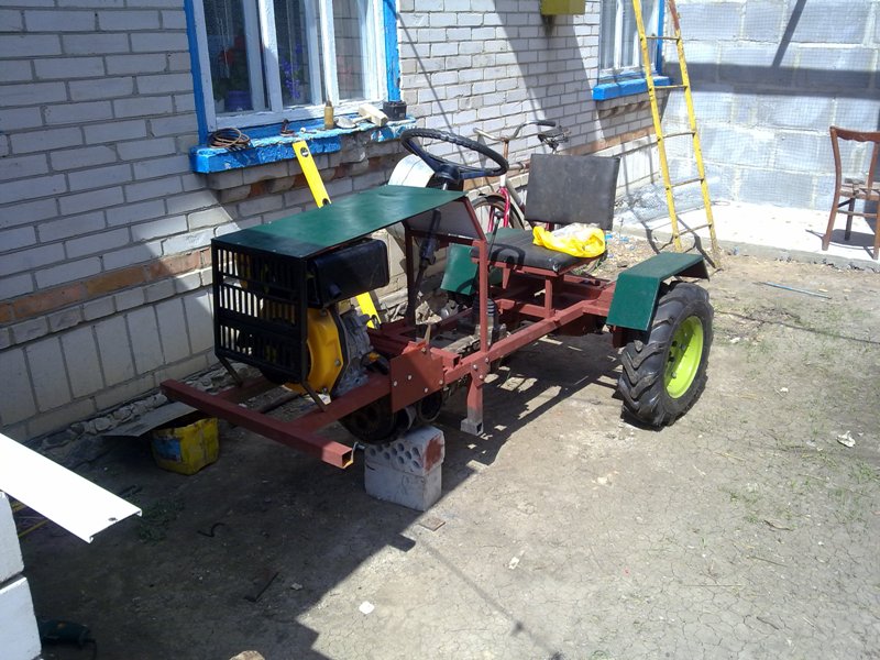

3 Attachment(s)

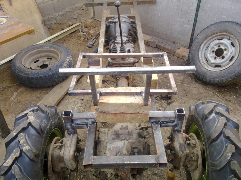

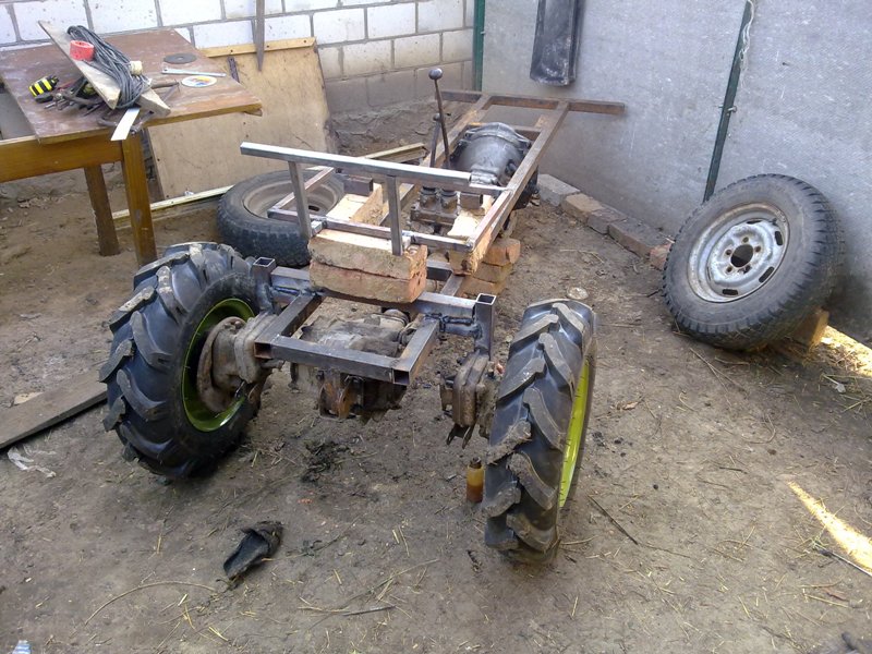

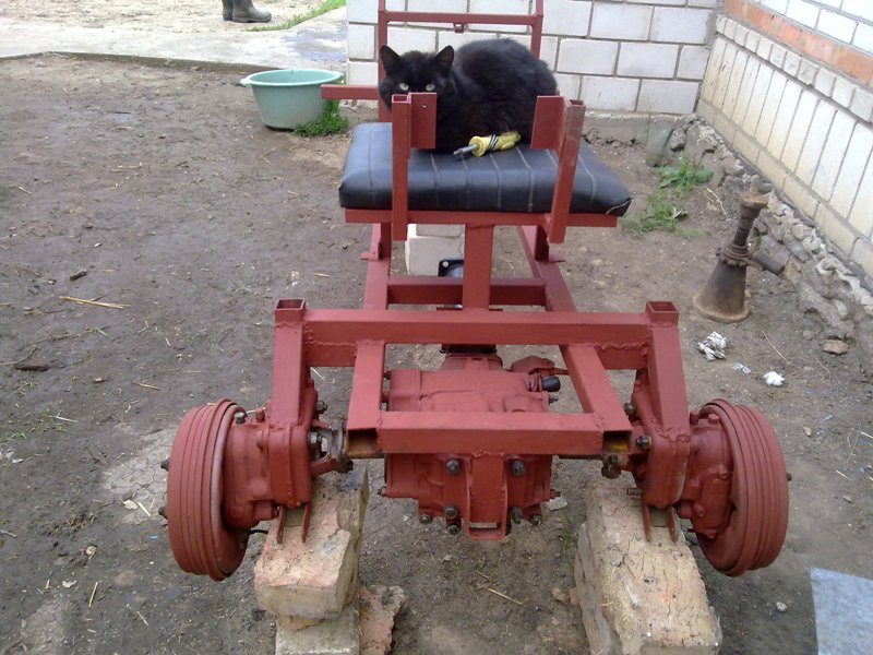

The frame is welded from shaped tube 40x40, later increased to 40x80.
Attachment 11637 Attachment 11638 Attachment 11639
4 Attachment(s)
6 Attachment(s)

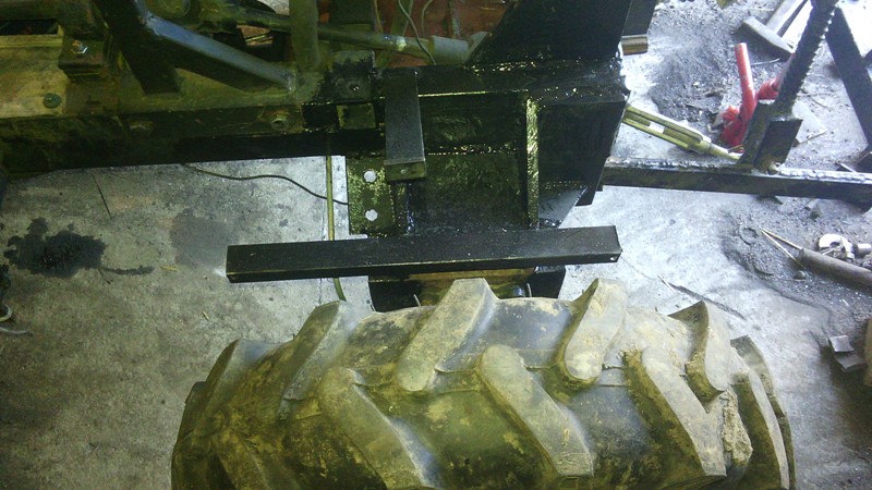

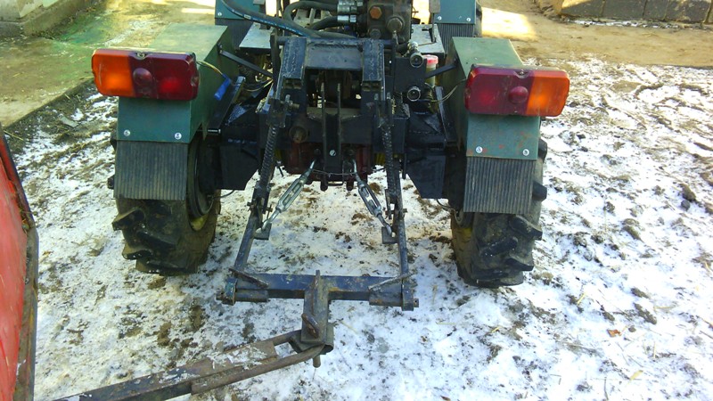

3 Attachment(s)

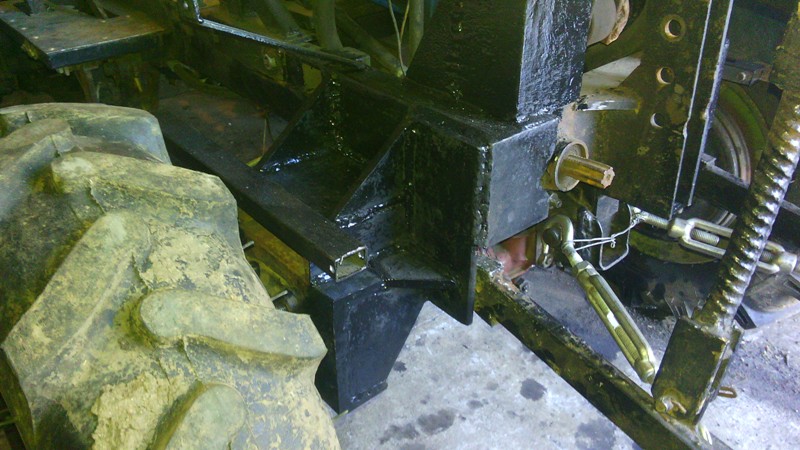

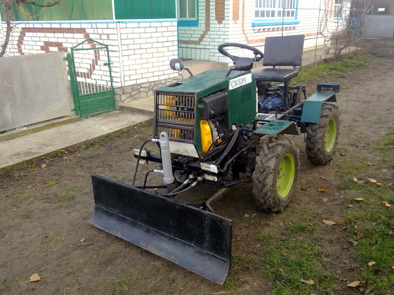

Later I changed the rear of the tractor, reinforced sheet metal 10-12 mm
Attachment 11652 Attachment 11653 Attachment 11654

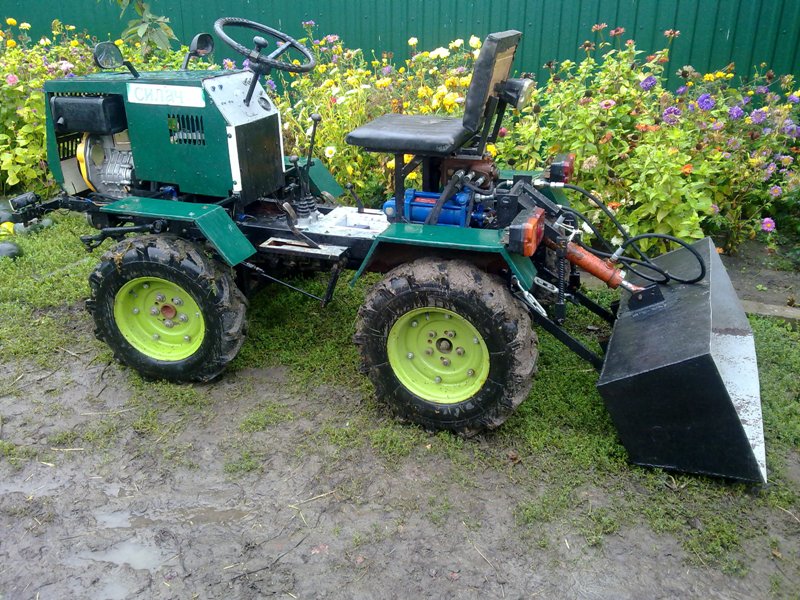

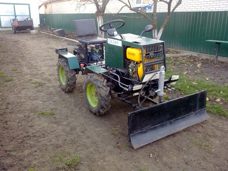

5 Attachment(s)

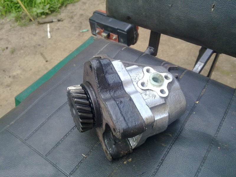

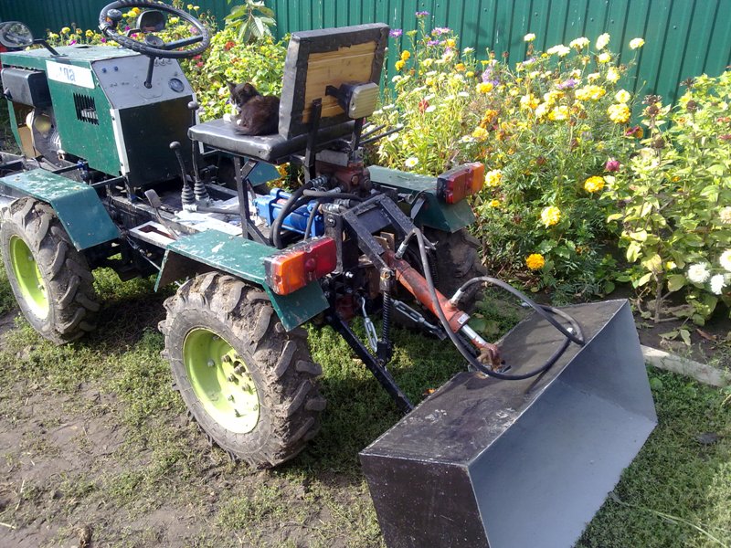

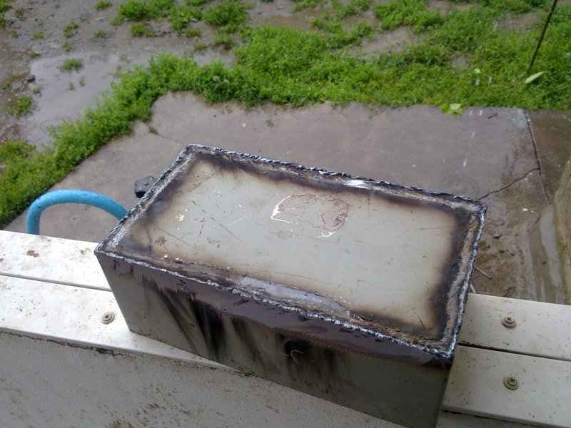

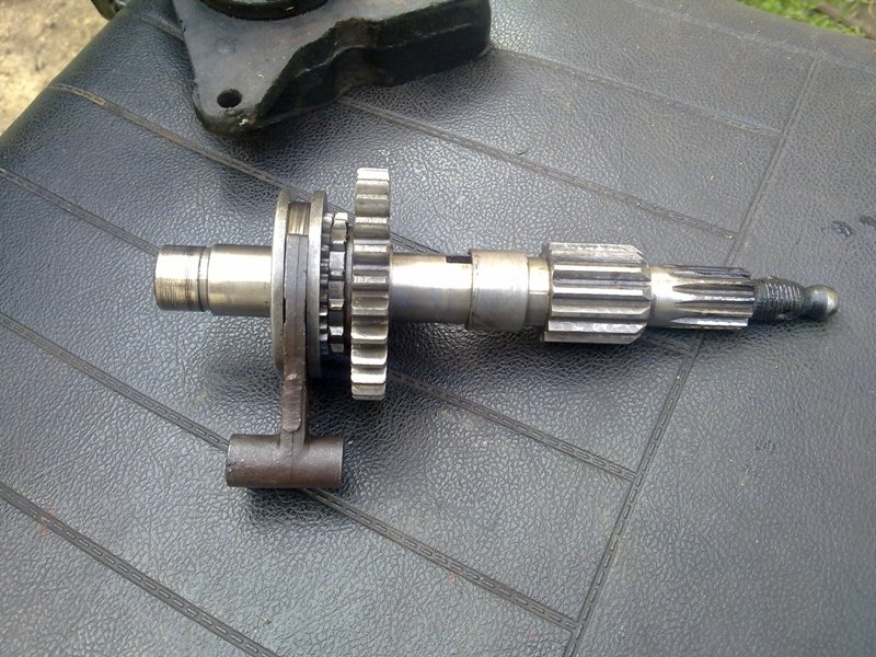

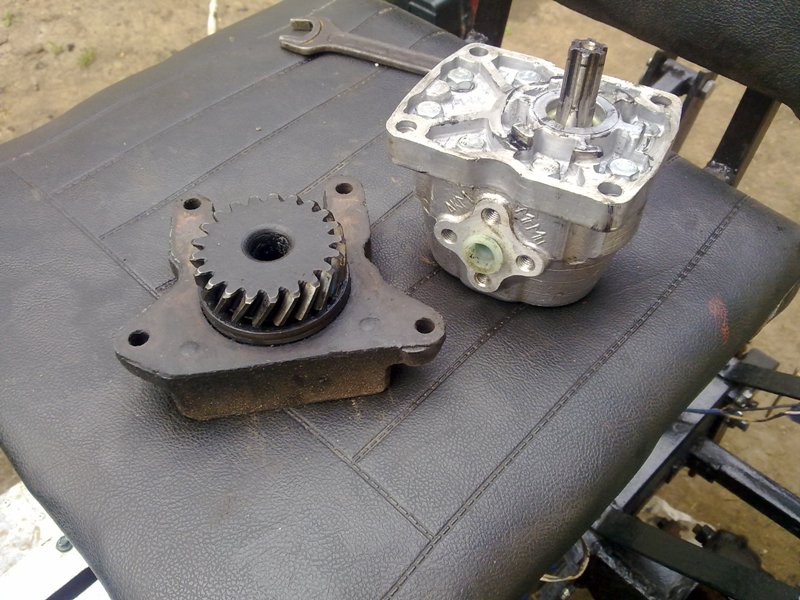

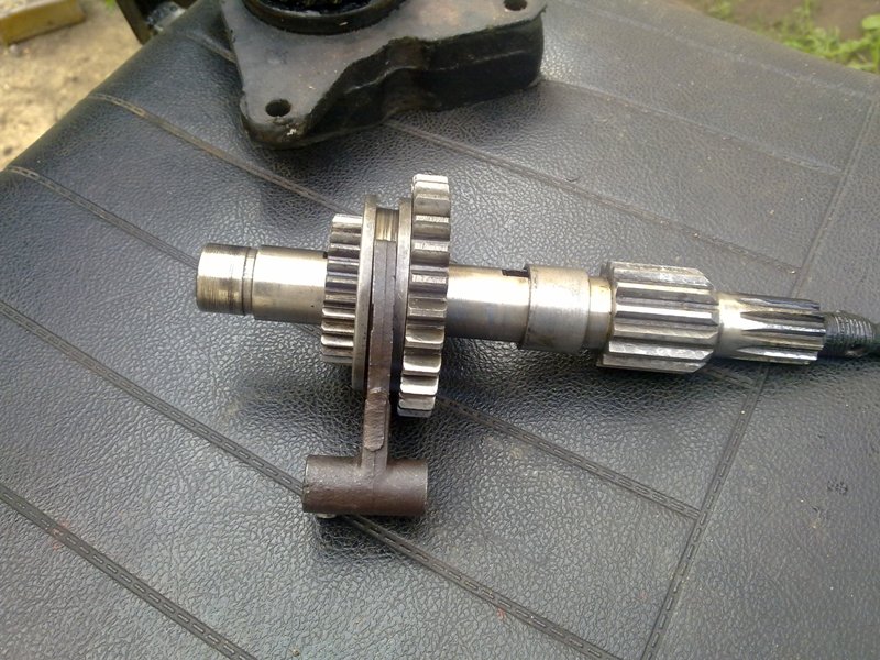

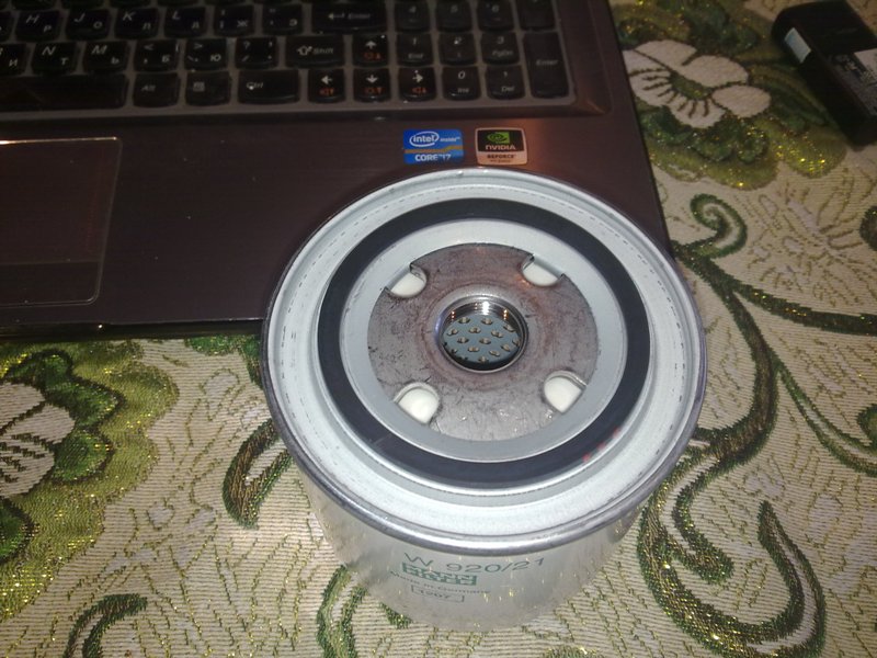

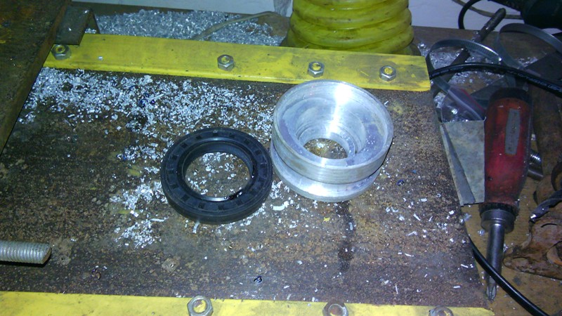

Installed on the tractor hydraulics. The pump can be switched off at will, so I used the gears of the motorcycle.
Homemade hydraulic tank 5 liters and car oil filter
Attachment 11655 Attachment 11656

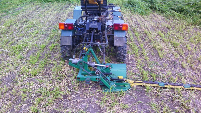

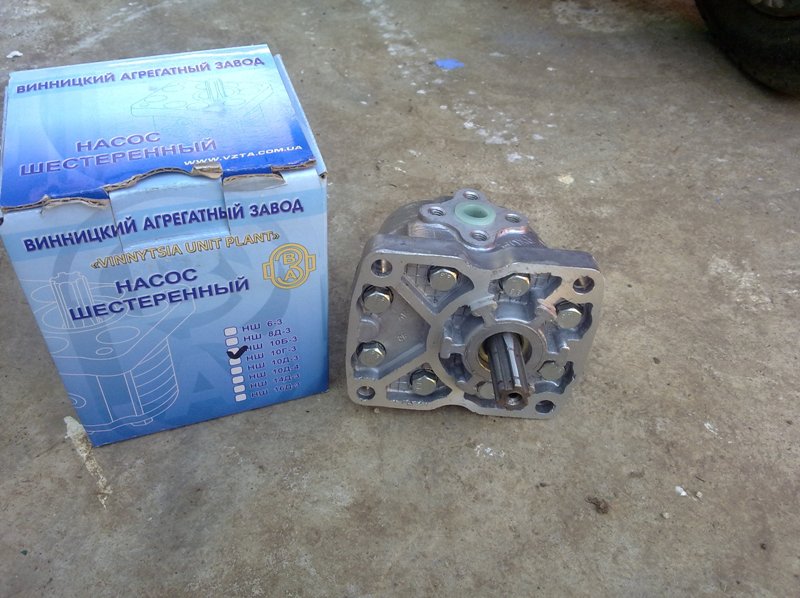

Hydraulic pump NSH-10
Attachment 11657 Attachment 11658 Attachment 11659
3 Attachment(s)
