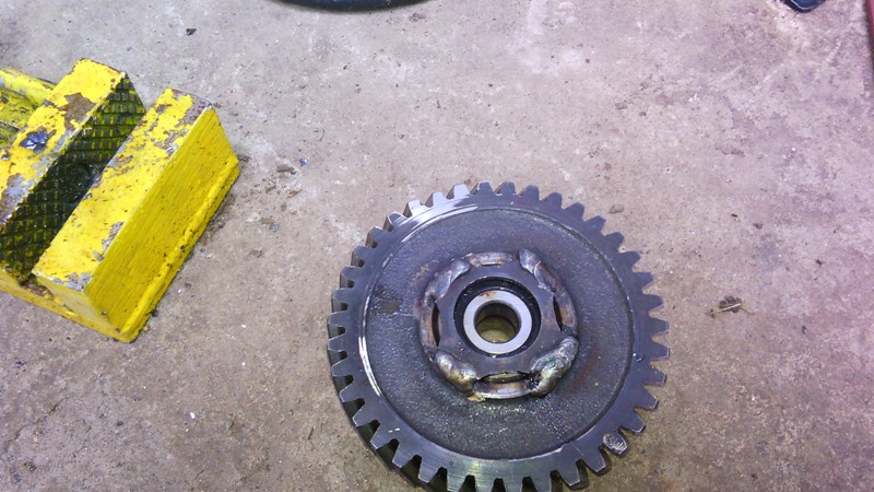

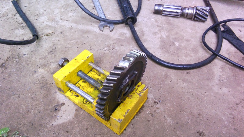

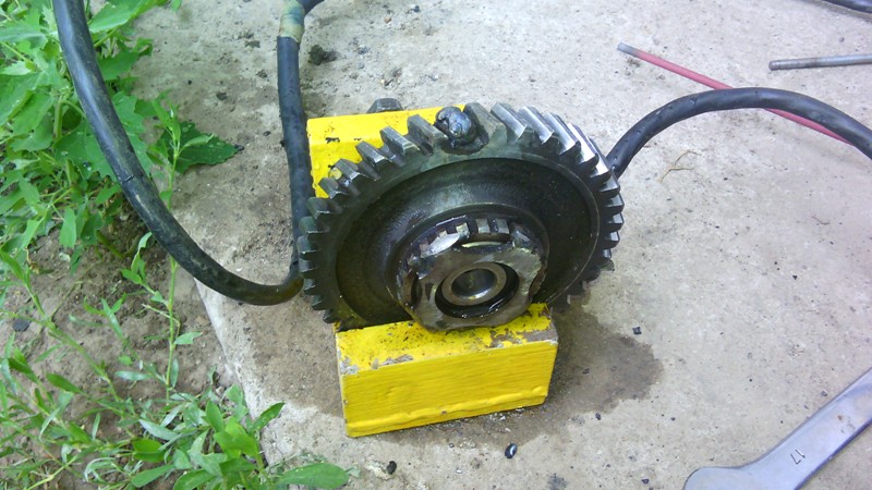

I weld a damaged tooth with an electric arc welding

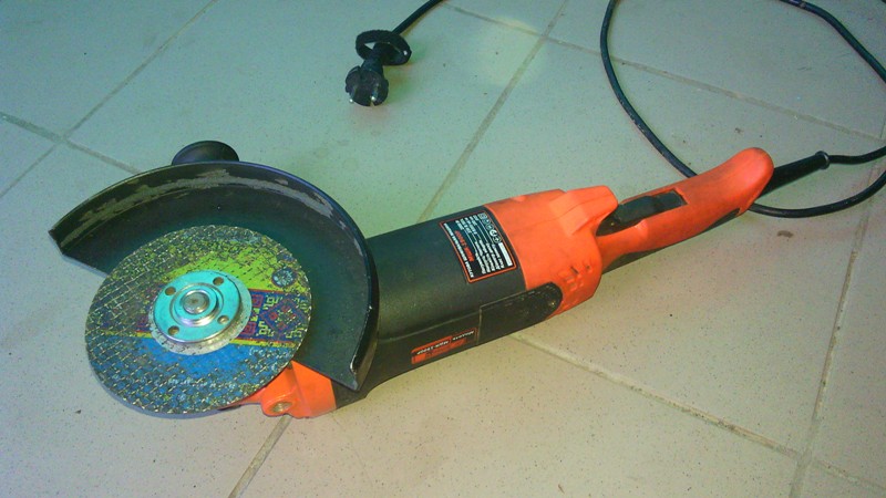

Then after 10-15 minutes of working with this tool)))

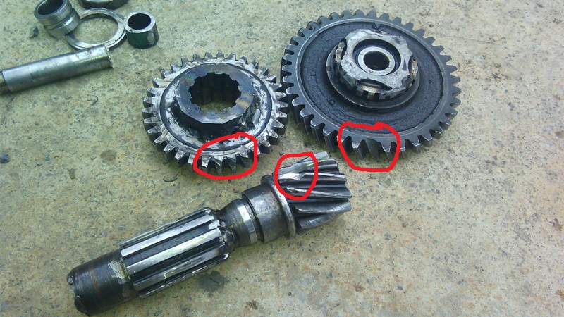

Result. The gear is almost new
Attachment 18605
Attachment 18606
