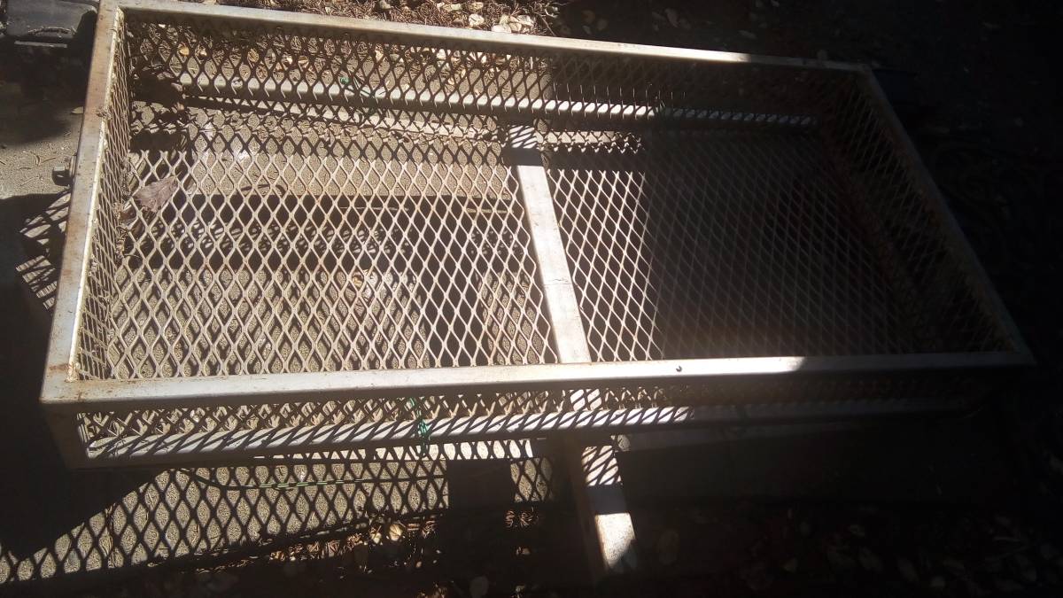

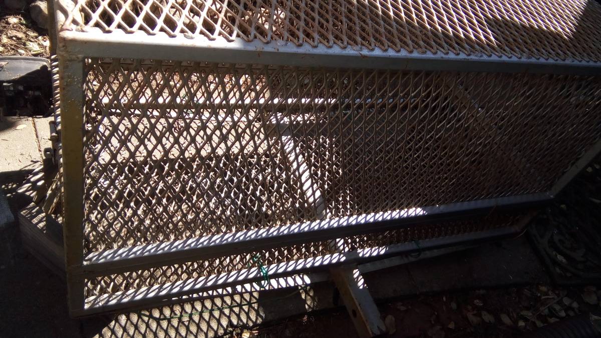

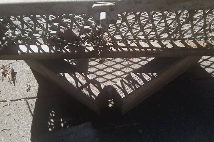

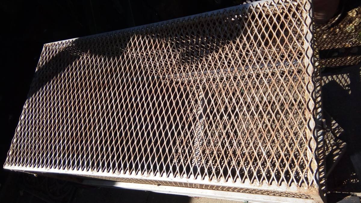

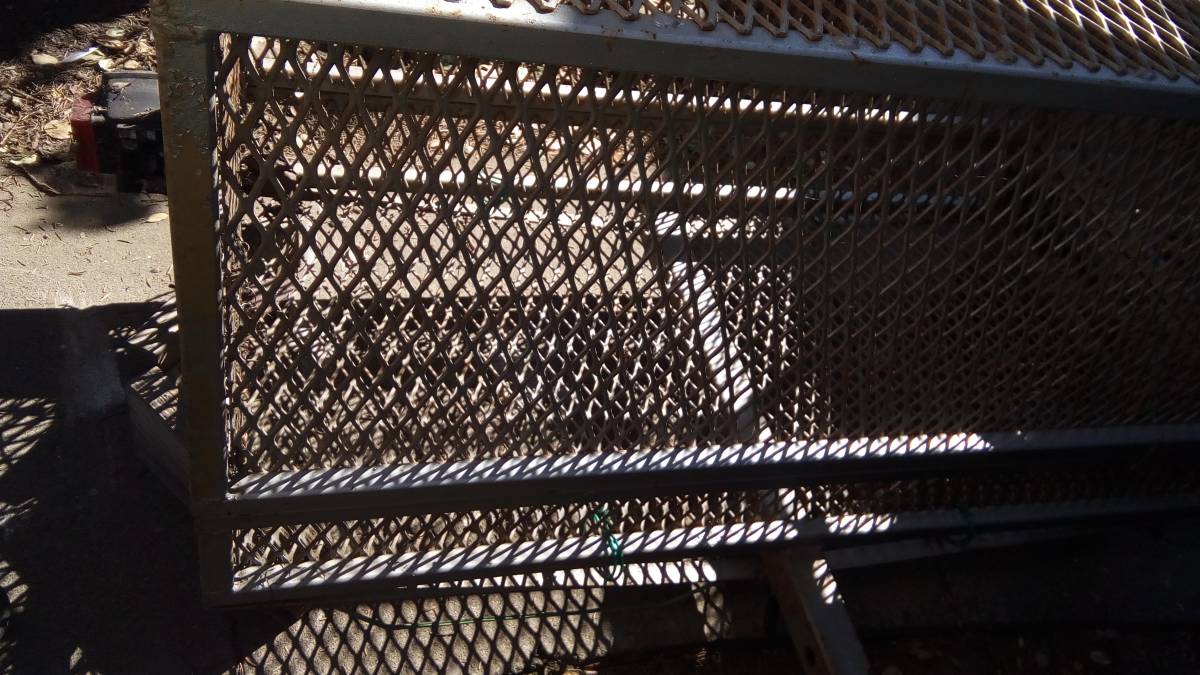

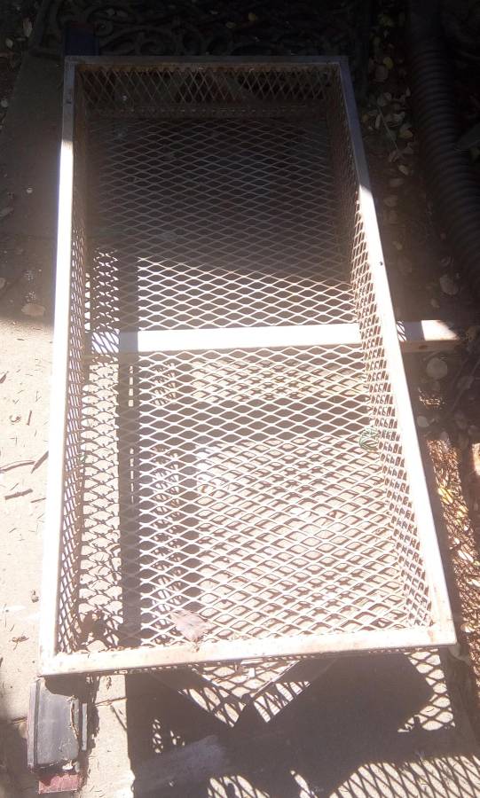

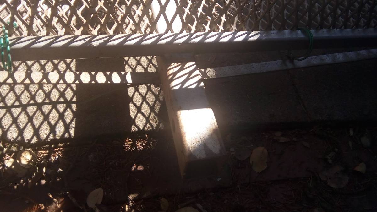

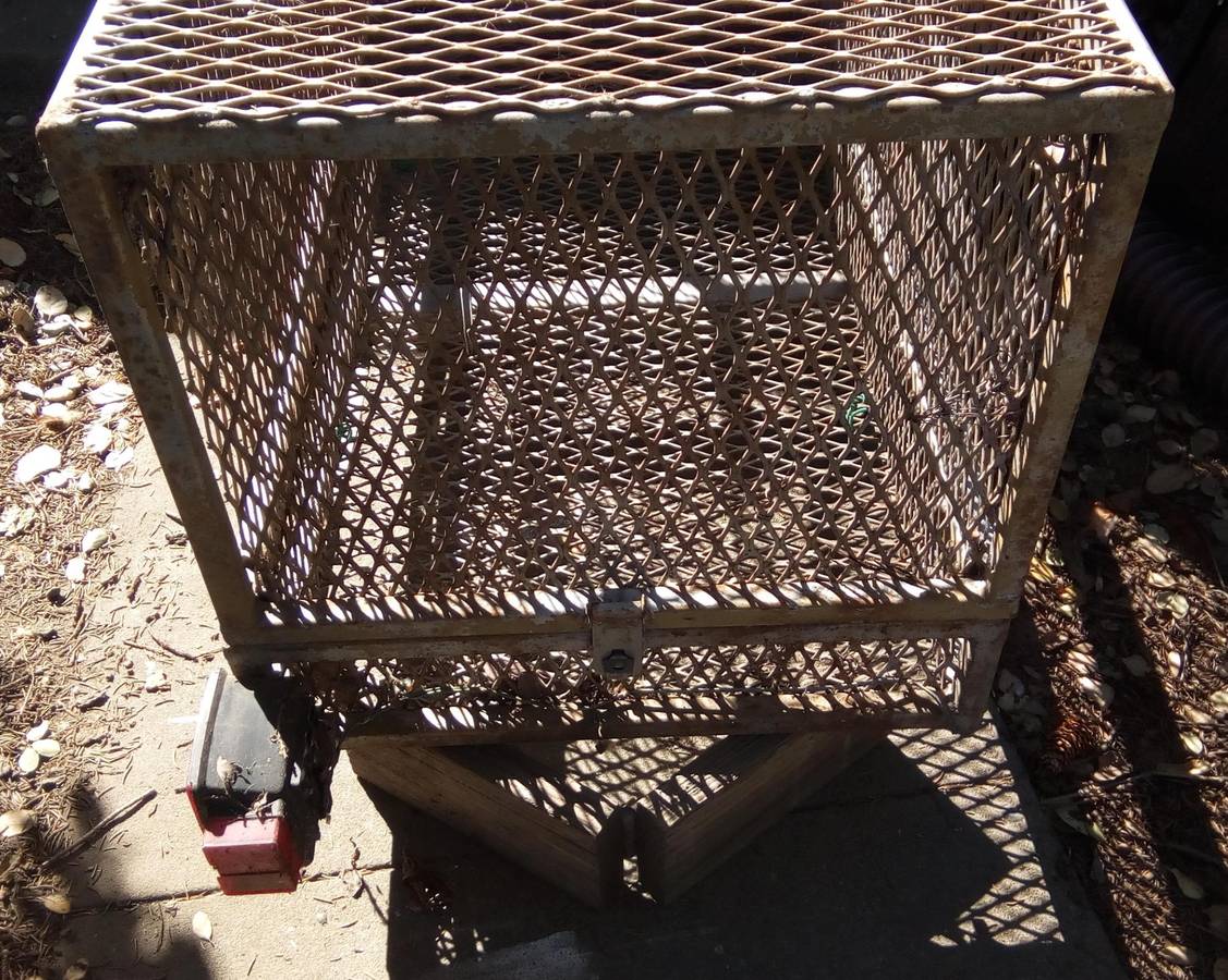

Generator Carrier

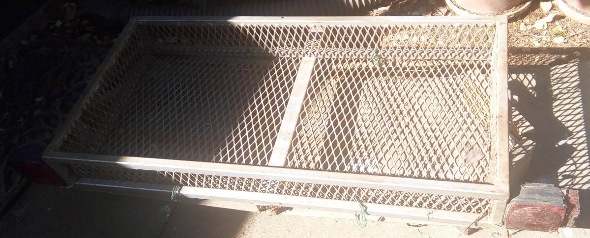

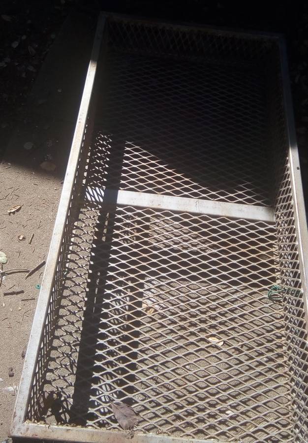

Quite some time back my wife and I built this to haul a 10kW generator, fuel, tools, etc. to remote business sites. We've also used it for other items without the generator.
We're in the SF Bay Area of California, this has been to Los Angeles, Nevada, Arizona, and around our Bay Area.

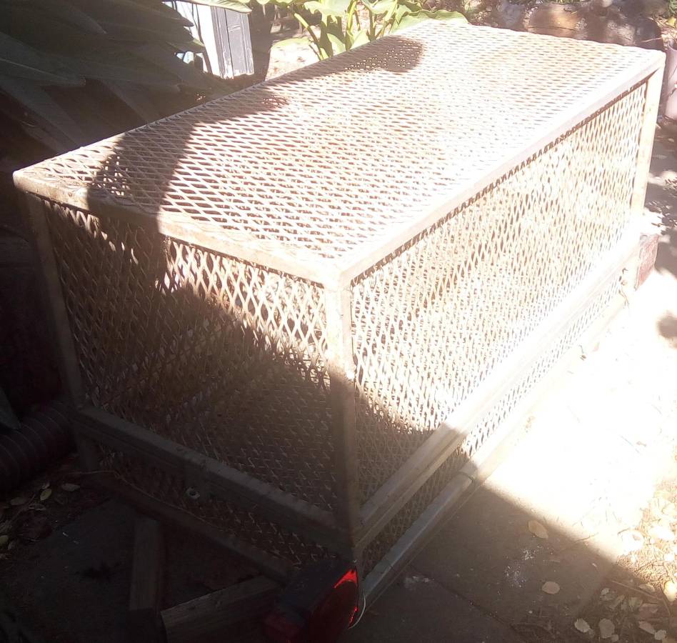

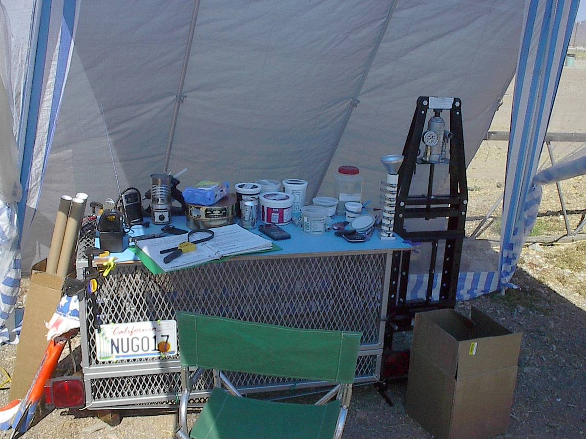

Converts into a work bench.
We're not taking it with us so I figured I'd put it up here in case it gives anyone ideas of how to build one. It's also for sale if anyone local wants it.
Size: 2 foot x 2 foot x 4 foot
Fits into: Class III hitch on SUV or truck

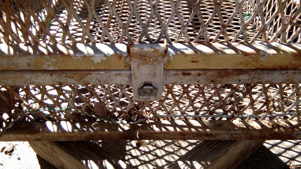

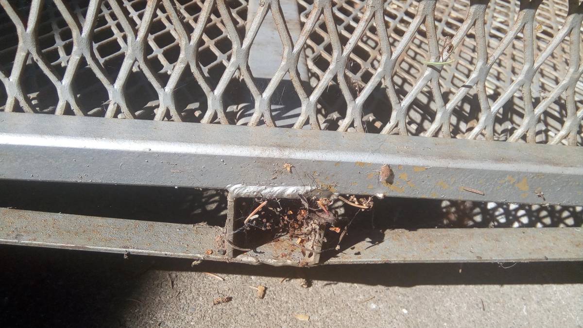

Strongly built, heavy wall tube.
Locks so your tools don't grow legs.
Can also be used to hold unruly child. ***JOKE***
Approved by California Highway Patrol, we took it to them and they said "sure, as long as the tail lights work no flag is needed".
