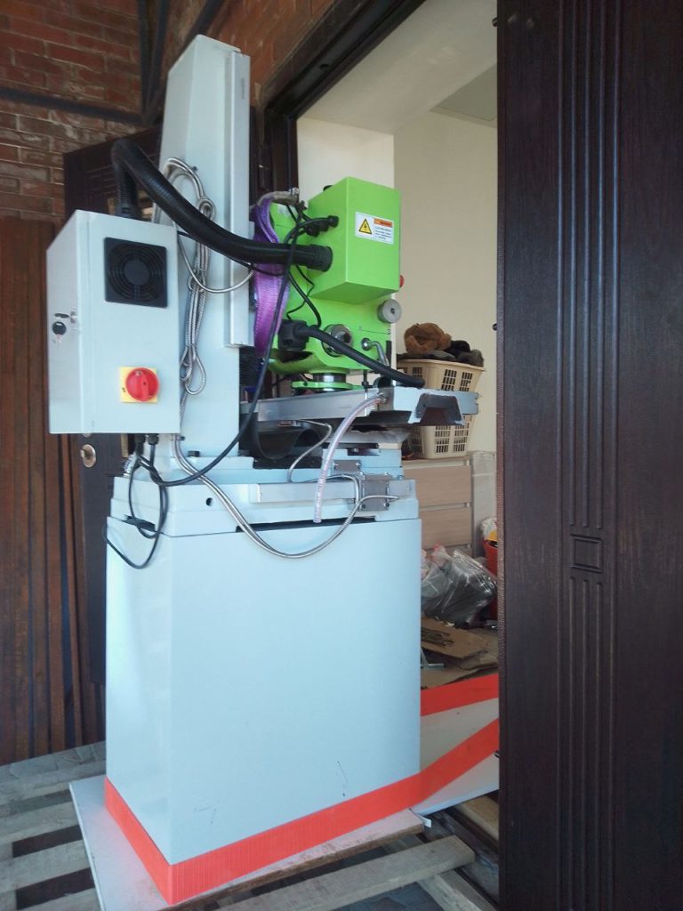

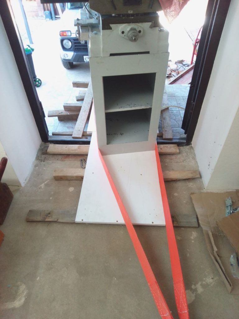

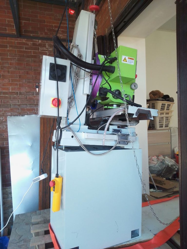

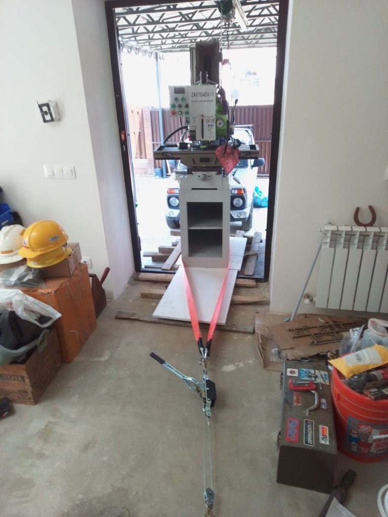

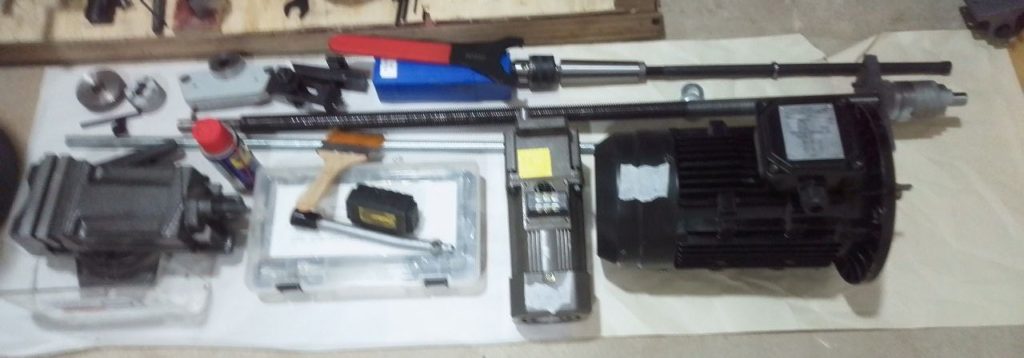

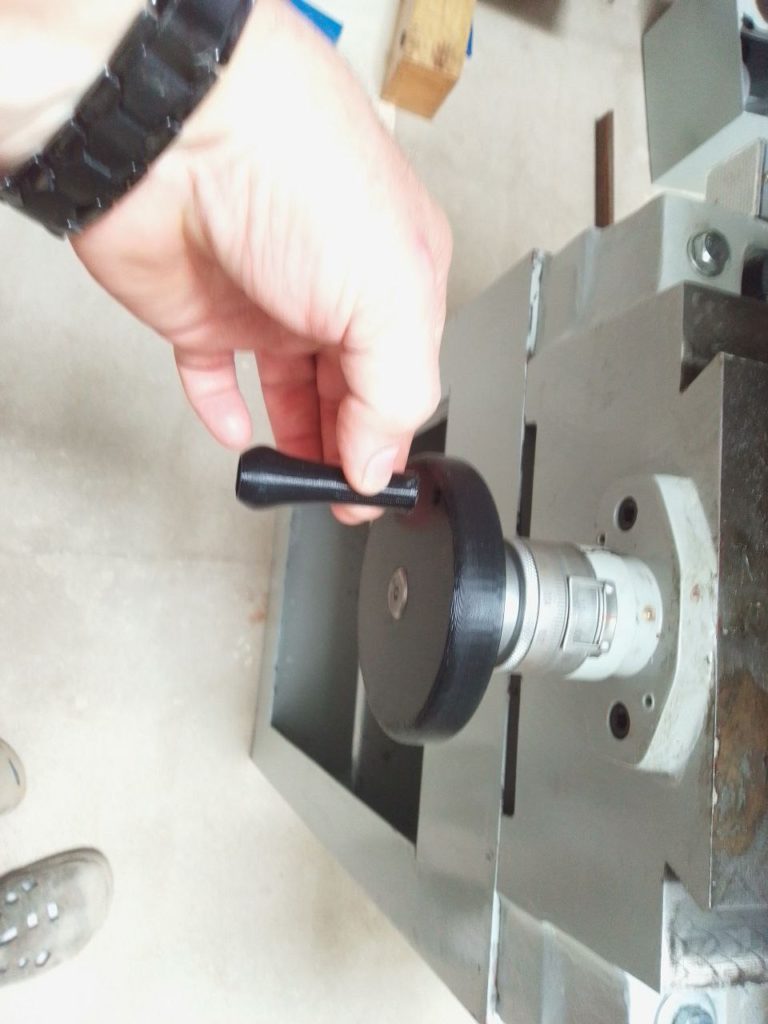

Got the second box for the milling machine with the base and a space for all the accessories they'd sent like the wheel handles, drill chuck, x-axis motor, ...
I say space because they weren't there.

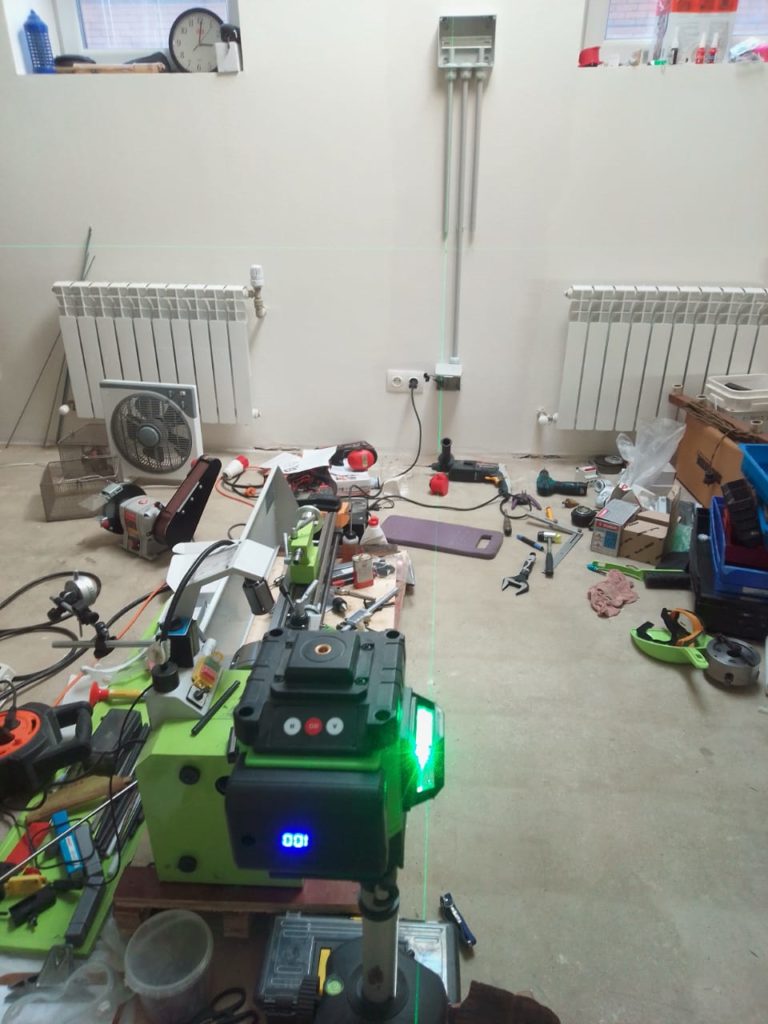

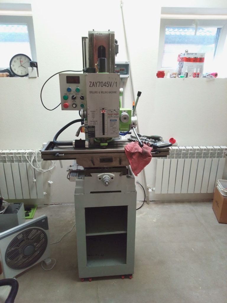

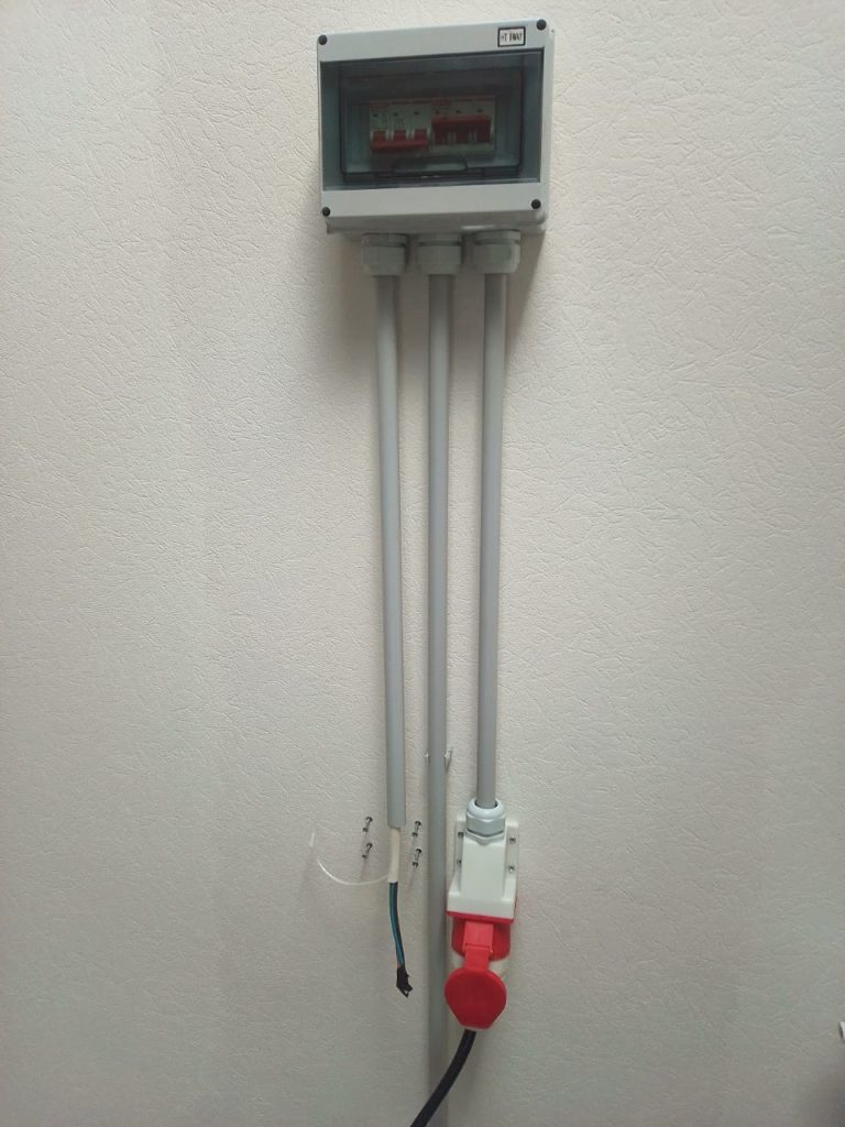

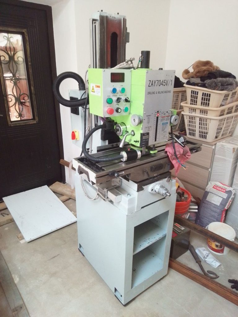

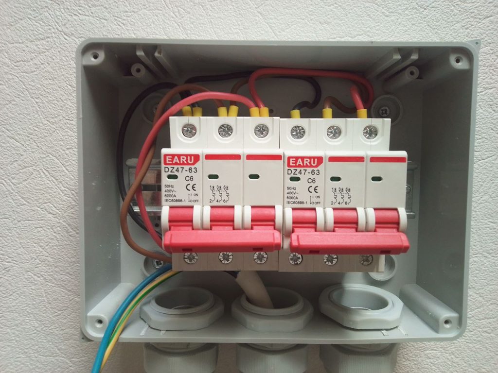

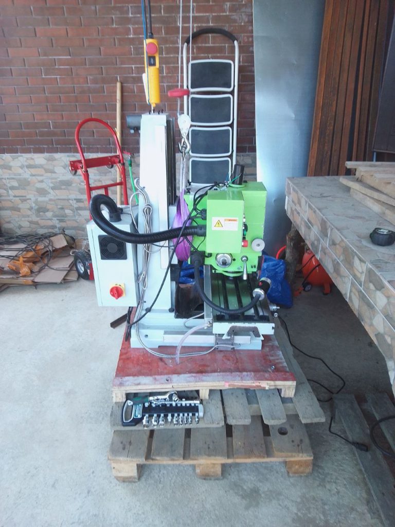

While I wait for box #3, I hooked up the mill with a long cord into the shop with the wire for the sub-panel hookup. The mill has the drill chuck adapter in it and fortunately it's the same chuck as the lathe (B16 taper) so I have a drill press! Used already, it is so nice to have a press again!

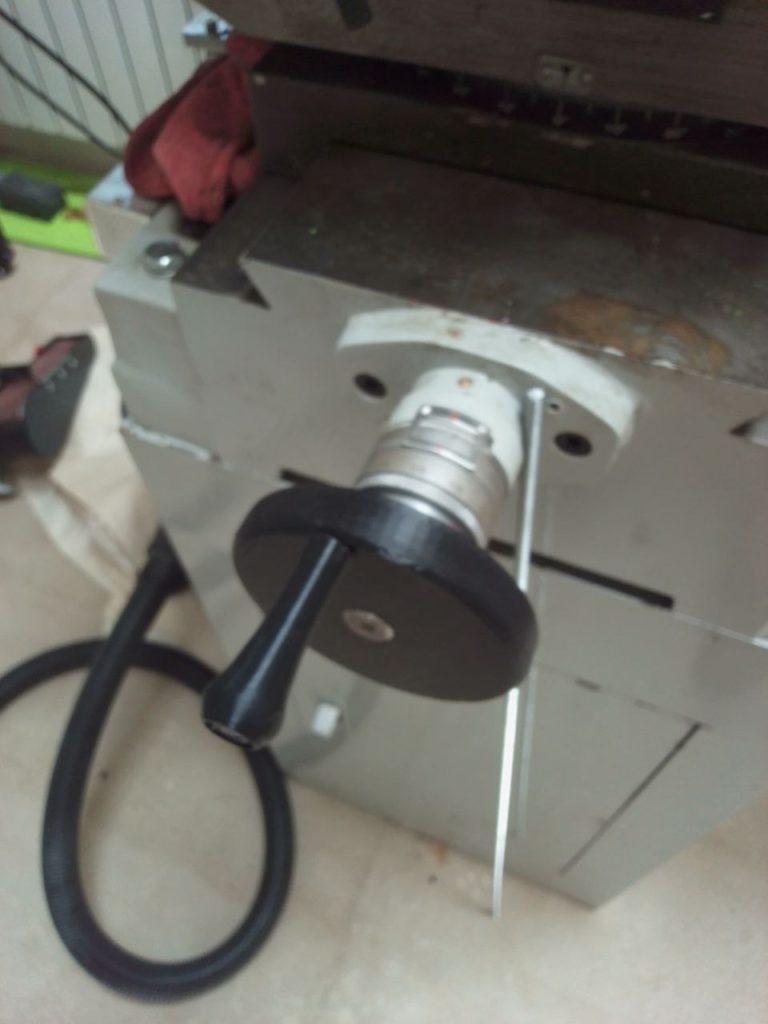

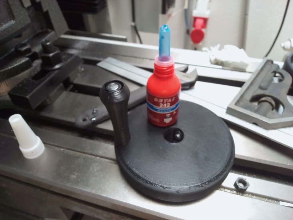

Ok, I have an ER-32 holder and set of collets so should be good to go (other than the lack of official handle-wheels).
NOT SO FAST!

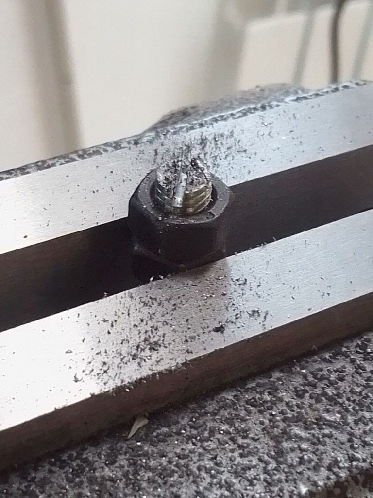

The drill chuck adapter has an M12 draw bolt but the standard MTB4 taper on the ER-32 chuck is M16. So, yesterday I picked up a length of M16 all thread and nuts. We've had to go to Krasnodar a couple of times and have to go buy some wall paint today, but soon I will have the mill milling.
Ok, I did do some milling using the drill chuck, don't tell anyone!
I'm not used to how fast the mill stops, that variable speed drive works great. With the auto tapping mode, it does a Z feed automatically (dial to set the speed) until it hits the end stop you've set. Then cleanly stops and reverses and backs out until it's all the way up or you hit stop. I have a tapping chuck on order, this will be nice. I can also set it to a very low RPM which reduces my nervous condition when power tapping. I could also see this is a series of holes needs to be drilled. Hit go, and watch it do all the work. Not CNC but hey, not bad.
Oh, they apparently grabbed the DRO from their lathe stock, it was set to lathe mode when it got here. Had me a mite confused until I changed the setting to mill.
