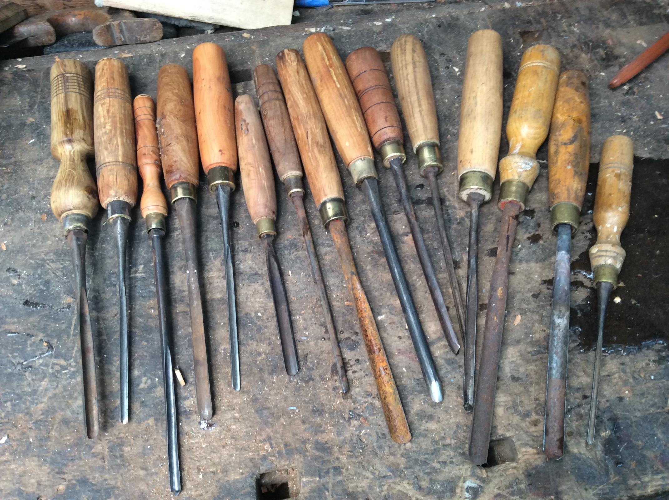

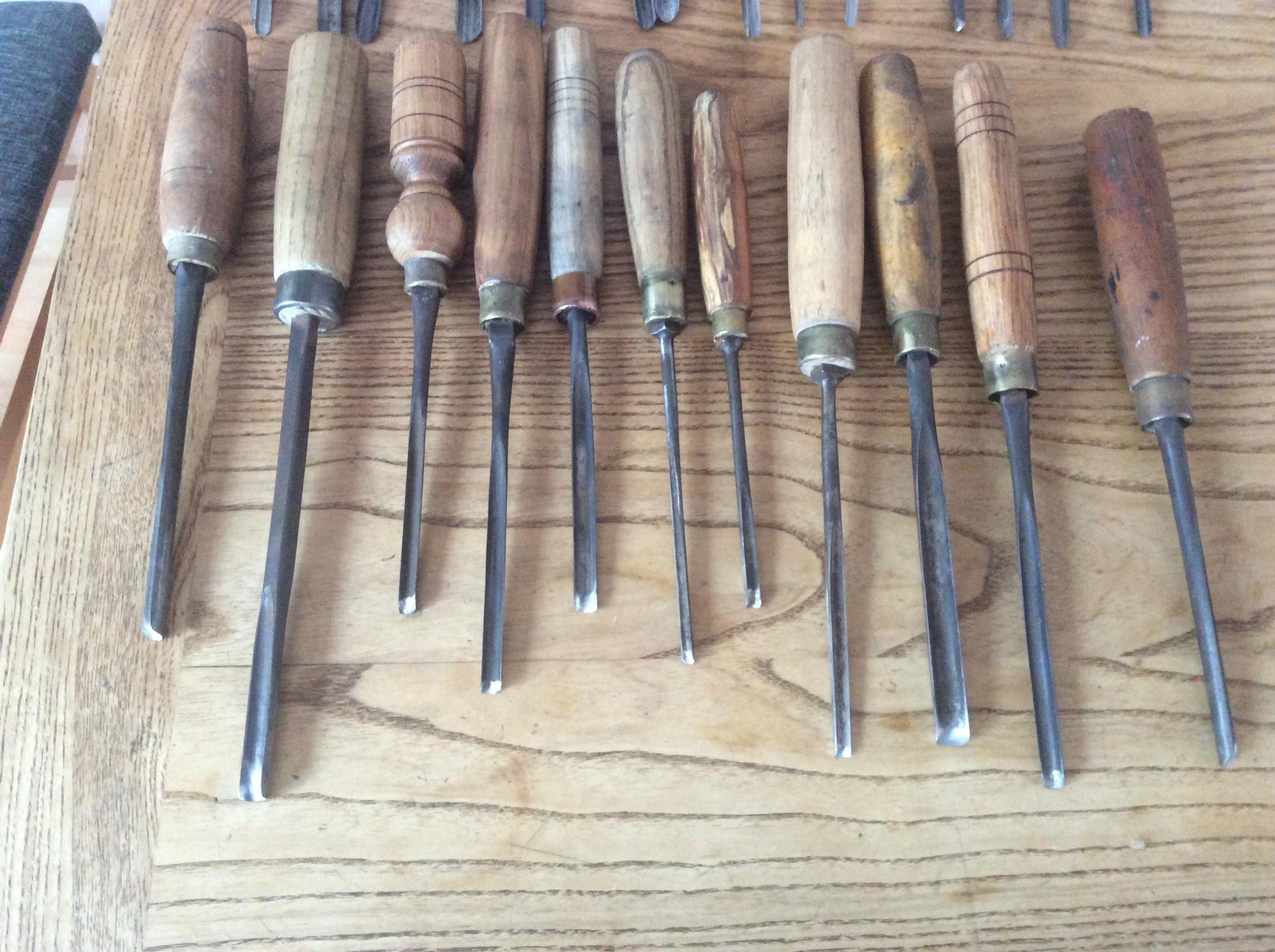

Here are some gouges I have made recently from spoon bits, shell bits, etc. The handles are homemade (with one or two exceptions)
These type of bits were a cheaper alternative to auger bits, but they are not very good, I think.

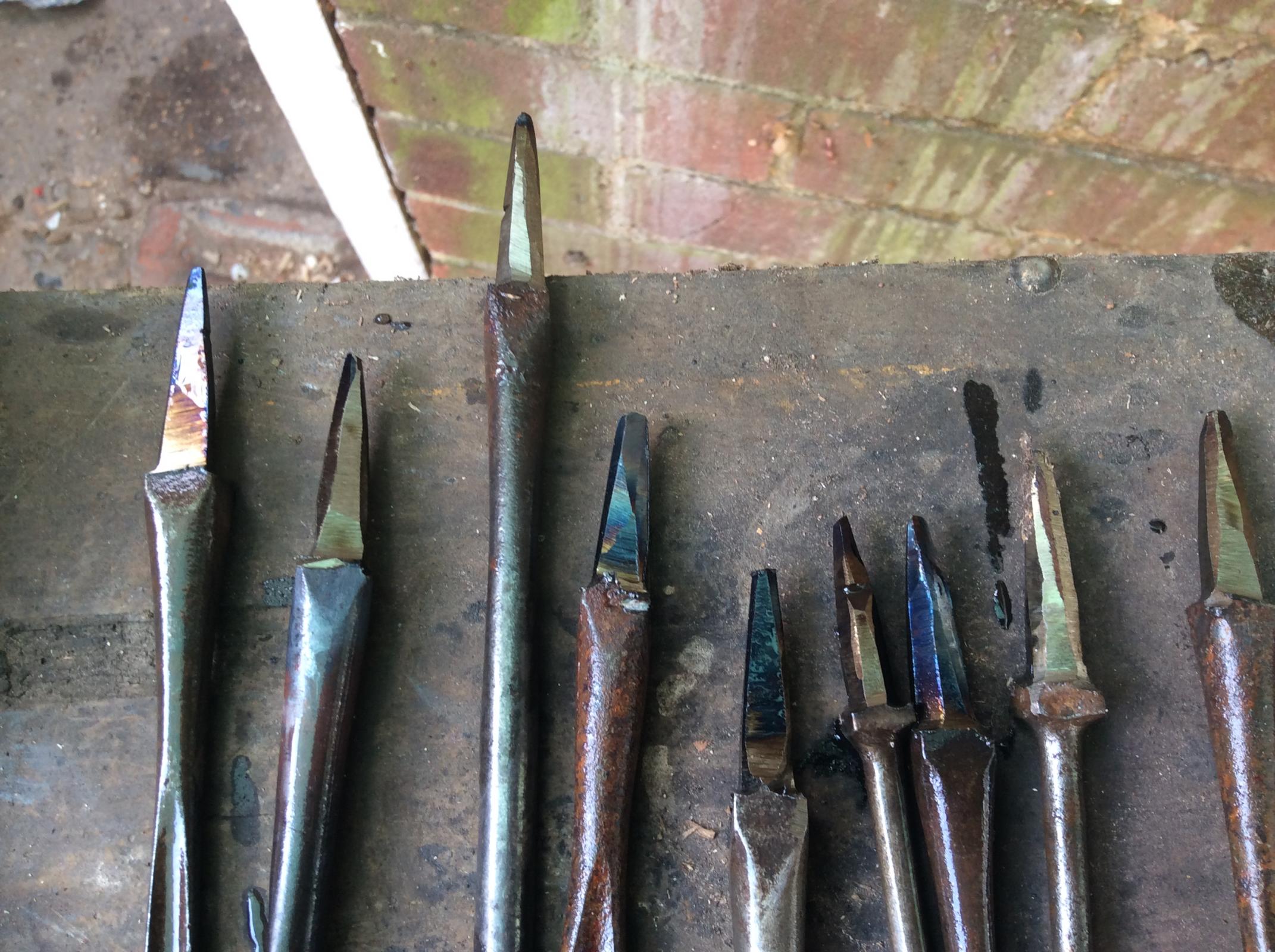

Attachment 30499
Here are a few I have salvaged, before treatment. There is a third type, which has a lip or hook at the tip. I just ground off the lip, and sharpened them in-channel.
At first I thought I would reforge the tangs, and I did do some like that, but without a specific swage, it was difficult to form a bolster, so in fact it turned out more efficient to grind the tangs back (efficient, but not very pleasant)

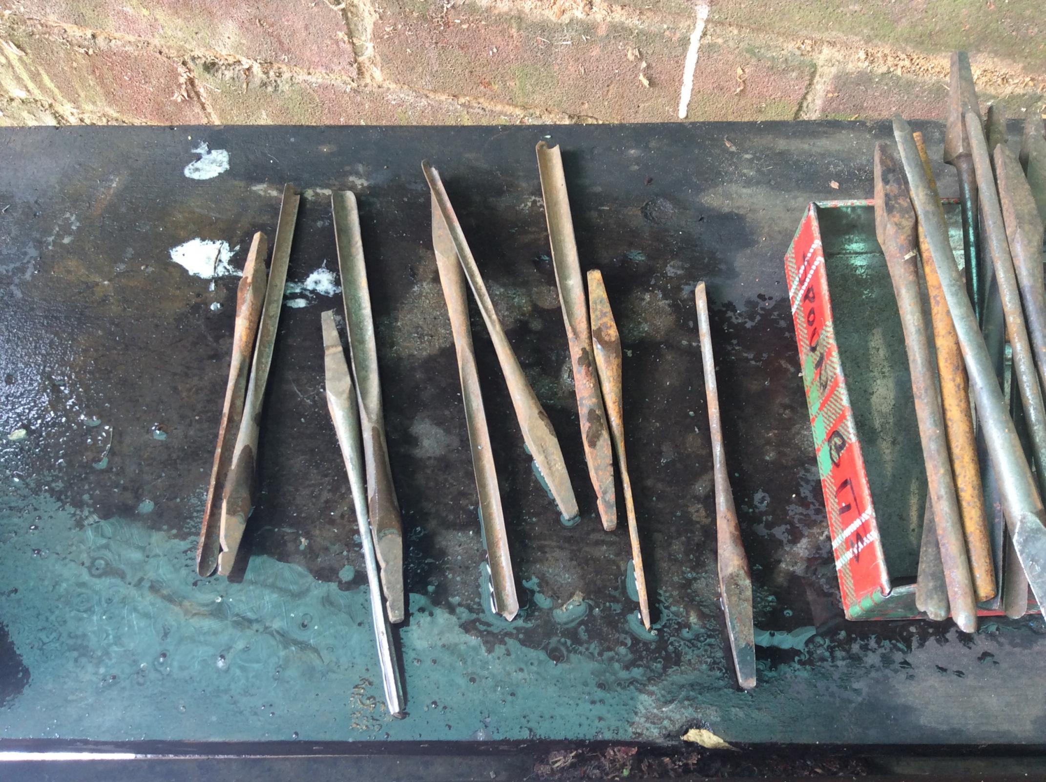

Attachment 30500
Of course, I could have just inserted them as they were into handles, but then the handles would have to be large, and therefore disproportionate.

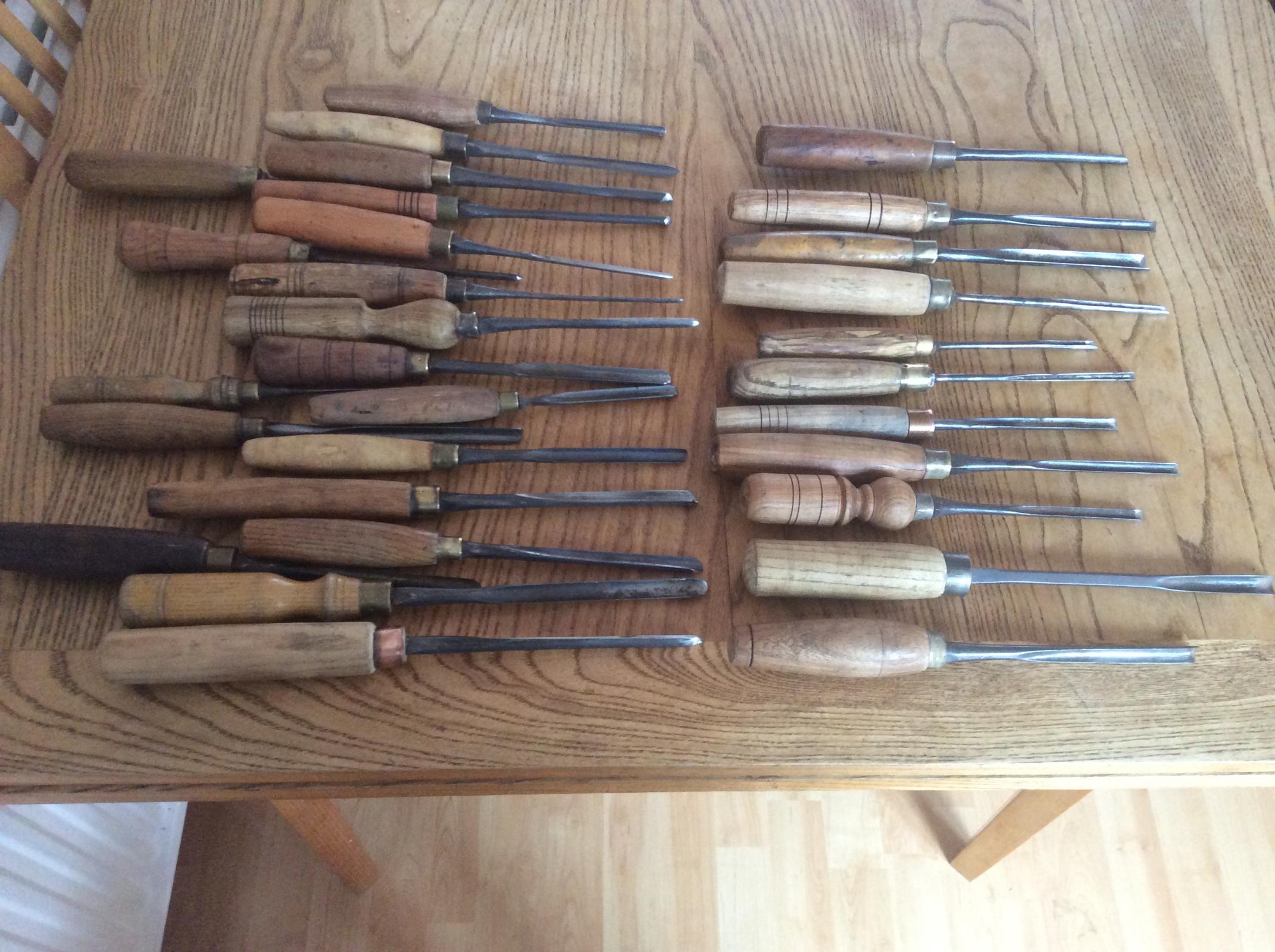

Attachment 30501
Here are some before buffing and sharpening.
I prefer to ream the handles out using tapered drills (easily ground on the bench grinder if rotating them in a drill) Then I usually square the holes with a chisel, before selecting an old file or other tanged tool which has the approximate taper. This I heat, with a blow torch, a push it into the handle, until the seating is a tight fit on the gouge tang. I think that this is better than heating the tang of the tool itself, particularly if you want to replace a broken handle on a good chisel.
I made quite a few, but I shan’t keep more than 6.
