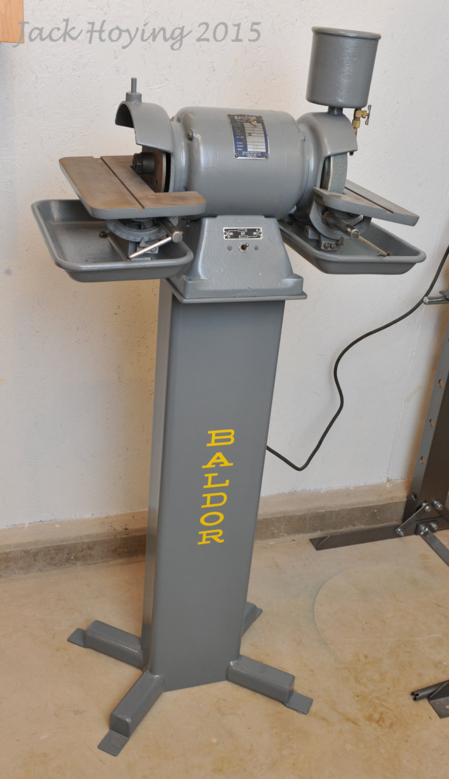

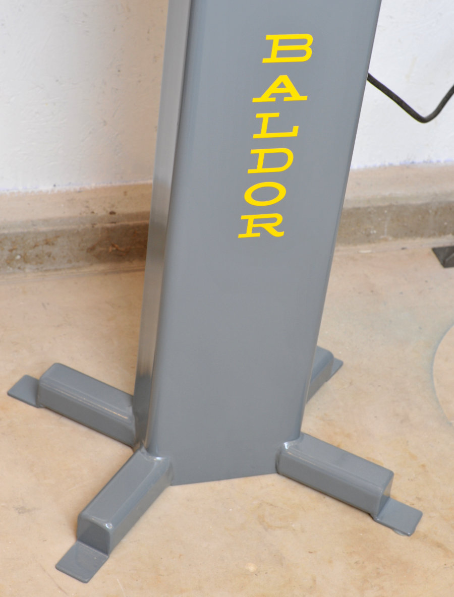

Not really a tool, but a tool accessory. I refurbished a Baldor 500 grinder and needed a stand for it. On my scrap pile was 36" x 8" x 4", 1/4" wall box tube. I also had some 2", 1/4" wall box for the "legs". I capped the ends with 2" angle iron, which were welded on so they would be 1/8" below the rest of the stand. A 1/4" plate was welded to the top for the grinder mount. After paint, I had some vinyl lettering made to finish it off. It's quite heavy, and rock solid.

Wow, must be nice to have such a varied scrap pile! :thumbsup:
nice job .. Lovely set ...
:hattip:
Jack,
The grinder stand looks great and better built than anything we can buy. I voting this is a great touch to the overall design.
Paul
Solid job, solid stand. Should last a lifetime.
Al
Thats a work of grinder art! I would be proud to own one like that!
